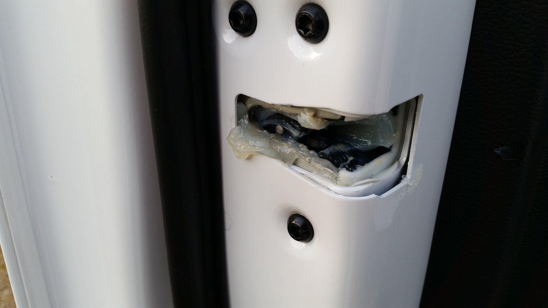

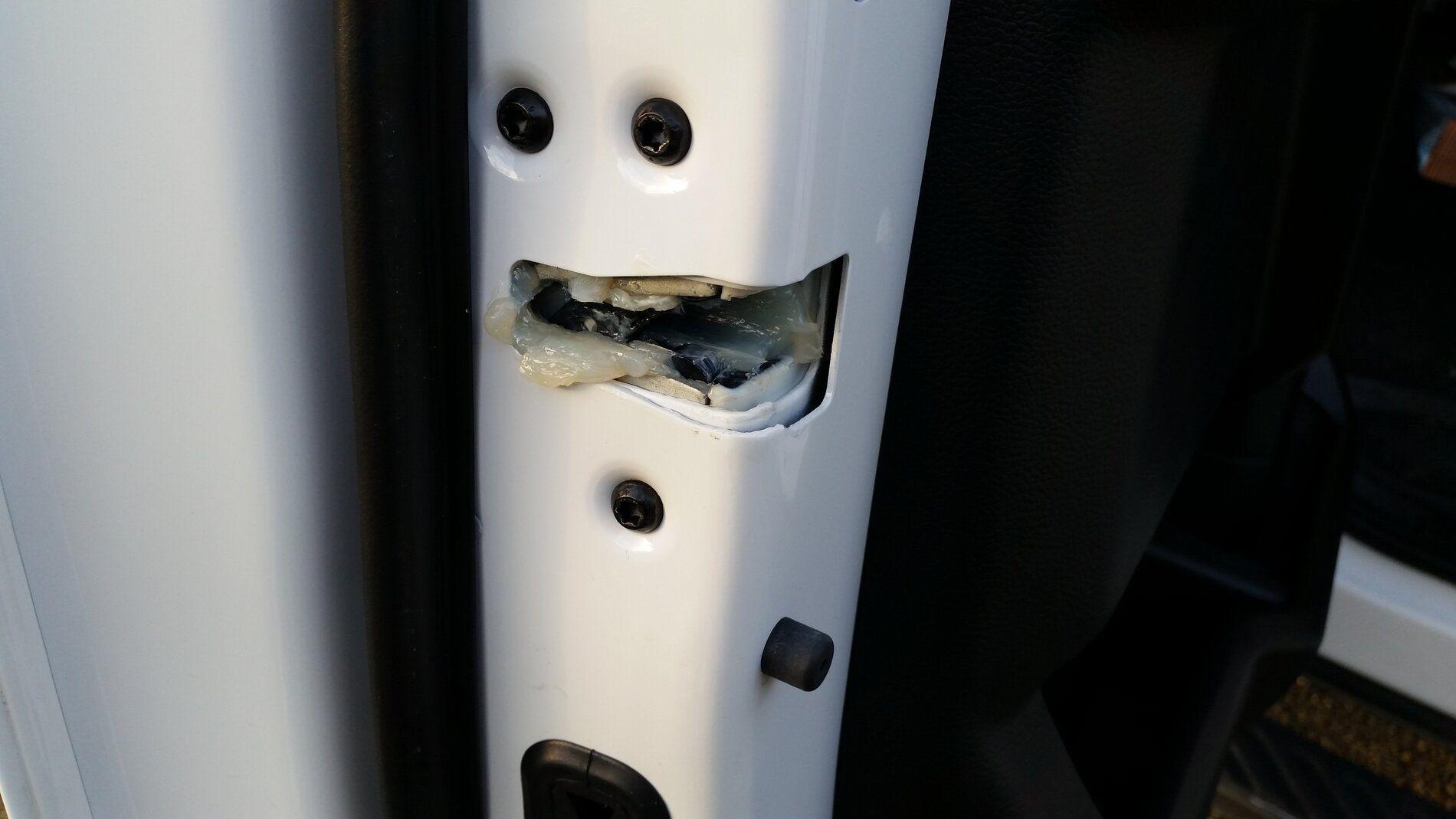

Truck is finally clean enough for me to get a picture of Ford's "fix"
Front door
Back door
Looks like they just greased the heck out of those latches and added that white seal on the outside. I don't have a picture of the last seal, but I believe it was black.
Back in the 90s the infamous Ford “door ajar” light issue was sticky switches. A Ford SSM “fix” was to clean the latches, replace the switches, and lube with that same grease.
It actually sort of worked for awhile.
