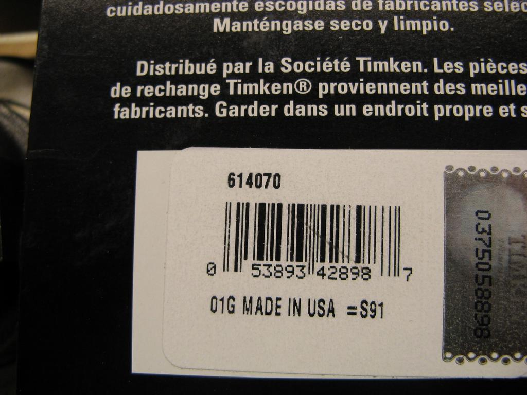

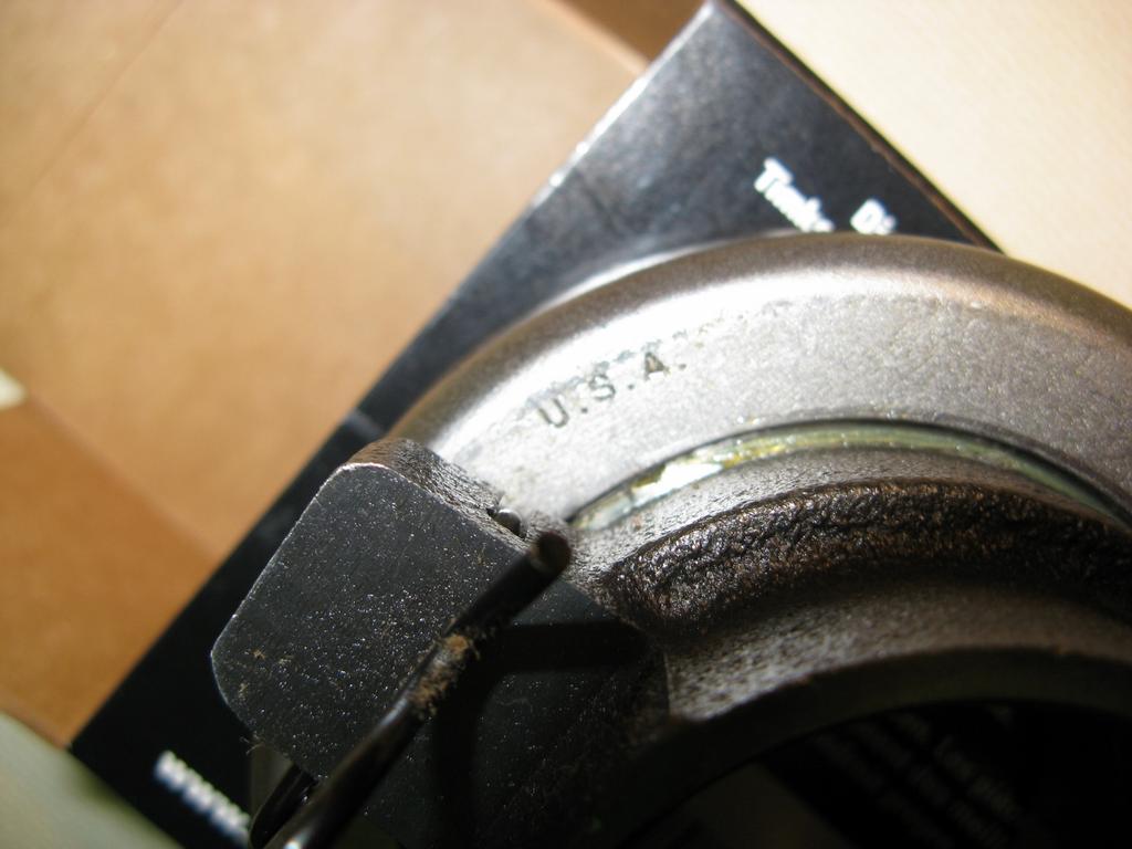

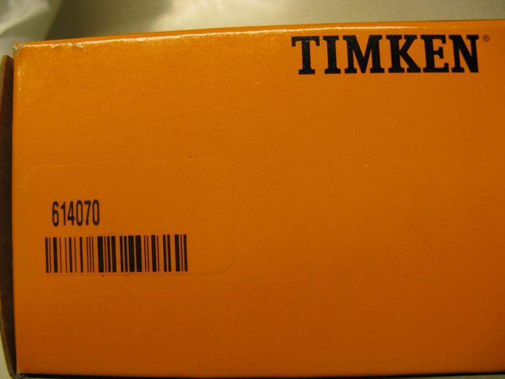

I received the TIMKEN throw out bearing yesterday. It IS made in the USA. It was shipped direct from TIMKEN in Tennessee.

That is a good find.....nice. I know positively that when I was looking for a throwout bearing Timken was my first choice but no place could find them made in USA. Maybe they started manufacturing here again. :confused:
Can you take a picture of the bearing and its face too? I'm curious to see if it looks more like the OEM version of the SKF version. :)
Well just got off the phone with the senior project engineer at Aetna. They make a couple of the components for the bearing state side and have the rest done over seas. The good part is that it is assembled in the USA so I am working up a deal with them right now. Hopefully shortly you will see these bearings in our kits.*
