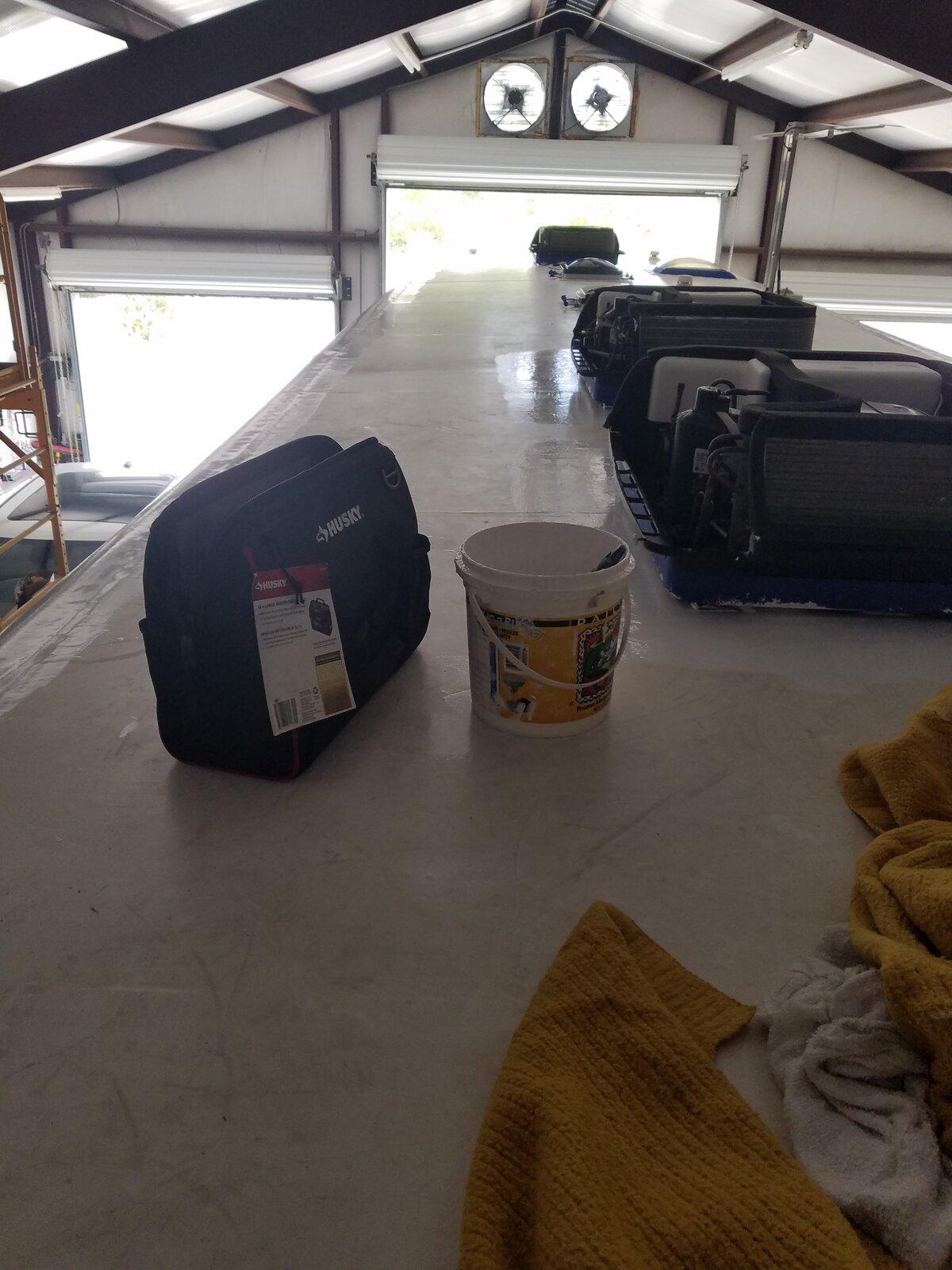

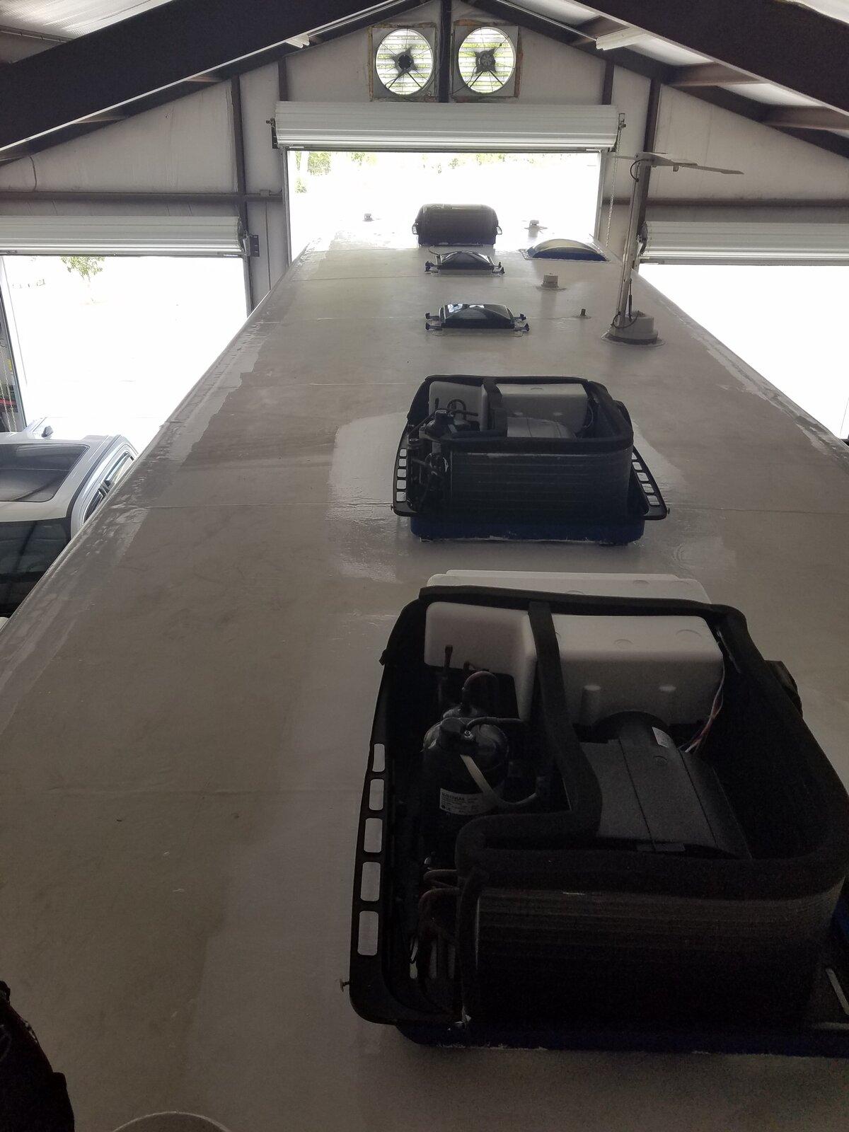

I finished the FIRST coat of all the cut in work today, cut in first coat front and rear caps (1 hr), applied the second cut in coat around the three A/C units (1hr), first coat (Crazy Patch and Crazy Seal) on antenna base, two fantastic fans, and plumbing vents (2 hrs). Everything besides the A/C units that penetrates (screwed into) the roof requires a coat of Crazy Patch (more silicon and thicker) over screws and bases, then cover and blend while still wet. I'm laying down or sitting on my tail doing this. When I paint second coat on sides of roof, this time I'm doing it from the scaffolding so I can blend the runs I made doing it from topside AND coat it such that 2nd coat does NOT run.
Sorry, I didn't get pics as I was racing the clock today and was really whooped when done. Spent 4 hrs up top and 1 hr for prep/mixing/cleanup (stuff take 10 minutes to stir per product), pouring into smaller buckets, moving myself around getting into position, and cleaning when done. Yes I have power mixers I could use, but I mix this stuff folding it from the bottom to the top. BTW, all the Crazy products, brushes, tape and tools are up top. I only clean the buckets and brushes on the ground, then bring them up with me when starting another day. I hoist materials up with hook and rope.
