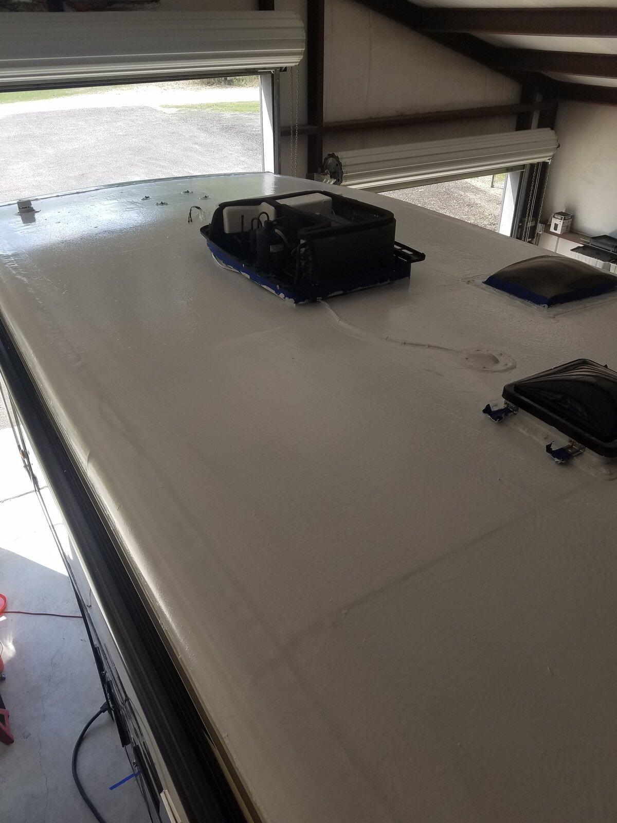

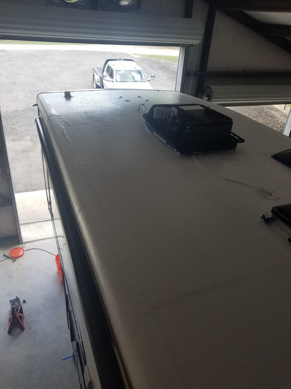

I cut into sides and components on the roof today for second coat and I also rolled first coat on the rest of RV. I'll roll second (final) coat tomorrow.
See pics:
So far, i rate the project 4 stars out of 5. I'm doing this almost out of my physical ability and have stretched it out too long. I say this because the Crazy seal is starting to slightly clump. I interpret this as it started curing as soon as I opened the material. I opened both the five gallon and three gallon buckets to make sure material was good, not thinking exposing it to air started the curing process. I believe the amount of time this SHOULD take is 3 to 4 days and I've taken about 11 days, so I don't slight the manufacturer. I forced myself today to roll the first coat and roll second coat tomorrow because material is starting to degrade.
I'll post final pics when I apply 2nd coat tomorrow and in a few days letting max curing and drying before mounting AC covers, TV and satellite antennas, and fantastic fan covers next week.
Having pain meds and going to margaritaville now.
Cheers, Ron

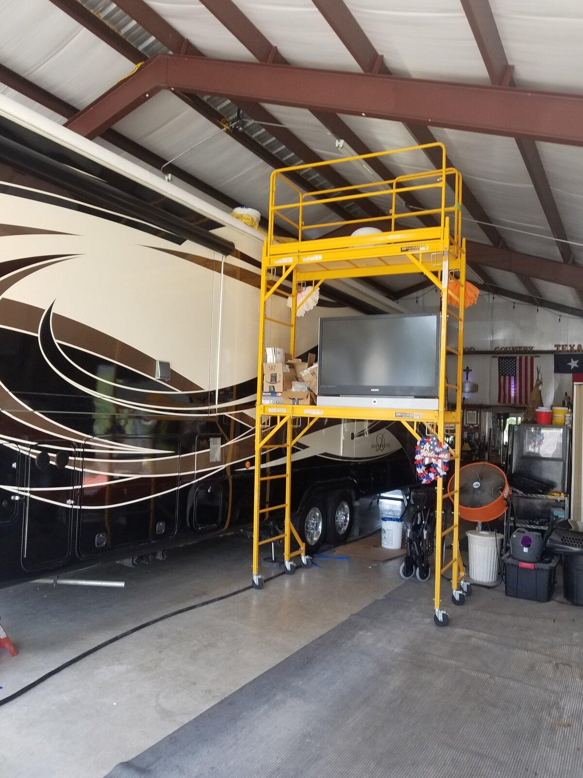

One more thing for any considering this or any other coating for thier RV roof: Although not required I've found having tall scaffolding makes doing this a little easier access on and off the roof and for access to materials.
Just something I've neglected to mention. I use rope to hoist materials tools up.

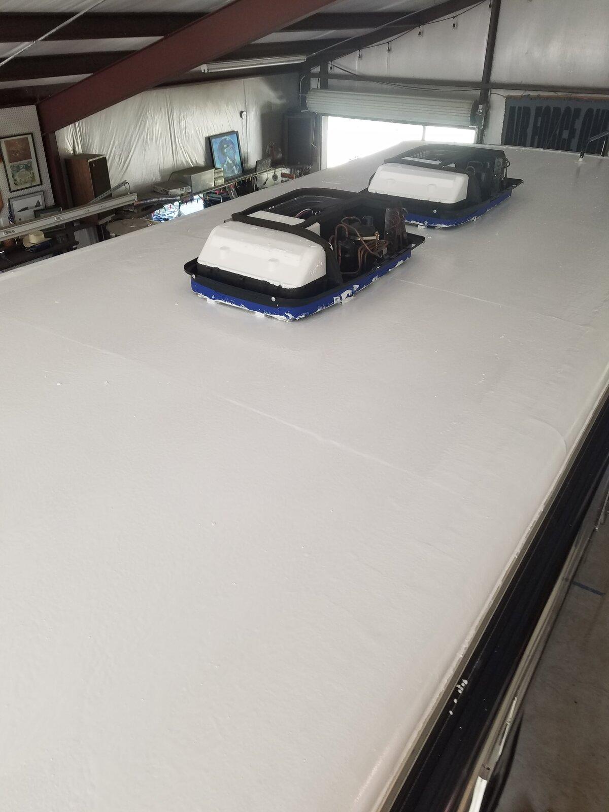

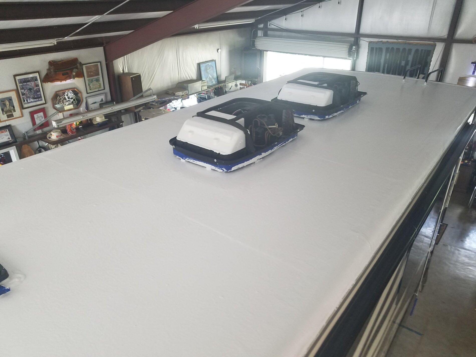

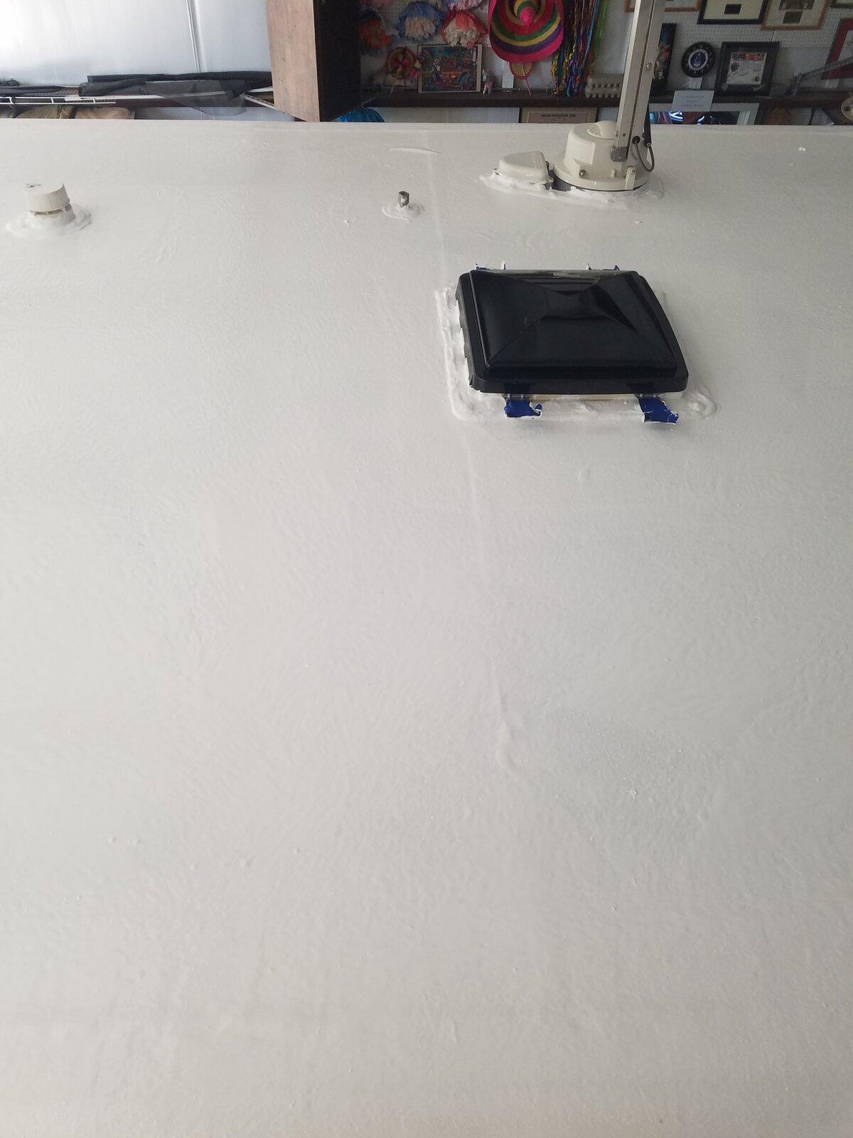

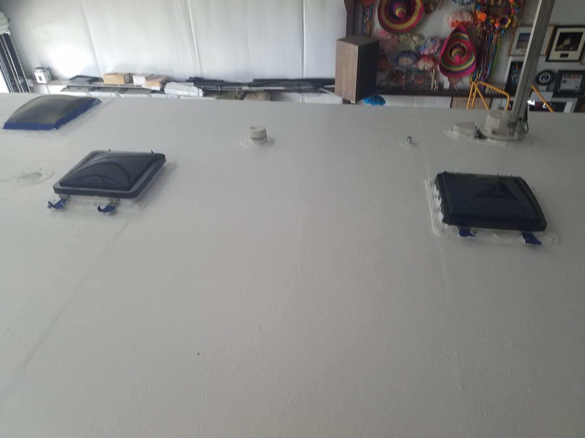

I applied third coat to sides, which perttied them up. I purchased enough material to cover the roof and sides of a 40' x 8' 4" wide roof, which the RV is 39' 11", but the end caps are about 2' long.
Anyhoo, I dumped 3/4 gallon of Crazy Patch into 2.5 gallons of Crazy Seal, giving me over 3 gallons of material. I used a fluffy roller and rolled out a slight orange peel finish, which might have a slightly less slippery surface when wet. Honestly, unless the roof was completely dry. I would crawl on it if I had to get on top.
I just have to say having a 3/16" thick roof already displays increased strength and rigidity when walking on two dried coats. It doesn't give slightly anymore when walking on it. I can attest to the adhesion of it, as some dripped onto the waxed automotive paint on the side of the RV. I scraped with plastic razor blade, it stubbornly removed the silicon with much effort, but still outline of adhesion, like when you remove a snail from a wall. I got some WD40, no luck, got some mineral spirits that removed most of it but if you look up close you can still slightly see it. So it has great adhesion, which is testiment to how well it works on stripped (roof protective treatment), cleaned (pressure washed) roof.

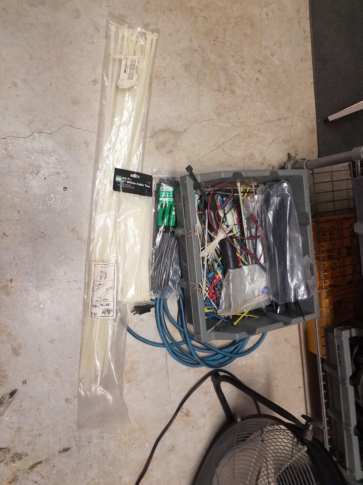

I am not a chemist/scientist and only going by what I saw in the above ground mining industry. We always used black wire ties for cords etc.. One time we tried whites and found they disintegrated in a Month. Needless to say we went back to the black.
Copy Dave. If exposed to sunlight, I prefer to use metal ties, but actual industrial nylon cable ties will work, i have both black and nylon opaque, not really white. We used to lace cables when I was a communications tech long ago.
Cheers, Ron
How bout RED fire rated cable ties for plenum ceilings?
Yep, those too. I cant count how many miles of communications cable we ran in buildings, computer rooms, and SCIFs.
I keep a collection of cable ties in the shop. The big ones are 36", most are UV rated. That and cable loom.
