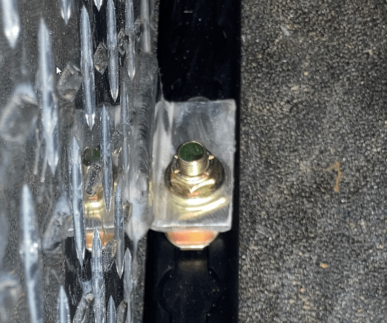

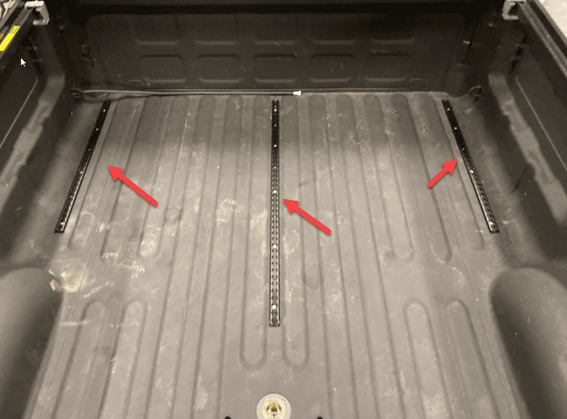

Now you're done... Unless you want to take it in /out super easy you can go to step 2A and add L track to bolt it to. Track pitch is perfect and lines up with the tank mounting holes, I used fixed bolt down connectors and put a 3/8 rubber pad under the tank to prevent it from resting / chafing on the bedliner / L track.
Tank out

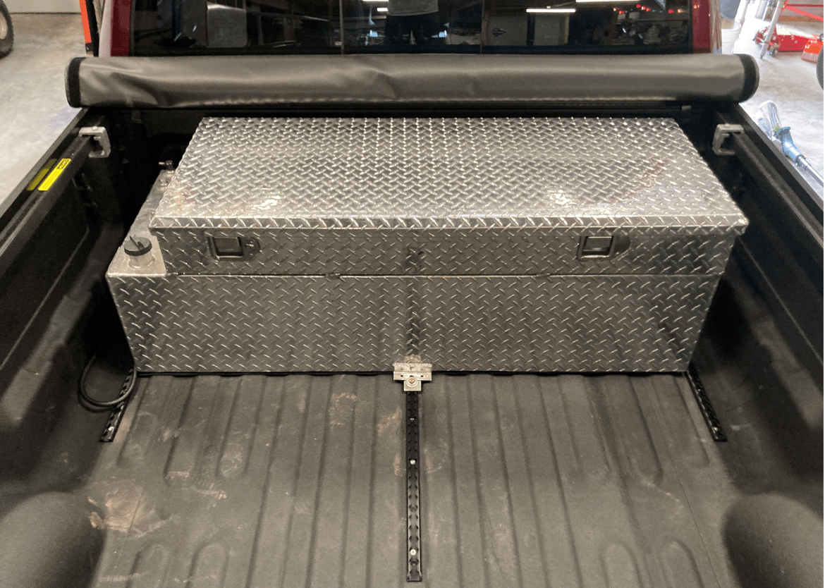

With tank in........
Forgot to mention, the L track gives me a place to strap down my Honda EU2000 generators so they dont hop around on the bed floor in transit. And tie down the cooler!
