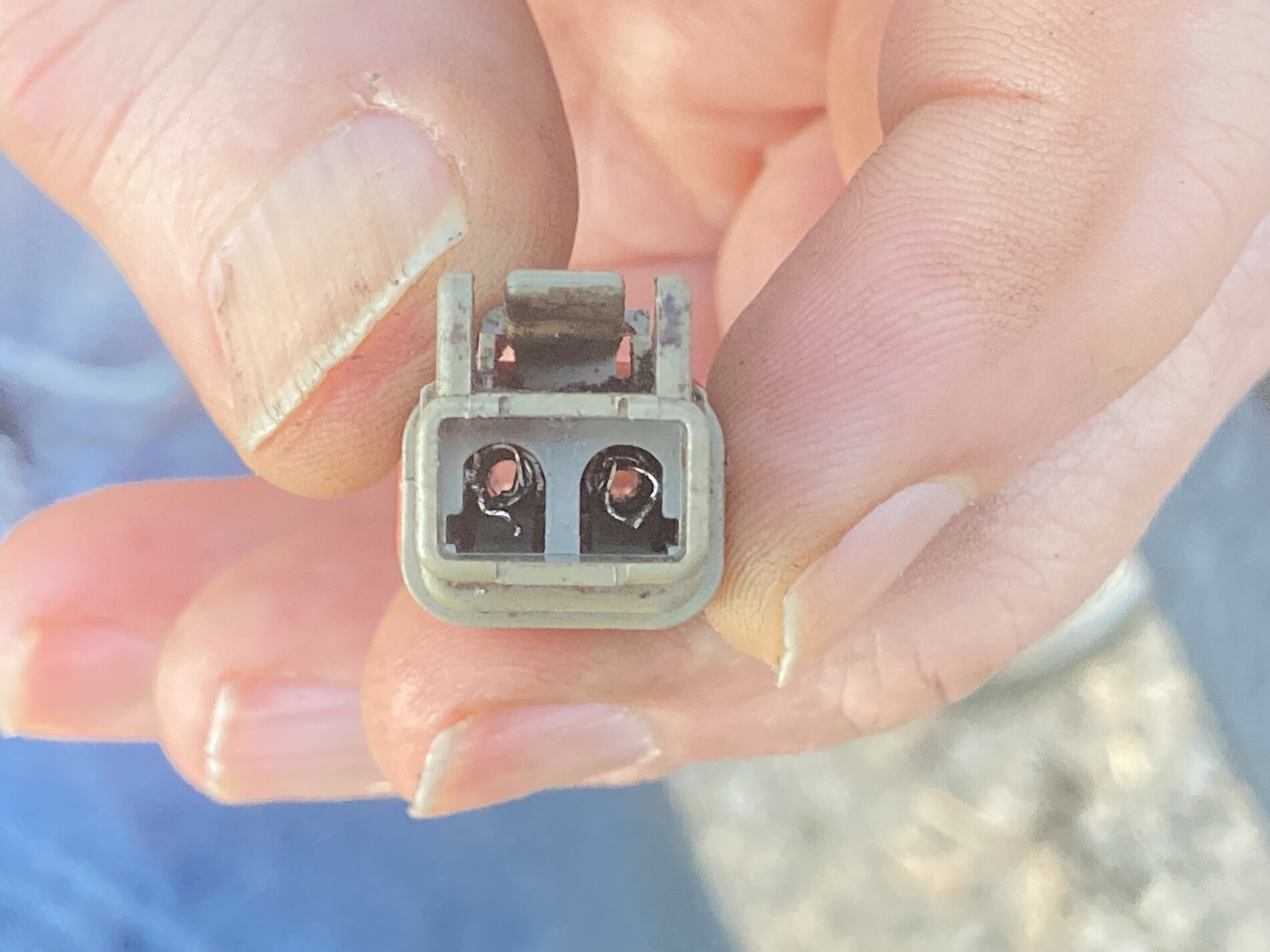

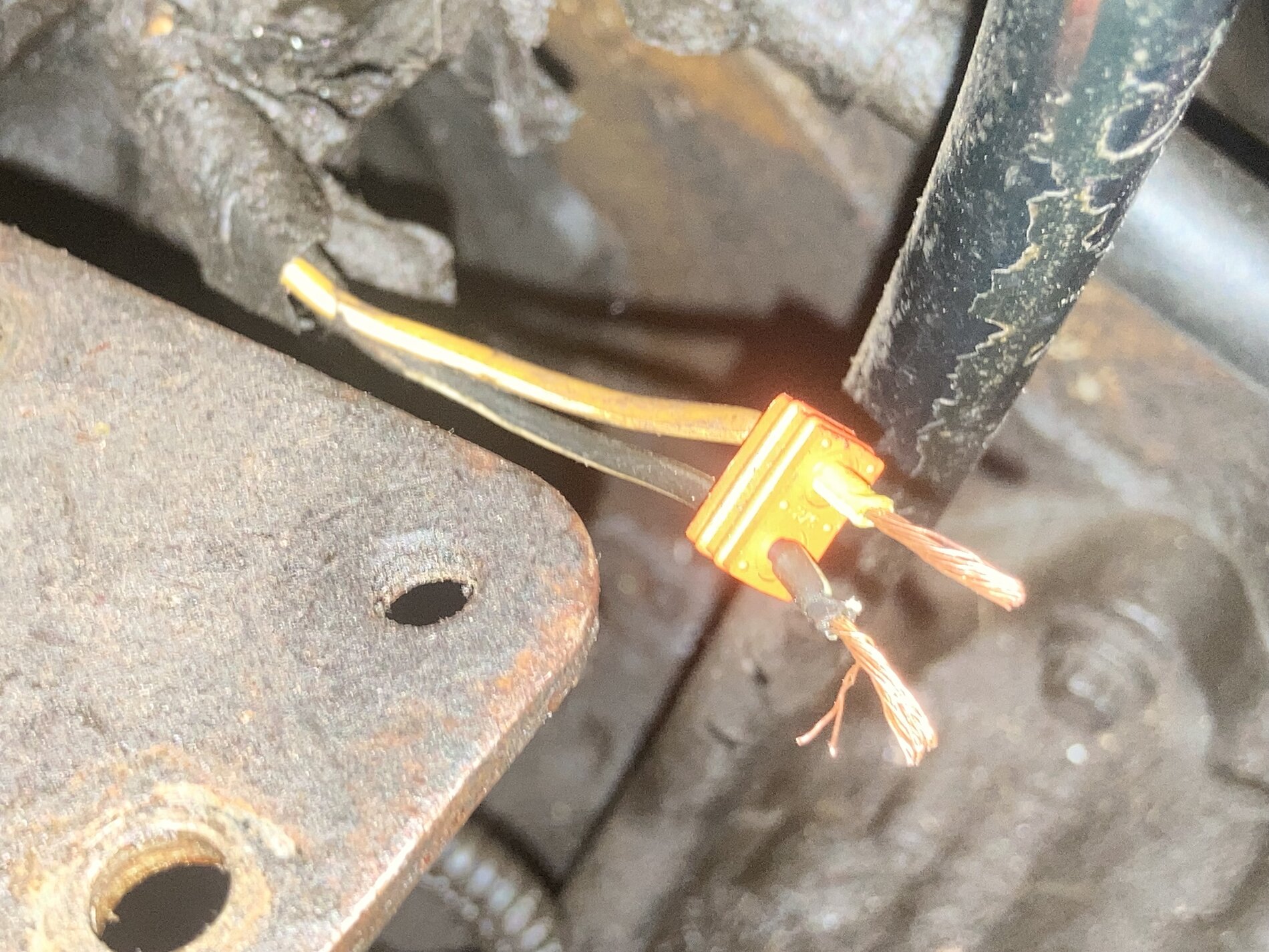

Optimistic, today was the day. When it came to trying to re-install the inlet side, we couldn’t get the bracket in place and the banjo bolt lined up with the hole. The decision was made to remove the pump. When I went to unplug the pump for some reason I did the wrong one and tried to do the one that attaches to the engine. While trying to do so, the wires pulled out of the harness plug!
It’s so tight down there and there’s no slack to work with! Trying to feed those wire ends back into the plug end was impossible.
What are my options?
Last of all, it seems the wires into this plug end were loose and why they popped out so easily, so the possible cause of the pressure fluctuations?

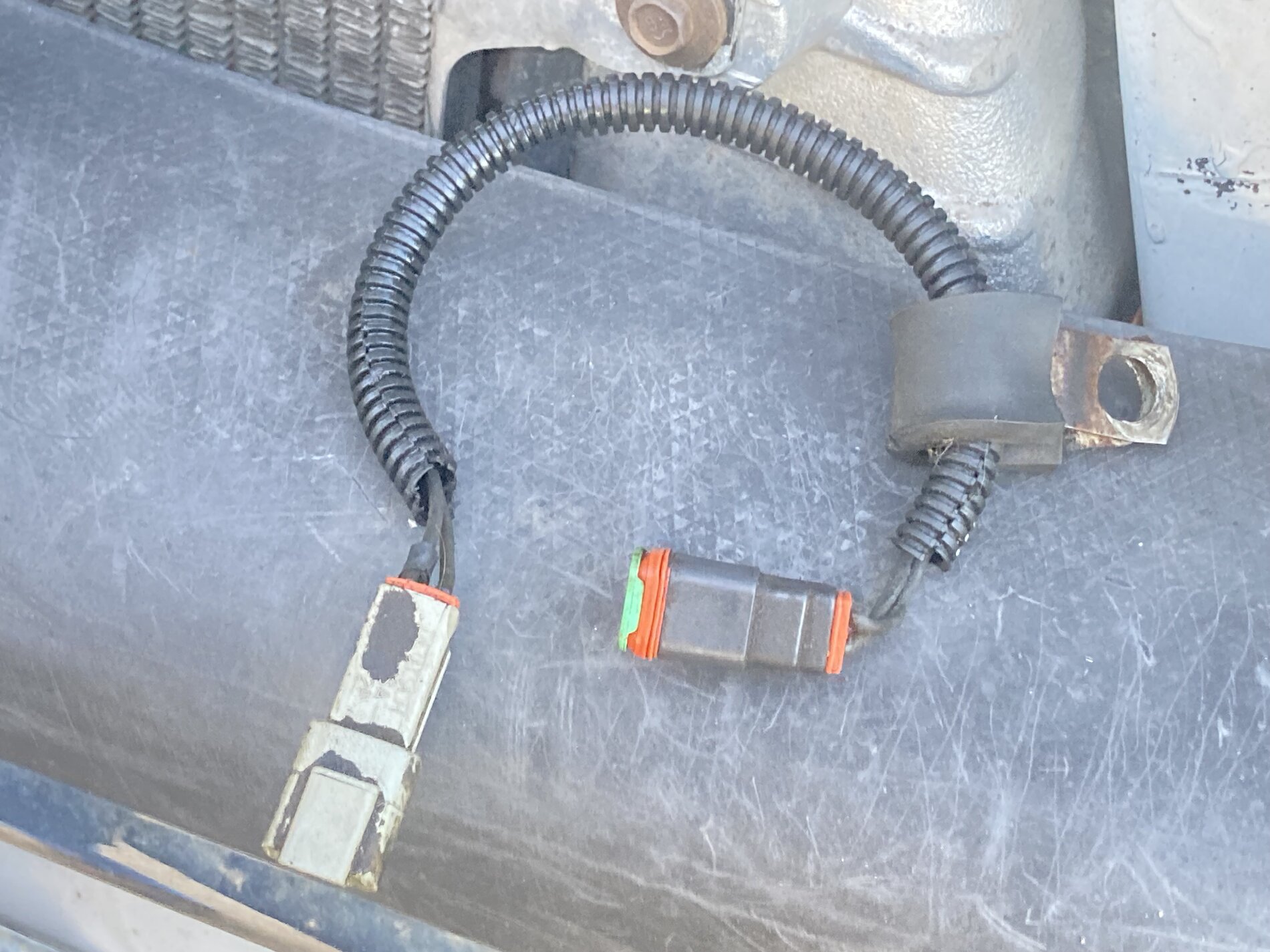

So to be clear, the black plug with the orange is the end that plugs into the FASS and the grey end is the female to the engine side plug that came apart, so cut out the grey harness entirely and splice the two ends together? I wondered why there were two harnesses to begin with, seems a single cable coming straight to the pump harness would be enough.
Thank you!
Thank you!
One is the factory plug, the other adapt the FASS.

From the looks of the connector that you show, you could remove the pins and re-crimp the wires. A good pair of crimpers that have different dies to put in them for different terminals.
If you go another route, you can use hot melt glue under the heat shrink to weather proof the connection. Have done this for a LED if an outdoor fountain feature. Been in use several years now without fail! Good luck with repair.
I only use the epoxy lined terminals and heat shrink now. And investing in the right crimpers is helpful. When you are done use a heat gun and shrink till the epoxy shows in the end of the shrunken sleeve. Me being a jeeper and taking rigs (not my dodge) in places where water and mud happen, these terminals have the best protection. Shy of a weatherpak or other sealed connector that is. That looks like a fun repair... sort of.
