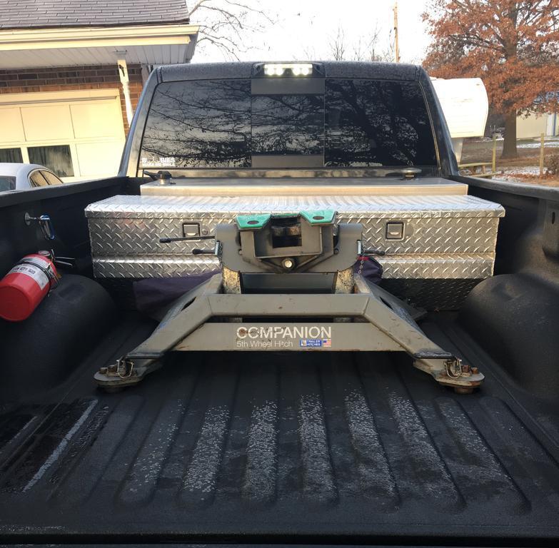

B&W Companion

Now for the B&W, if you have followed my posts you would have seen me telling about my 18K original style Companion deflecting my 2011 RAM bed. Also the base deflected. The FACT is the 18K Companion was flawless when used in vehicles that had stronger/thicker beds than the newer trucks now have. I was towing 18K and after contacting B&W they sent me a new base and filler strips. During that time they were designing a new base with adjustable shims and actually increased their rating to 20K.
