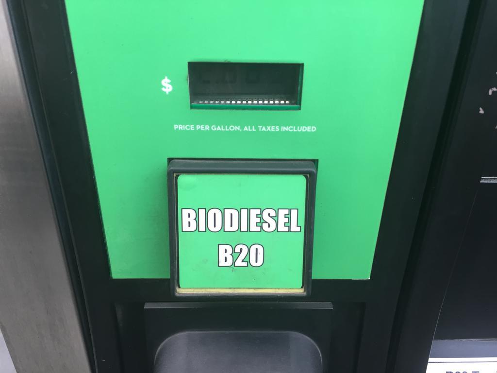

I've been running B20 and B100 since 2005 with No Issues aside from the gelling of the B100 one year before I could blend it for winter. I currently have winter blend B20 in my tank. If i remember right the 4th gen trucks are designed to run on B20. And I have switched back and forth between B20 and reg Diesel when I can't get B20 with out any issues. Good quality BioDiesel from a good supplier is not an issue for our trucks. Now that Ethanol **** they put in our Gas that's another story......

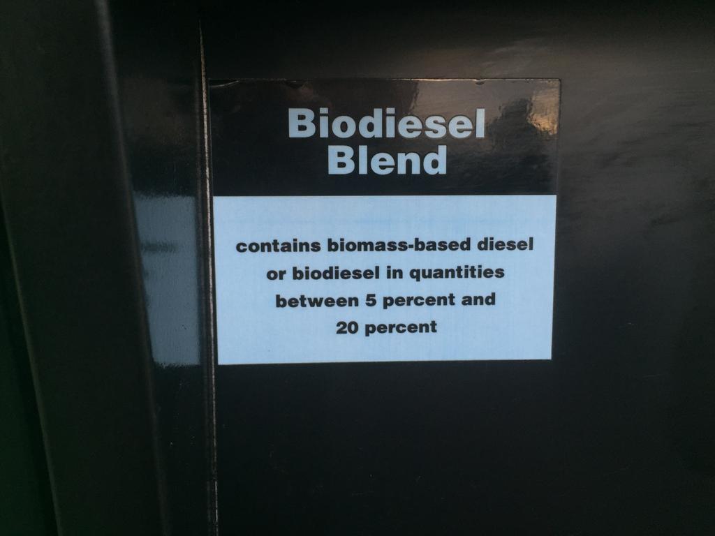

When traveling in Minnesota I found the Holiday stations pumps tag read up to 15% bio so I don't go there. May have been up to 20% bio

I was going to bring up that I seem to get slightly better fuel MPG's running the B20 blend. I also find that it seems to have less Re-gen cycles.

Federal law allows retailers to sell up to B5 without labeling. B6-B20 retailers must put signage up stating "May contain up to B20" but are not required to list specific percentages and can change without notice. B20 -B100 must be labeled as such.
