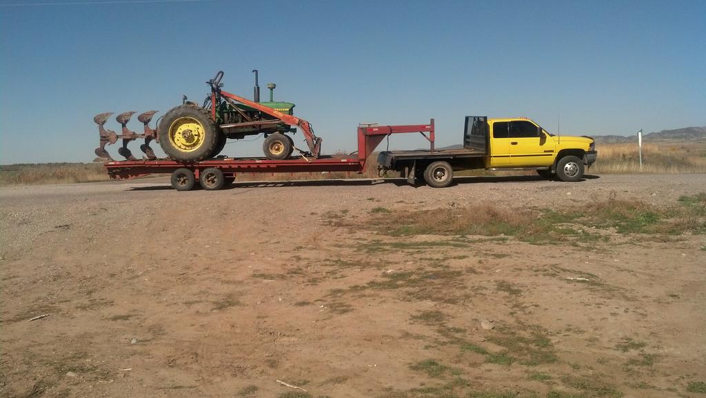

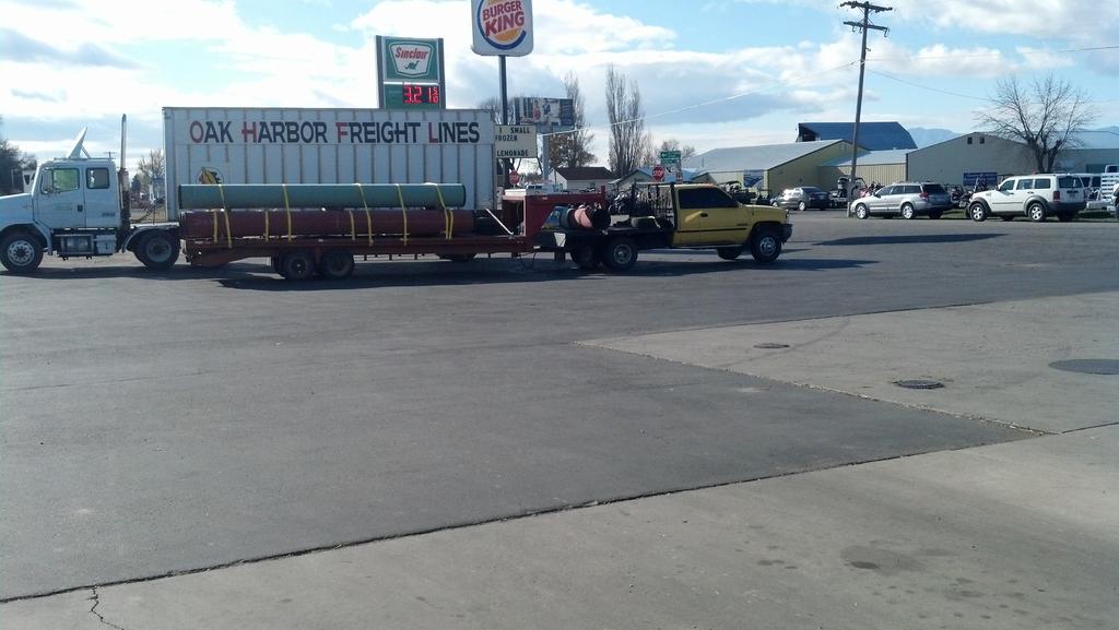

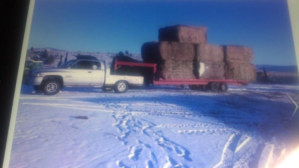

Thanks ya the dually will carry some weight I'm glad I finally got one I usually load the tractor right between the trailer axles that way the truck and trailer are loaded about equal the axles are set up like on log trailer its a walking beam axle setup no leaf springs it has 8 tiresSome nice loads, the dually will pack some weight, I would move that tractor all the way forward and take some weight off the trailer. Are those mobile home axles?
