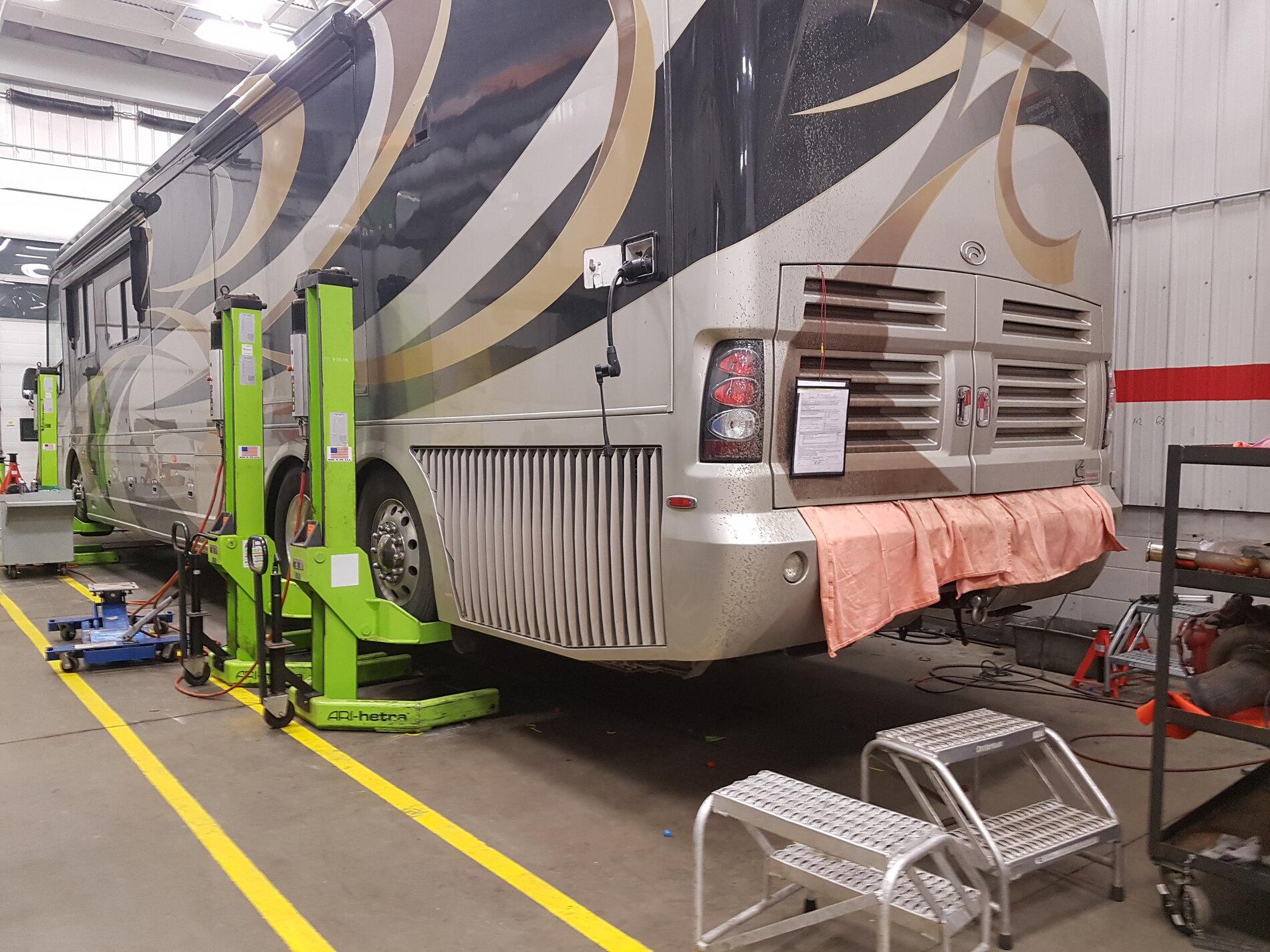

So there are basically 2 ways to remove the engine. Either lift the coach up and let the engine stay down or take it out the back, which in this case would mean cutting the fiberglass bumper off. In the first picture you can see how the professionals do it With 4 ( or 6 when you have a tag axle ) jacks you simply lift the coach up . I don'y own any of these :) With transit buses you can remove the rear bumper and take the engine and trans out as a unit. The ceiling in my buddies shop is 16' not high enough to lift it up anyway. The pad outside the shop is 24' not long enough for a 35+ foot coach to park on. Putting the 2 front jack on gravel isn't a good idea. With it up on ramps and the head and oil pan off I could drop the engine down and "drag it out, but how do I put one back in , especially with a head and oil pan on? A reciprocating saw will work wonders as there is no real "bumper" anyway.
That motorhome has an ISX 650 HP 15 liter engine in it. The bus has an ISL9. I will be using a transmission jack and a home made engine crane.
So my list of new parts, so far, includes new thermostat, rad, belt, fan, water pump, belt tensioner, turbo, exhaust manifold, A/C belt & idler and injectors. The CAC ( charge air cooler ) has been repaired the fuel pump will be checked ( and tweaked ) all filters will be replaced as will hoses clamps etc. I will replace all gaskets and seal that I can access while the engine is out and will paint it Beige as that was the color they used back then.

Those are the exact lifts that I use at my job.
So I’m understanding that you’ve decided to cut the rear bumper and out the back she comes. I guess with the head off, you just might be able to do a tight sling or lift plate and crane it out. How about fabbing a cradle that would mount tight to the engine, like the oil pan rails, and skate it out? Is renting a small forklift out of the question?
What does a shop ballpark charge to just haul the engine in/out plus towing vs. bumper repair on one of these? I ask as RV fiberglass repair got expensive quick for me.
I could easily drop the "short block" out the bottom. The problem is getting the full engine back in. If I had to haul the coach into the city and then pay the shop to remove it, then what? I would have to have the new engine ready to go so they could also put it in while it's there and then haul it back to the acreage. It's not like I can put it on a car trailer. Too expensive. Besides I want to do most of the work myself. :) When it's up and running then I will worry about the bumper repair.
I have my own "picker", an engine crane on wheels. It will lift the 5.9 and with the bumper cut out reach won't be a problem. All this is going to have to wait until warmer weather. I also have access to a skid steer loader with forks and a few tractors but the crane will work fine.
