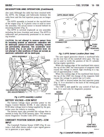

What codes are you getting? As far as I know if you are having issues like you are describing it is going to be your crank position sensor not cam sensor. On the early 24 valves the tone wheel is at the crank sensor and that is where the ecm gets the signal for the tach. I'm not aware of any actual driveability issues that could be caused by the cam sensor
If your 98.5 is the same as my 99 (probably is) the cam sensor is for diagnostics only and the crank sensor is doing all the work. I would remove the crank sensor and see if it was beat up. If it is you may have tone wheel problems. If it appears to be ok maybe try another sensor. It appears to be rare but I have heard of the tone wheel bolts loosening.

Interesting I guess I was backwards about the sensors. The crank sensor I replaced not long ago and it was physically fine.
As soon as my check engine light comes on the engine smooths out and runs OK (but weaker) even though the tach still bounces around, so I guess it switches over to the cam sensor for position reference.

If the crank sensor were to totally crap out the ecm would pick up the timing off the injection pump and run but I believe once you were to shut the truck off you would get a no start.
From the 99 service manual
