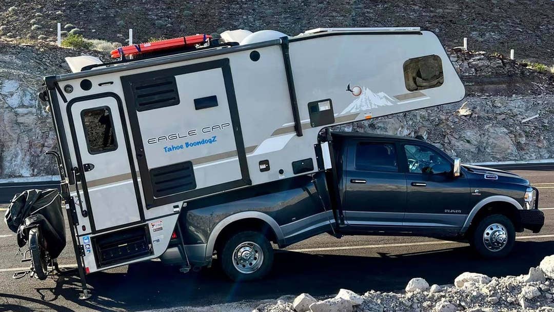

Old picture, was all over the i-net a month ago.
I can't remember all the details but I think he had it on it full time for 100k or so till the frame gave way. And it was overloaded by a 1000lbs or so - behind the rear axle which is always bad.
Ah and he pulled a trailer which added tongue weight to the frame too.
Actually, per the article, the camper was hauled for 25k miles. I am kinda surprised that Ram didn't jump all over that truck so the engineers could study the failure. Every time a new generation comes out, they stress how much they have strengthened the frame.....
I think the 3500 is rated at 23k bumper pull. Ram might want to rethink that...
With the new boxed frames, all attaching mounts are now welded on as there is no access for bolts/rivets like the c-channel frames were. With the rear cab mount welded and the front bed mount welded that location might be compromised.
https://l.facebook.com/l.php?u=http...ehqqhlGcH8Qs7WcQaj9SpHpWsoc8ZXA3H0xlXqToGEZkk
Dry weight of those campers are 4900#'s! Then add in the extra weight on hitch and towing! Accident waiting to happen when you add the Baja roads! Can't imagine they payload in that truck. Rumor was also that camper mount was welded which could make things worse. Either way, Ram bailed due to overloading of the truck!
https://www.eaglecapcampers.com/eagle-cap-1165 , this appears to be the camper. Has 154 gal total water capacity. (66 fresh, 41 black, 41 grey and 6 in water heater). That adds 1200#'s +!
Edit to add camper link.
Based off what I have heard (either here on the other forum, or on Youtube), it appears like the owner heard of the max payload capacity of a Ram truck....which applies to a 2wd DRW with a hemi, and thought it applied across the model line.
