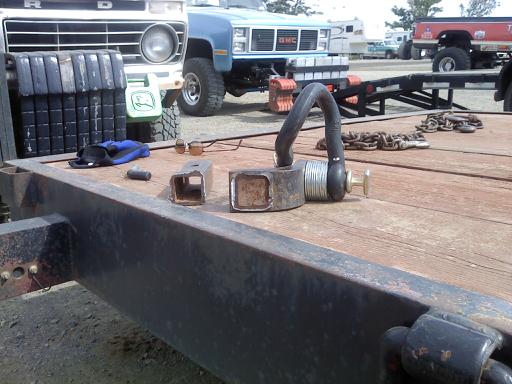

Take my sled pull truck. With 1000k lbs of tractor weights, 4.5' ahead of the front axle, rear hitch 5' behind the rear axle, 26" high, attached with a short chain at the bottom of a 30k lbs sled...When the weight box is full forward and the shanks deploy at about the 275' mark, you stop so fast the engine wants to run backward.:) We are talking 50 hooks like this. I have probably seen a 1000 trucks pull with never a frame issue, everything else breaks but not the frame.
