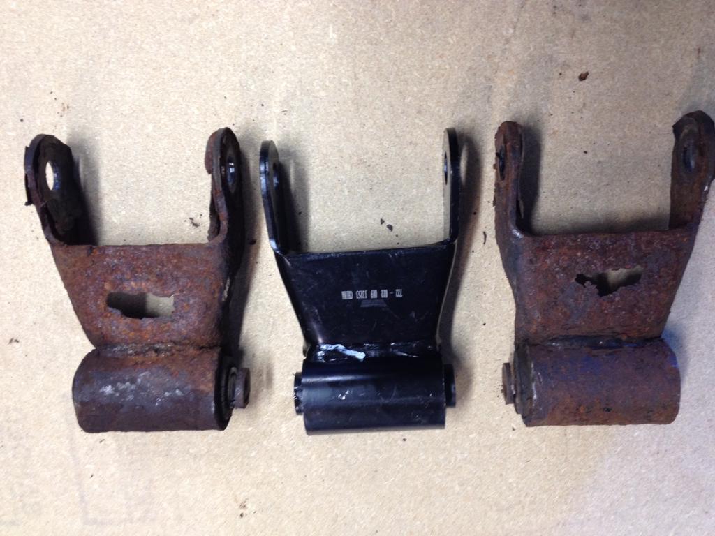

Is there some secret incantation to getting the lower shackle bolt out?
The shackle has rusted through but I can't get it off. The bolt turns, but does not move. Used a gear puller and got it to move an inch. Used a 10 lb sledge and the bolt is even with bracket but I can not get it to move more.
I'm open to ideas.

You got it to move 1"? If you got it to move at all then you've already won the battle. Soak it with penetrant and drive it back where it came from. Then soak it again and drive it back the other way. Back and forth till all the rust in the bushing sleeve is broken down and you can use a drift to drive the bolt all the way out.
They are off.
Air grinder with cutoff wheel.
Do they look like they needed replacing?
Had same problem with same bolt , cut it out with mini grinder , don't even bother using sawzall it will take a lot of blades to do it .Those bolts are tough steel
