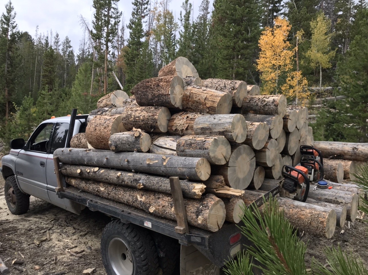

I like this old thread going again. Here is a load from this fall right before we got hit with a lot of snow. It’s my old ‘98 12 valve and my ms361, ms261, and my wife’s little ms180. The pro saws are a better power to weight ratio, better anti vibration, and a magnesium case vs a polymer case. Plus the ms261 has the captive bar nuts. The other saws are still great saws.

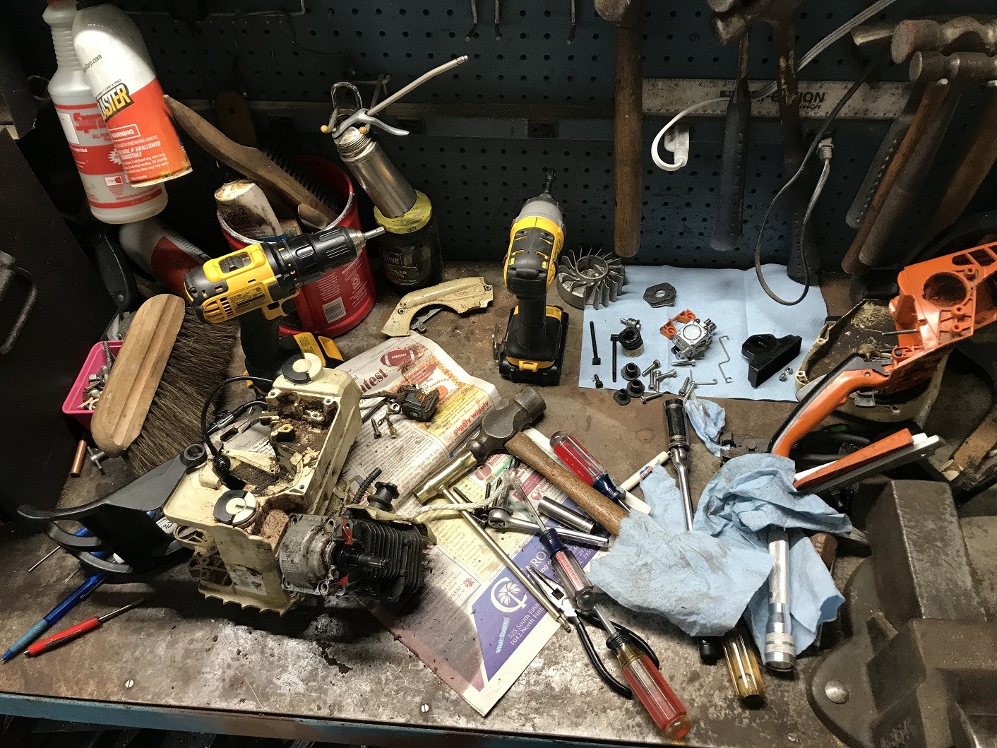

January this year a friend helped me with a project, needed his electrical skills. Asked if he needed help with anything he handed me a MS210 that didn't run correctly. It SCREAMED on full choke. Some of you already know what the problem was took me a little poking around etc to find the air leak. New crank seals and sealing the bottom end and it's back to service. It sent me to a local dealer for parts, that's a key clue. Pic is at full teardown, yeah it's a mess I know.

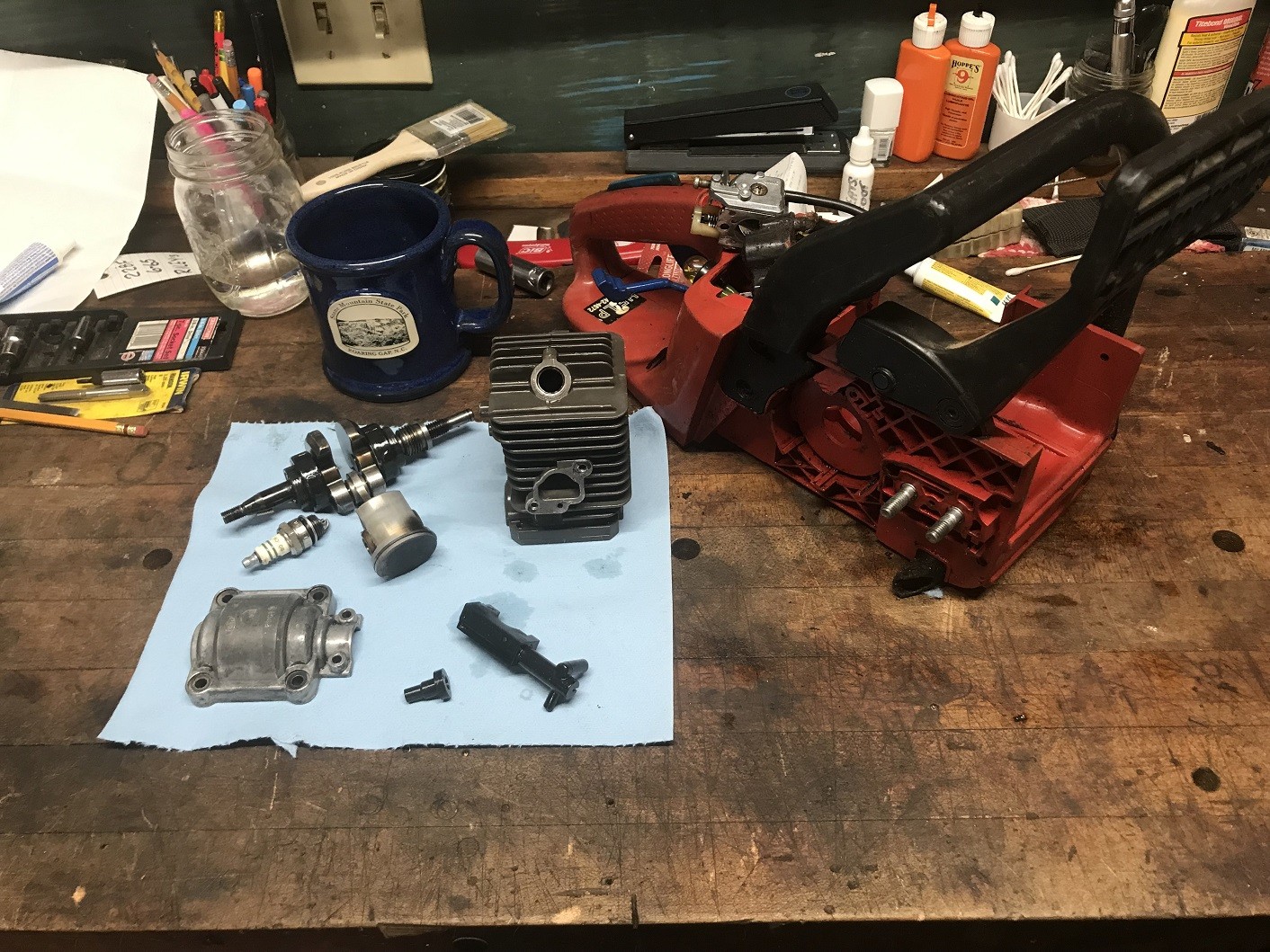

Then he had a Homelite and a Poulan neither had any TLC in years. Poulan got carb work, Homelite needed carb and resealing. Both are on reserve duty to the MS210. More trips to dealer.

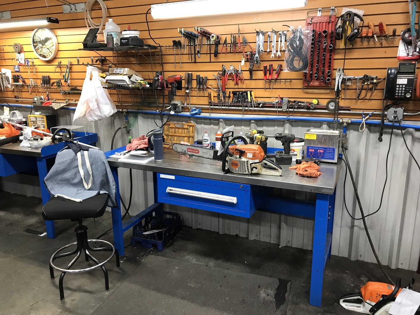

After several trips to dealer they had a help wanted sign posted and I threw my hat in the ring. All of those parts getting purchased on old nasty stuff, somebody remembered and told boss to talk with me.
I got the part time job.
We get homeowner saws and some of those should be confiscated from the owner, commercial tree company saws also some confiscations are in order, landscapers and whatever but the focus is on Stihl and Husqvarna. I've done work on Stihl climbing saws mostly handle R&R due to damage up to an MS660 that's the biggest one I've wrenched on.
I enjoy the bench work and the challenge of putting it back into service and I'm working part time with a good crew. And the guy that pays me is the same guy I bought my MS290 from earlier in this thread. And I now have my OWN bench!
