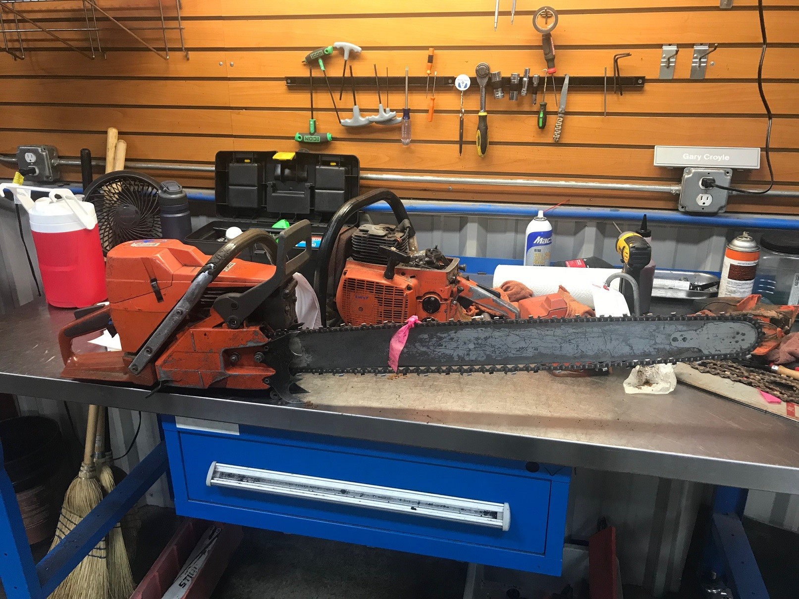

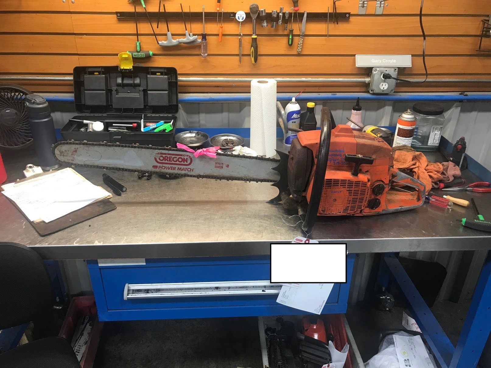

Customer dropped of a Stihl MS192 top handle for recoil TLC and a pair of for our area these big bad boys. I had no clue what the metallic beast was the 2101XP wearing a 28" bar. Looks like the pull handle, fill caps, covers and air filter frame are most of the plastic content. The rest is some version of metal. when that bad boy fired up it was holy crap time! I was told its about 30 ish yrs old.
Then it's stable mate wanted to get into the frame. Its sporting a 30" bar. But it has some non metallic parts. Still a handful.

What’s the cc’s on that husq? Weight? Can’t find any info on the 210xp. Don’t have a lot of experience with Husqvarna stuff.
The little cheater hint on Husky saws is the model number, which, like other brands do sometimes--lookin' at you John Deere--don't really follow any sort of size identifier, but more of a series. Sort of.
The last two or three numbers in the model name is, roughly, the CC of the powerhead. Like a 288xp is a 2 series, 88cc, but it's actually a 87cc and "2 series" saws from the early days share essentially nothing other than orange paint with the newer "2 series" saws that are basically homeowner pieces of trash.
So that 2101 I think, is a 101cc 2 series from the older days, but it's actually a 99cc powerhead. Marketing. Good old saws, if it doesn't have a compression release on it, just rest the bar on a log, hopefully the recoil rope is on your good hand side, drive the saw away from you with your other arm as you yank back towards you on the rope. Wear a glove and expect it to yard out of your fingers at least once.
The big saw at the bottom I *think* is an older 395XP, based on the shape of the tall air cleaner tower. Lots of XP saws have that "tower of power" but the position of the black clamps in relation to the angle of the cover's cut gives it away. Again, big falling saw, 95cc makes a tad over 7hp stock. Beast of a chainsaw. it should pull full comp chain on that bar without slowing down.
All the metallic bits on both of them are die cast magnesium. It looks like the side cover on what I think is the 395 is cracked; something in the world's history happened, if only it could talk.
Both have those meaty fat falling dogs on them; somebody was cutting some big timber back in the day and got their money's worth outta them sistas.
I don't think I can add any info beyond what Dl5streetz already said. I'll get the model of the newer one Monday.

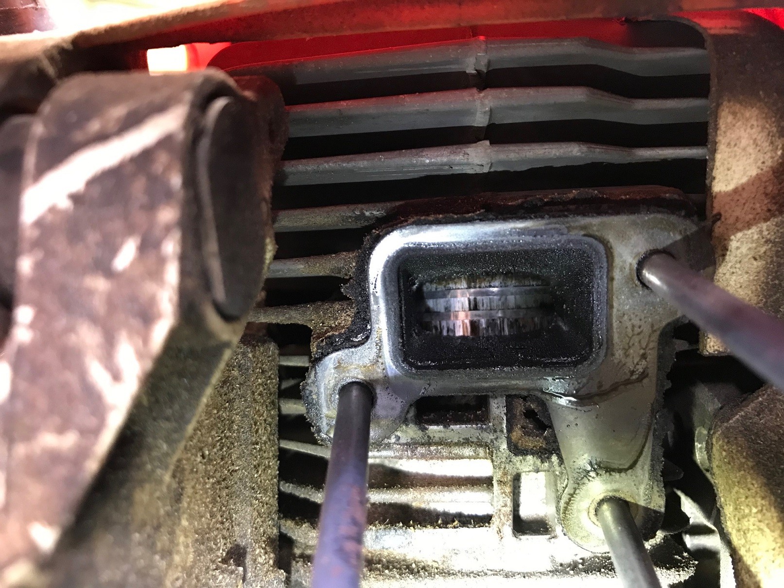

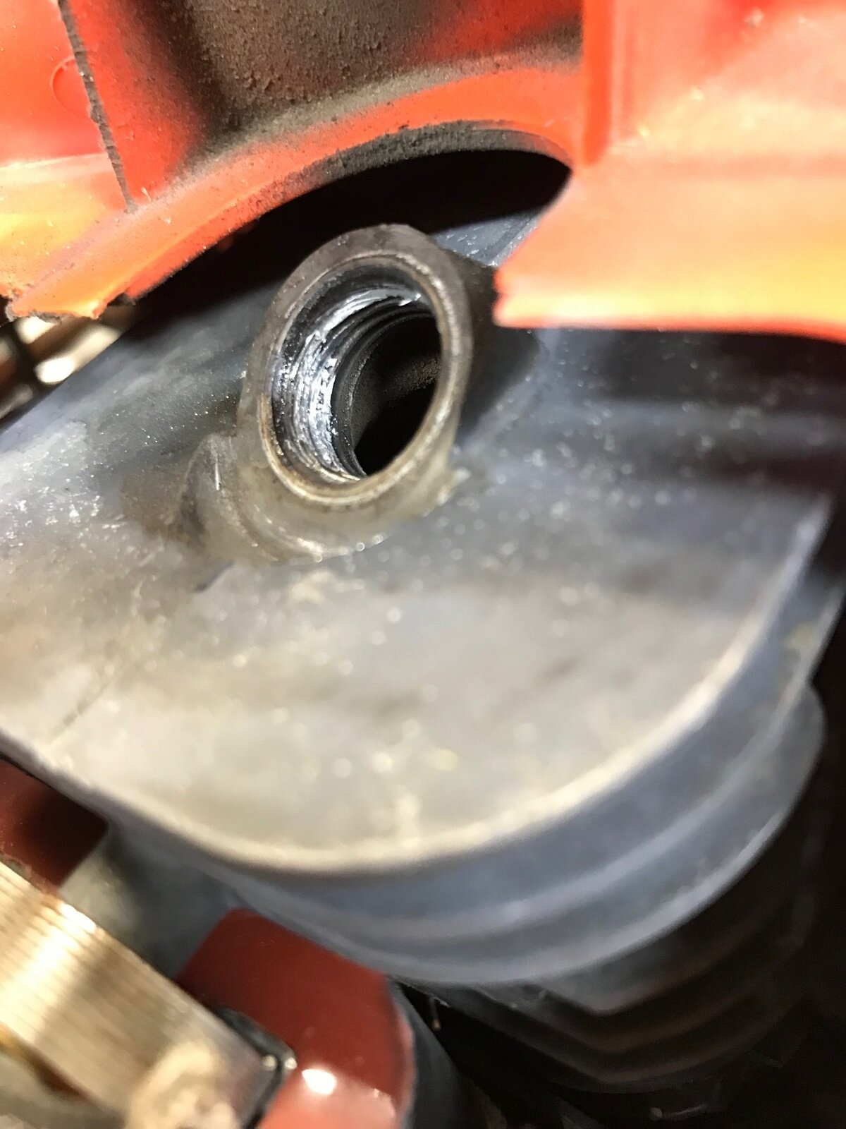

A simple hand held blower, yeah right. Only used on fall days on the 5th saturday's each leap year. Blah blah. Doesn't run. Just cause my spidey senses kicked in I pulled the plug and it was as new as new gets. Started a compression test but what did my wandering eyes see! A cross threaded plug hole and stripped threads. Yikes! Boss says, heli coil time next week.
I dispatched the air lift home shop tool retrieval team to confiscate the offending owners spark plug wrench and everything else that fits in the chopper.

The hand held blower with the stripped spark plug survived a heli coil repair. No, I watched this time. Yeah it was interesting. It's now an invoiceable unit.

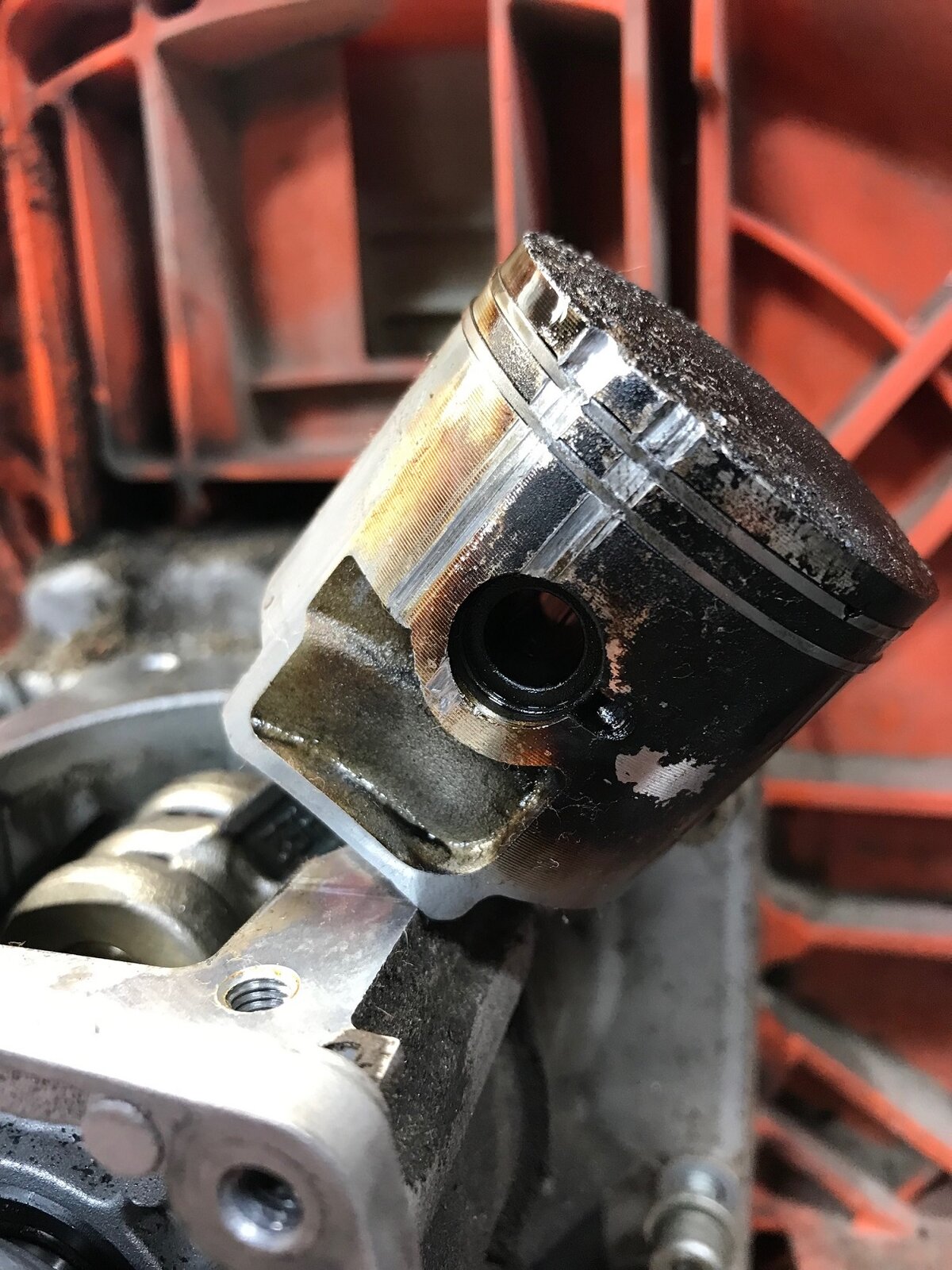

But not all was joy in mudville we lost a Husq back back blower to ring/piston/bore messed up. WE tore it down to totally confirm its condition as we couldn't see the damage clearly but we felt it in the pull cord. See pic.
