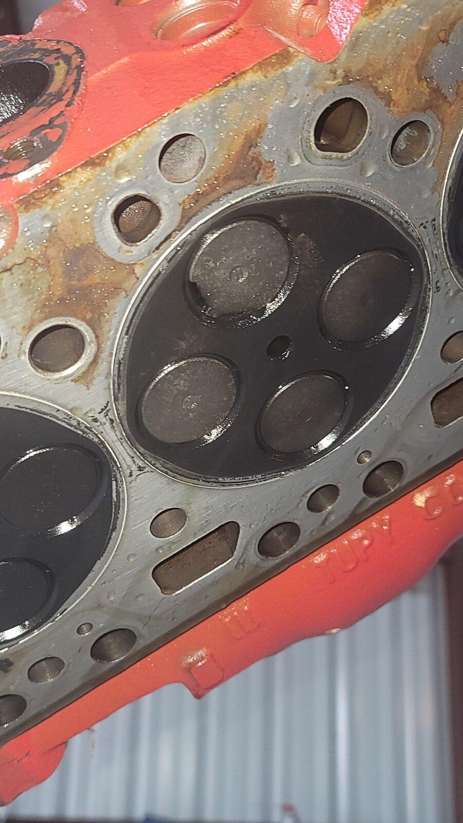

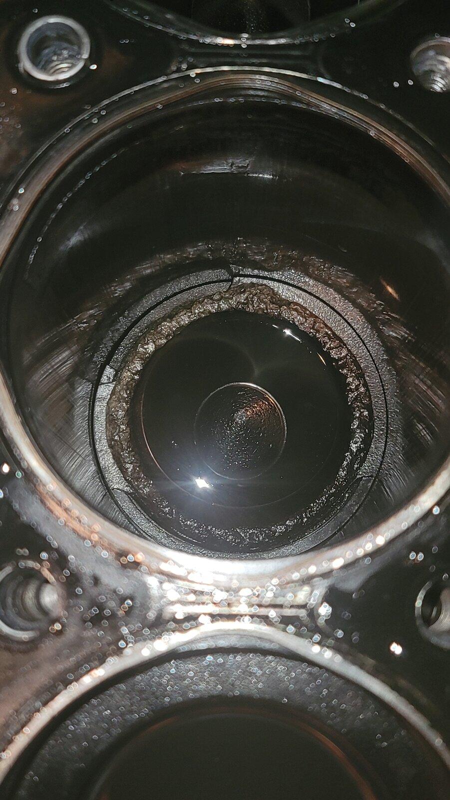

Either way I'm pulling the head to see the damages

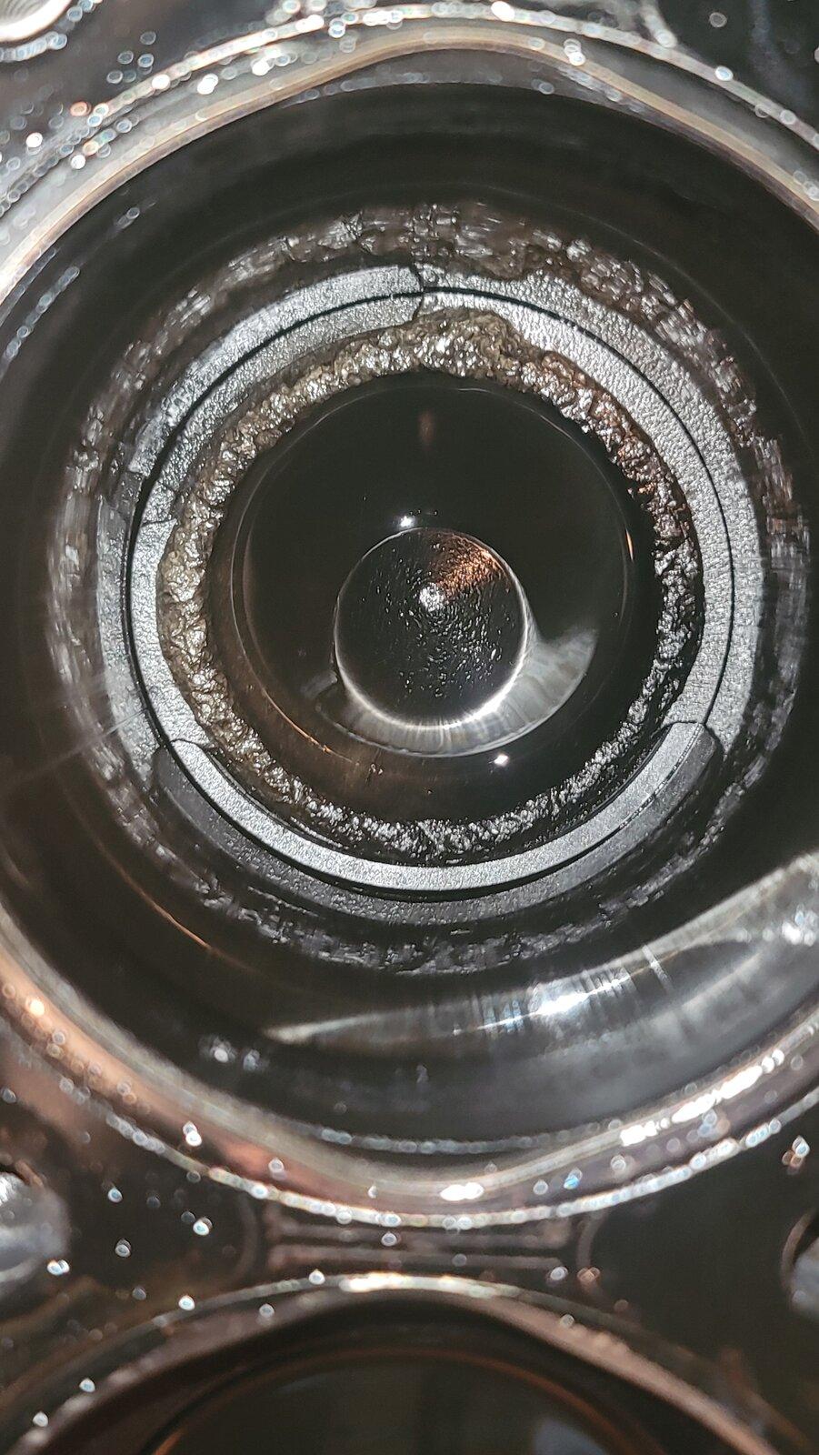

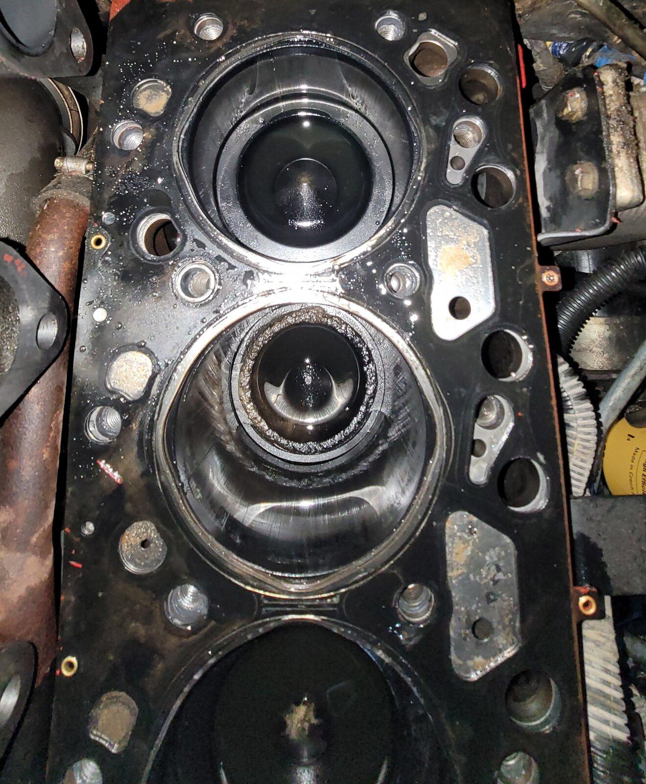

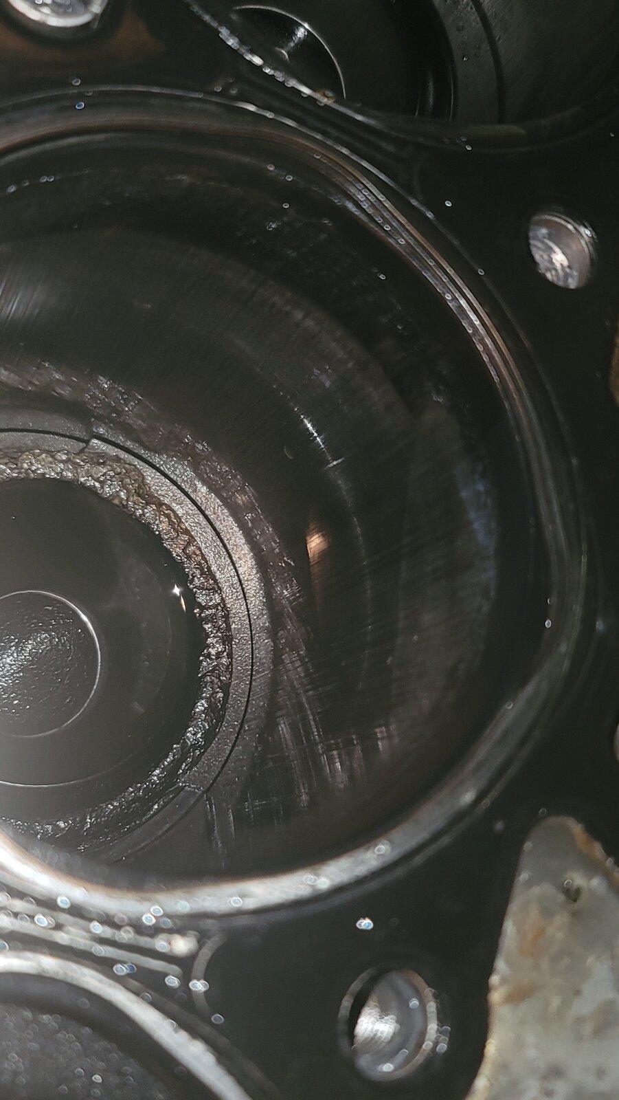

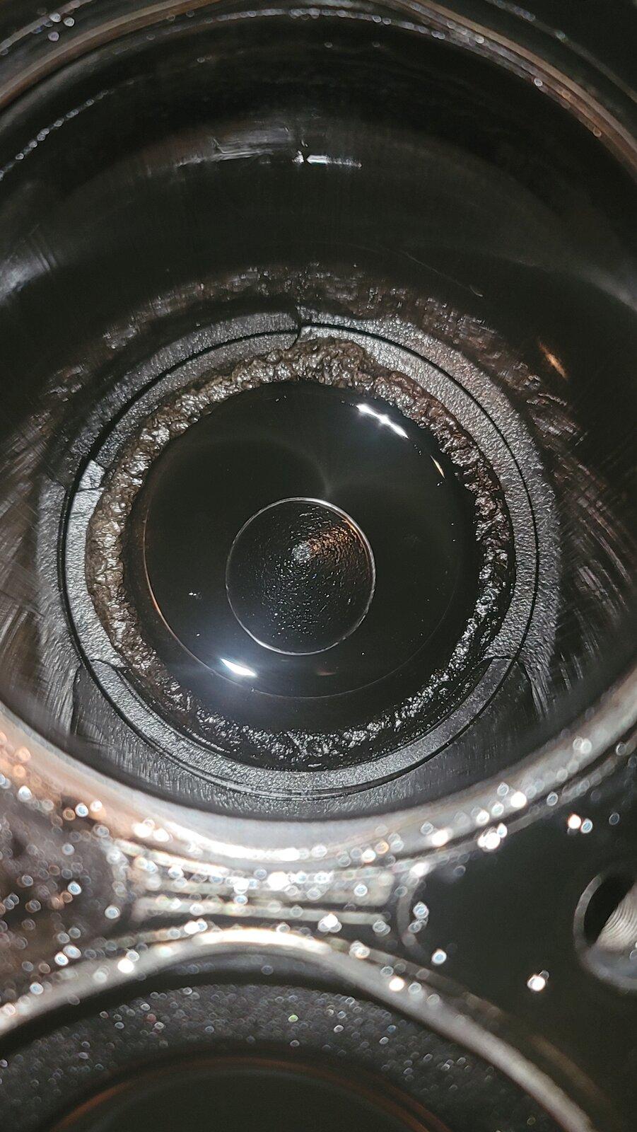

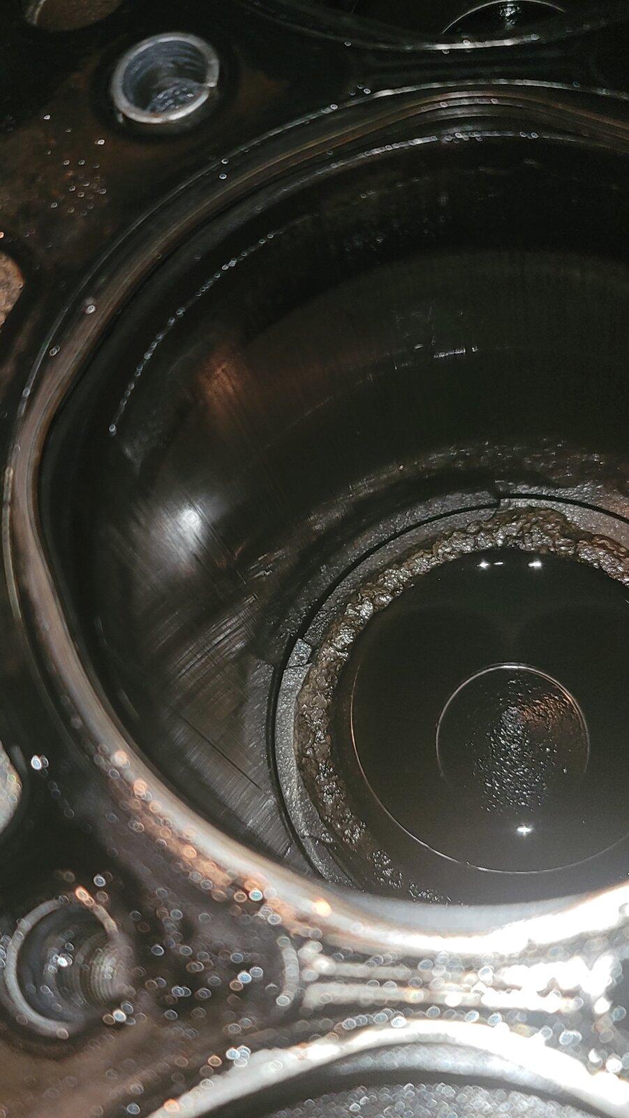

Drum Roll.................. Busted exhaust valve and completely fried piston.. How wonderful!
Didn't burn a hole thru it so didn't get much blow but that's a paper weight now. If it hasn't scored the cylinder too bad it might clean up.
How does #6 look?
Wonder why the compression was low on it, did it blow the gasket between 5 and 6?

I guess the big question is, is there too much damage to the walls to be honed out and a new piston dropped in
