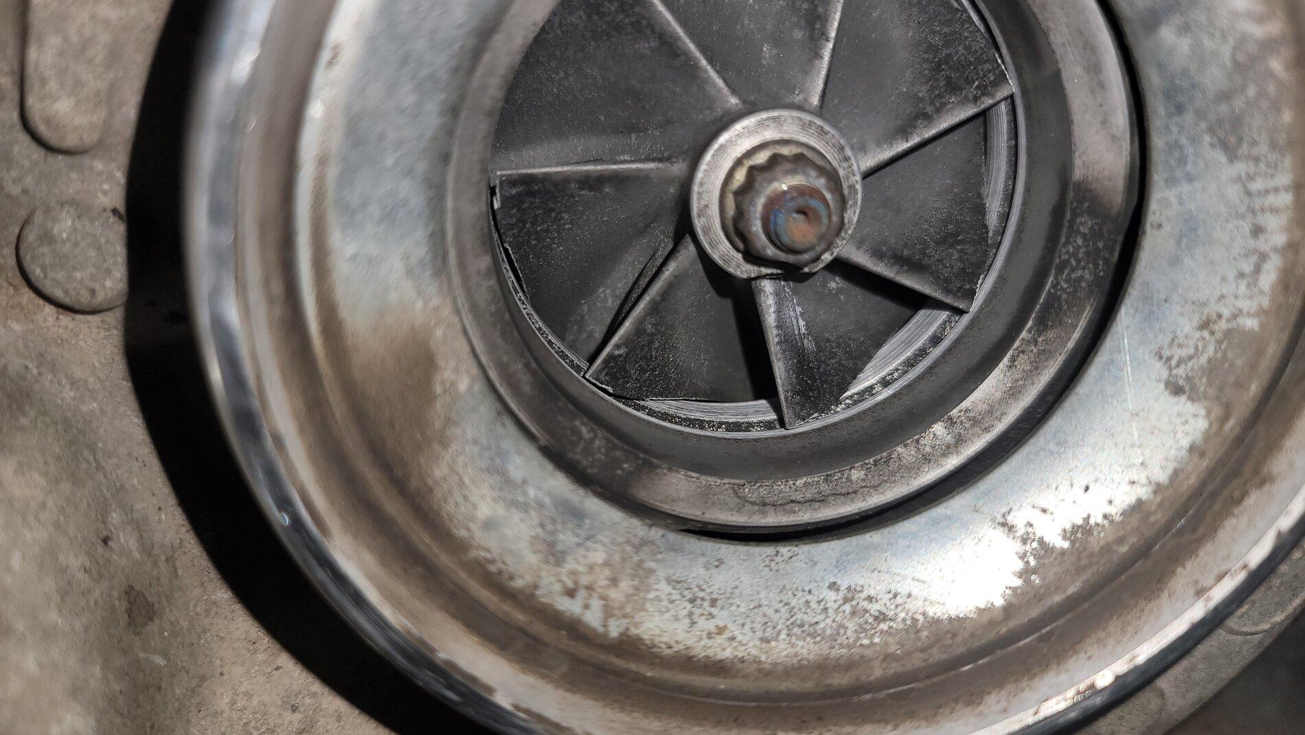

Went out to tinker with the truck. I thought it was knocking but it's not anymore. Took valve cover off to try and diagnose a bad injector. Took air intake off turbo and I'd say she's shot. Wiggle in the shaft and edges are worn on the blades, you can also see where it's been grinding.
Got a new camshaft position sensor coming and looks like I'll be ordering a new turbo

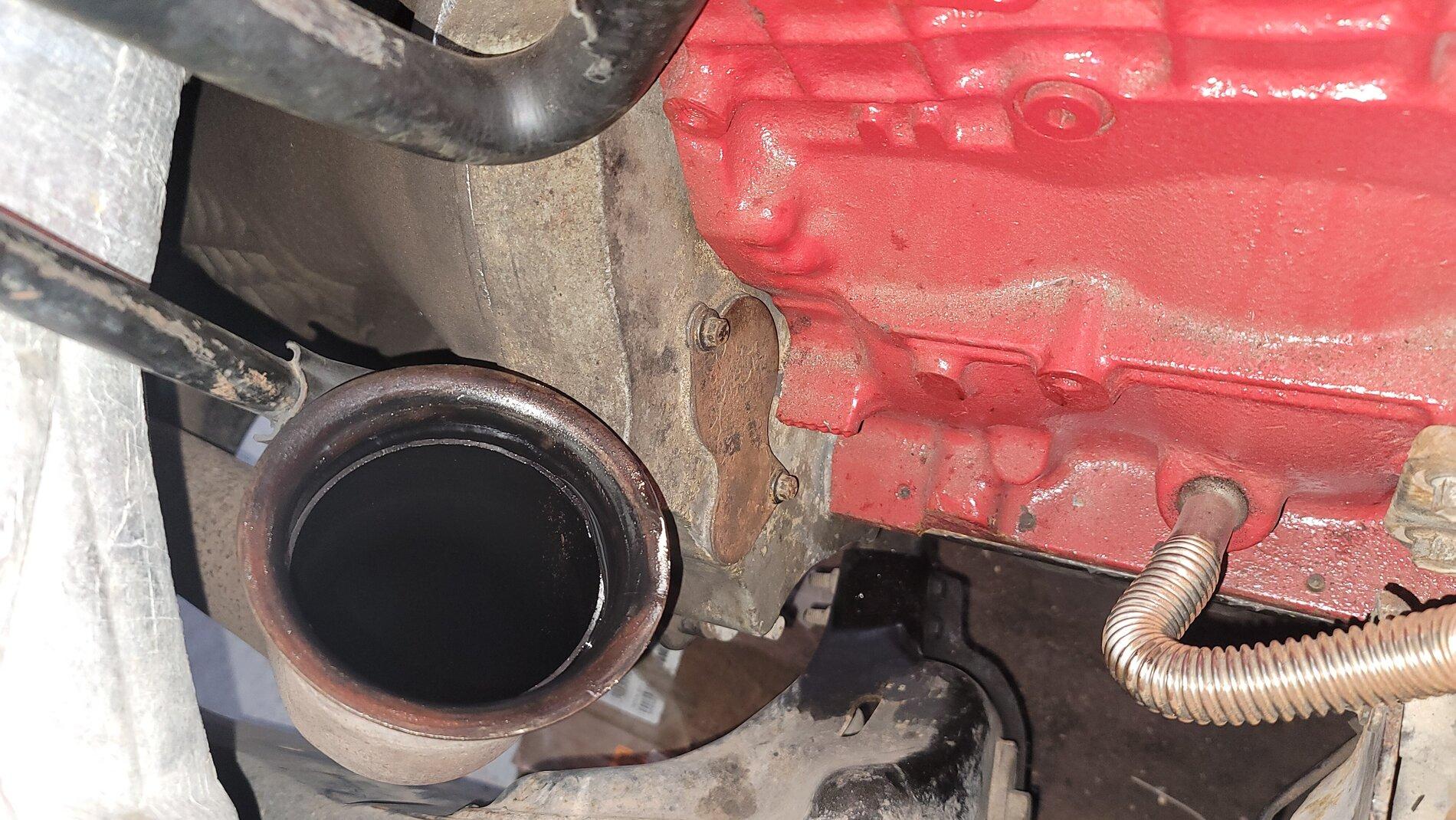

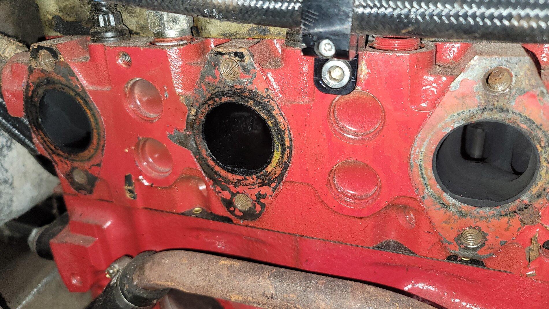

Took the turbo off and noticed oil in the downpipe. I also noticed the #5 exhaust port is wet and it's the only one that's wet, should I be concerned?
When I had valve cover off and had it running there was no smoke coming from the top head.
That is not a good sign, probably the source of the smoking and knocking that is not there now but was.

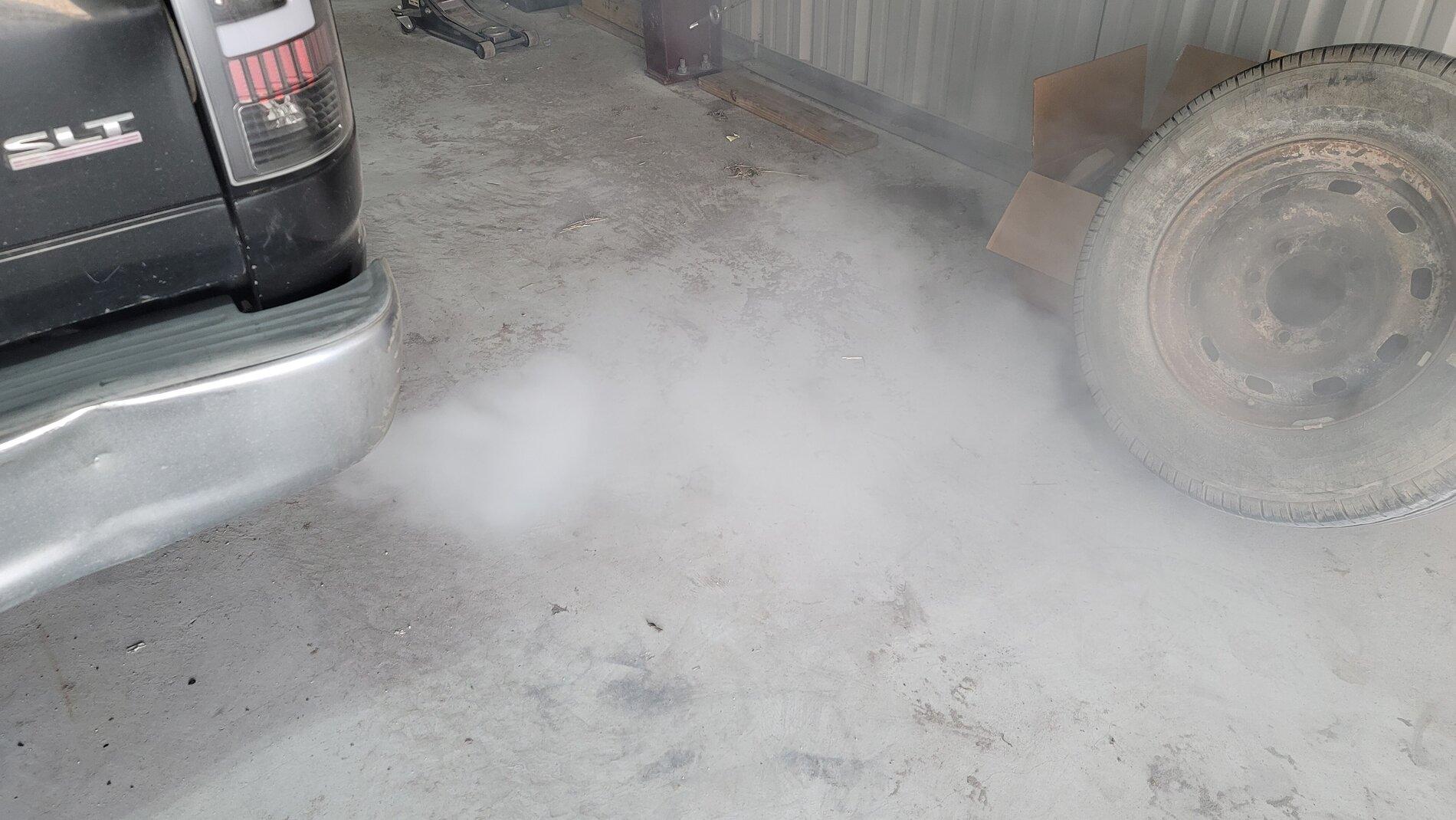

Well... I replaced the camshaft position sensor and the turbo today. Truck is still puffin smoke. Its actually leaking so bad it's coming out of the turbo down pipe. Its a greyish color smoke.
Disconnected #5 injector and that didn't help. Popped the oil cap to check for blow by and there is none, cap doesn't move at all.
Needles to say I'm not happy.. new motor with 50 miles on it and it breaks. I'm about to give up on this money pit.....

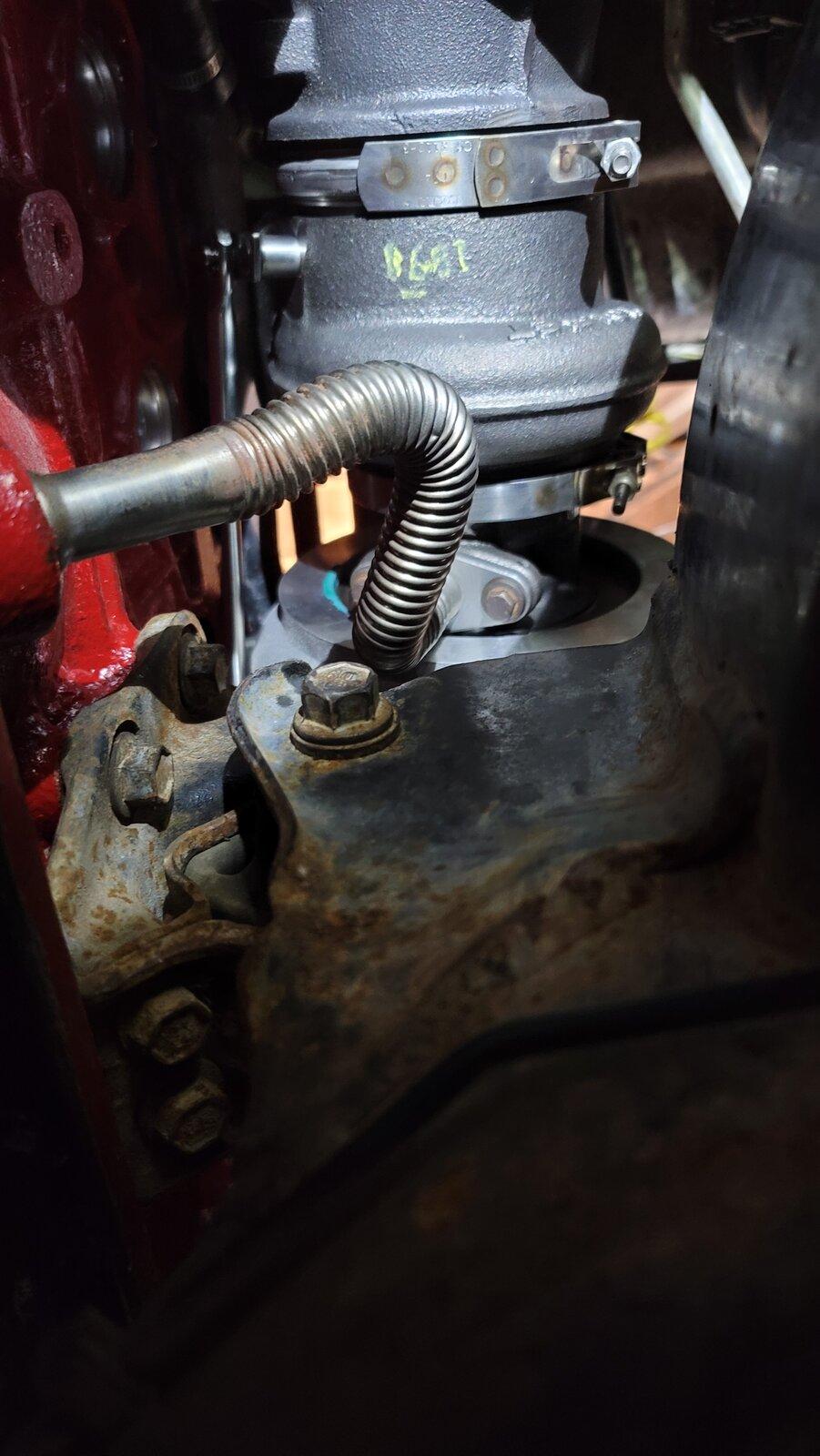

I read that it could be the oil return line. Here's a pic of mine , looks fine to me.
I took a pic of the smoke.
