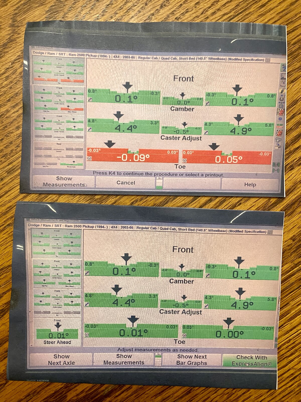

To conclude my original question, it turned out there was nothing wrong with my control arms or bushings. The big culprit in my steering issue was the track bar bushings, which I replaced with polyurethane aftermarkets. I also replaced the swaybar links with SuspensionMaxx from Summit. And installing a new Bilstein stabilizer today. Off to get it aligned to the Thurian specs next week.
should tell you the specs it was set to. Before and after specs.
Here’s my before and after specs. Looks like all they really changed was the toe-in. Seems to drive good.
