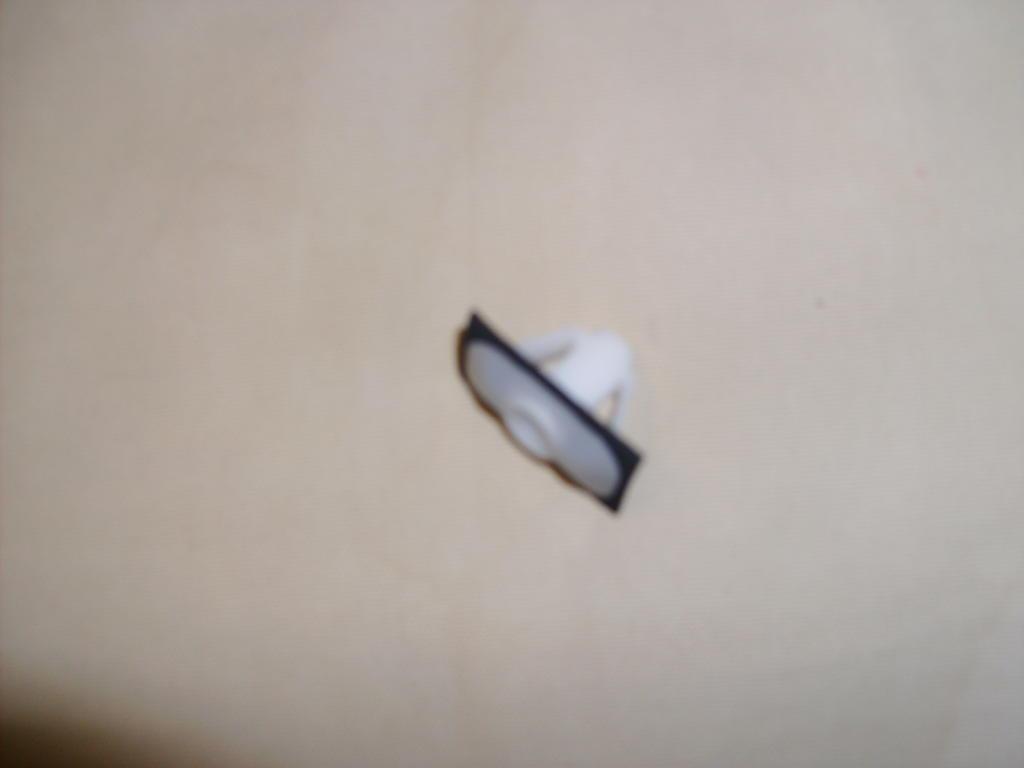

I thought I'd share this info to save others some time. I had the dash out of my '97 a year ago, and had to hunt the junkyard to find replacement retainers to hold the dash screws. The old ones were all dried out and came apart when I removed the screws. Fast forward to now, and I need to pull the dash again to put my heater door back together. I hunted all over the internet and could find nothing on these inserts, so I went to the Dodge dealer and he couldn't find anything either. So back to the internet and after about 2 hours of searching I came up with something on a Durango forum about pulling a dash with a part number. Some searching with the part number came up with a picture, the right part!
So here, for anyone that needs to pull their dash, is the insert that holds the dash screws in.
Part #06504485AB
That was my intent, to save somebody the agony I went thru to find it. Also, it comes as a package quantity of 4, so plan on buying 4 or 8! It's supposed to fit '97 thru '07.

I figured I'd post an update. Bob, yes, and the local dealer parts guy couldn't find them, so I had to resort to the Google! lol I looked at that link posted by Crabman, and those are the wrong inserts.
I pulled my dash a few weeks ago when it was warm, or sorta warm. I fixed my heater door and installed the new inserts. Turns out I only needed 4 of them, the center hole is just a hole in the cab, no insert needed, so the package quantity turned out perfect.
