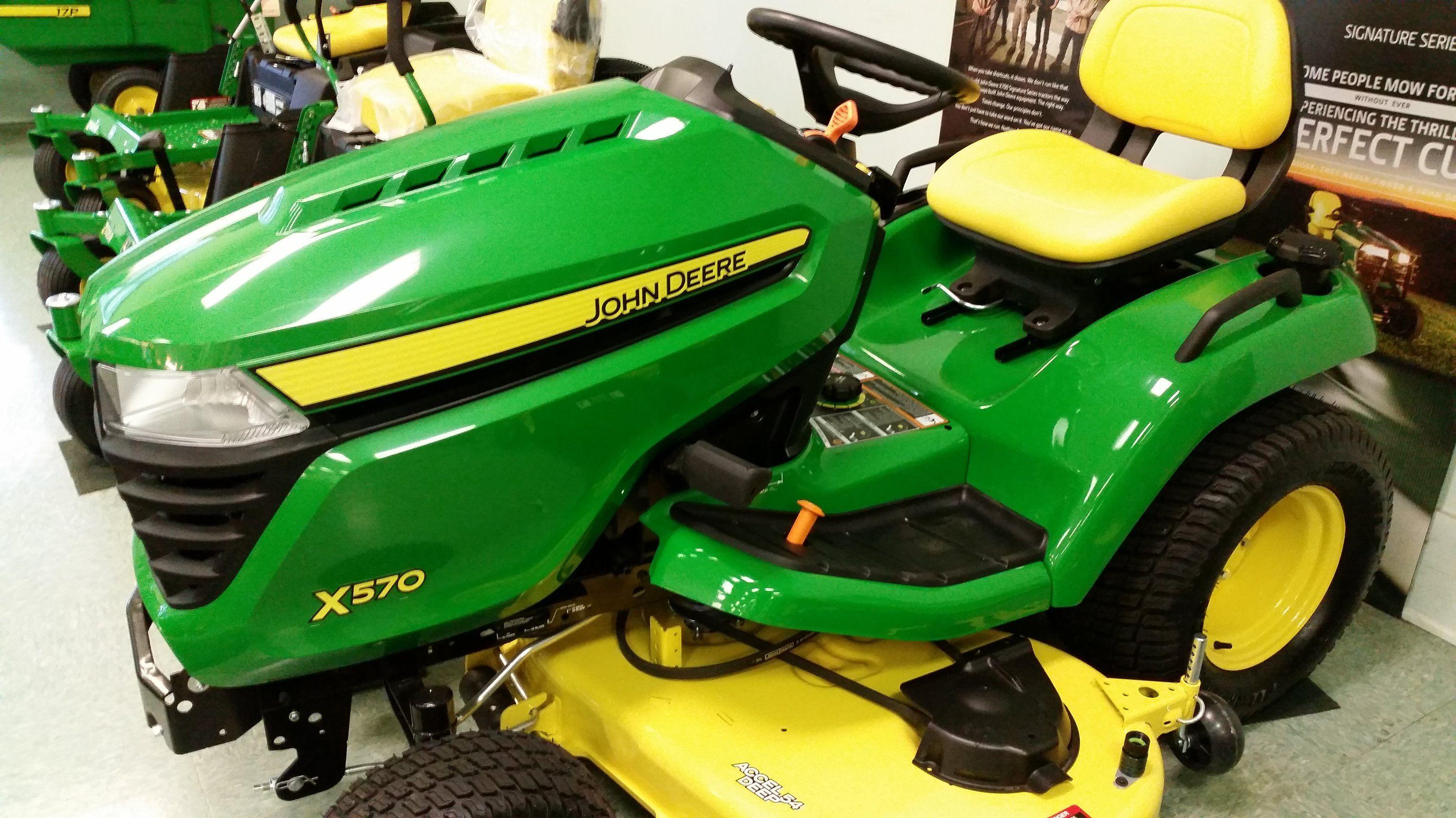

If I were buying just another garden/lawn tractor, this would probably be a contender.
JD X570. 24Hp Kawasaki. Hydrostatic.
The dealer a few miles from my house quoted me $5900 for it but told me to hold off until Jan 1 if I was interested and he could do better.
The thin plastic hood scares me a little, but otherwise not a bad little tractor.

I have no idea what materials are in their hoods now, but when I was still a dealer the LX series lawn tractors were introduced with "plastic" hoods, versus the fiberglass of the outgoing models. Dealers immediately began grumbling UNTIL we were brought to a demo area and handed Louisville Sluggers to have at it. Turned out the resin was made by Eastman Chemical, and it was called Ektar. It is what they were making combine cabs out of. It was color-through, and unbelievably tough, plus you could compound scratches out. No idea if they still use that.

My 2003 has the composite hood and front covers. No issues. This material seems incredibly thin in comparison. I'm sure it is fine. But, it appears very cheap.

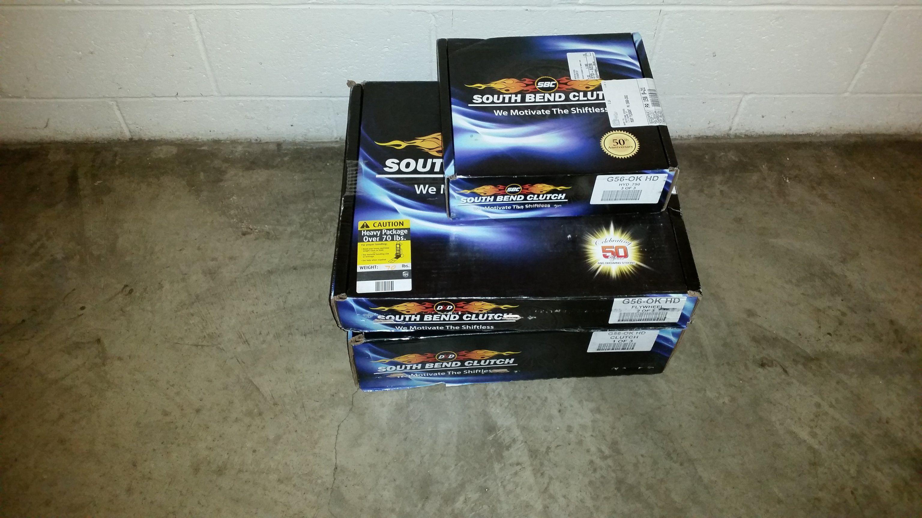

I've got to give South Bend Clutch credit, I ordered Monday morning. Clutch was waiting for me when I got home.

All finished. It would have been finished 3 hours ago if it wasn't for trying to track down the rear main seal. Just took it out for about a 30 mile run. Works perfect. The old clutch plate looked like new but obviously the flywheel was what failed on the old unit.
The new G56-OK-HD is just slightly more noisy with the new single mass flywheel as compared to the stock clutch. Feels great. Clutch engagement with the new hydraulics that South Bend sent in the kit is just a little heavier than it was before. They even sent the new hydraulics already filled and ready to go out of the box. Didn't even have to bleed it. That's a pleasant surprise and a great example of their attention to detail.
Also replaced that red shifter boot seal on the top of the trans. It was just starting to leak, but it wasn't worth trying to reuse the old one when it was out. Also took the time to change the transmission and transfer case fluid. Both came out looking great with no sign of wear metals or heat issues.
