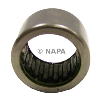

Michael, at 259k I recommend you change your clutch. Mine was working fine when I changed it (210k) just getting hard to push the peddle. It was worn out, everything was. I was lucky, there was no damage at all. Our trucks have a poor pilot bearing and can damage the input shaft, mine was fine but the bearing was dry. However, as I approach 200k I am gonna get worried, lol.

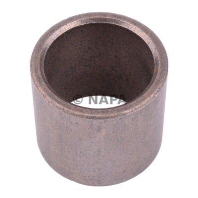

When the needle bearing pilot failed in one of my Fords, which fouled the splines and kept the clutch from releasing, I went to my buddy's machine shop, and he had a whole assortment of pilot bushings. I came up with an oilite bushing with the correct ID and OD. No more needle bearing to fail.

Yes, they last forever. My '91 has one, I don't worry about it at all. I would use it in my '01 if it would fit, but the OD is too small.
