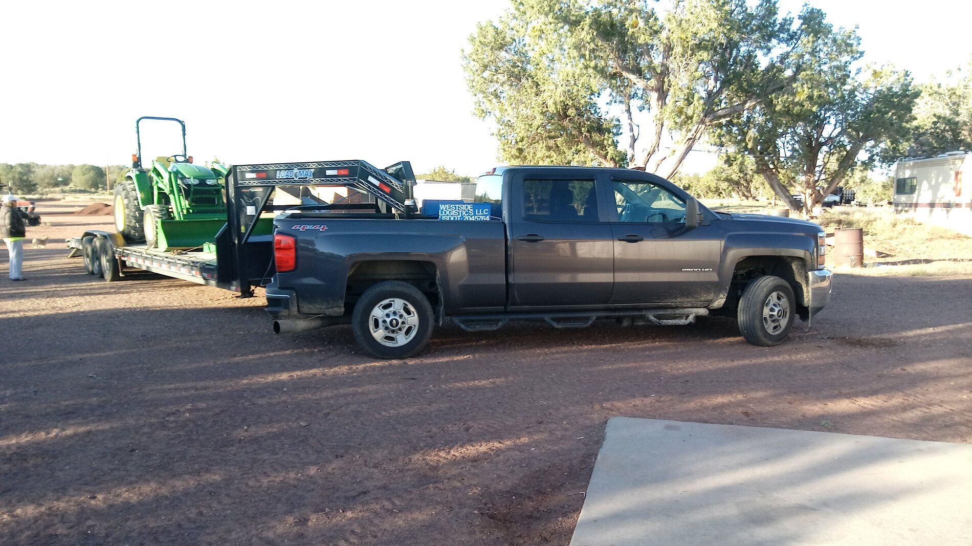

This little guy showed up today on a D-Max:D The guy said he is having good luck with it. He said he has been hauling for 13 years, first truck was a new dually Dodge and got rid of it after 700k miles. Second one was another Dodge dually but used, and it was no good, this truck is doing good.

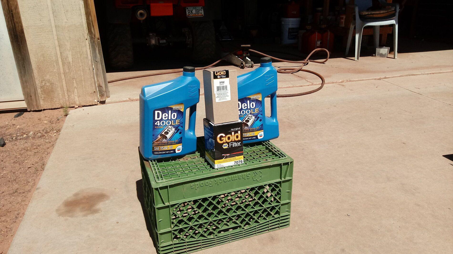

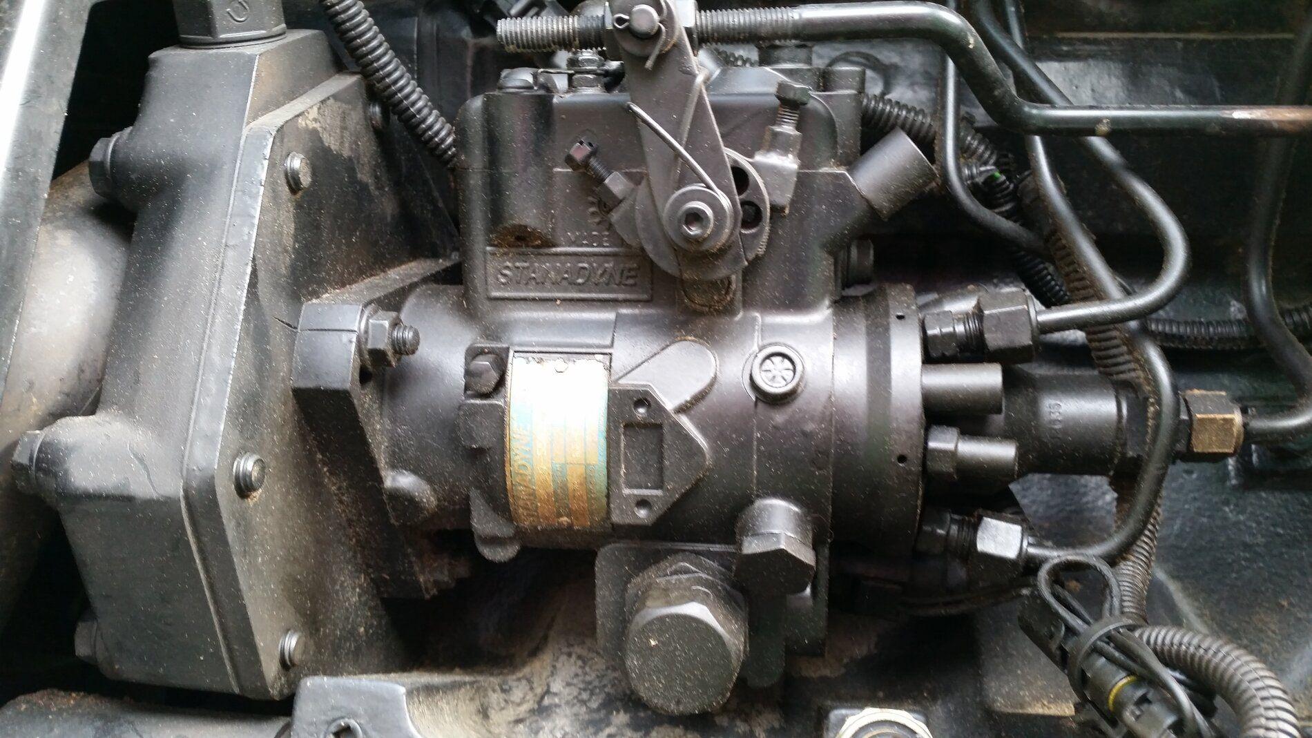

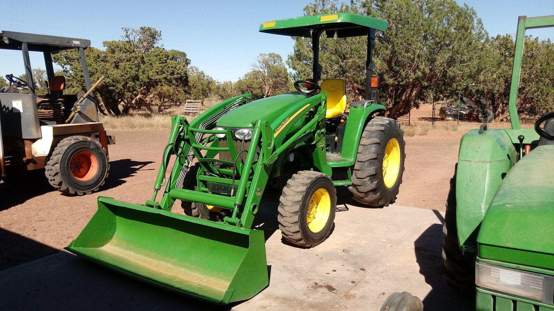

'09 John Deere 4320 with a 48 hp John Deere turbo diesel. It appears to be a common rail with no emissions that I can see. Already did a service on it.

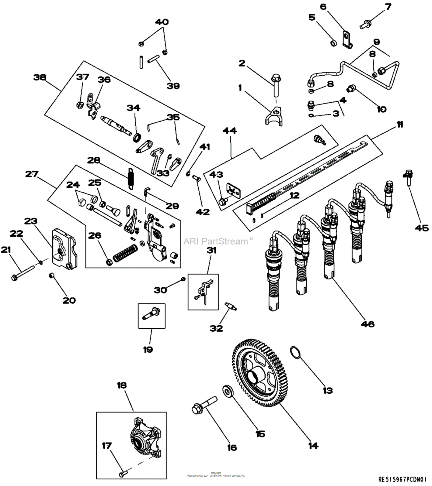

After taking a good look, I didn't see any high pressure pump or injector lines, so I looked in the parts book. It shows a camshaft driven, single injector pump, per injector. What the heck kind of system is that?
Yep, one pump per injector driven off the camshaft and timed with a rack. Really old tech for a newer tractor.
Aside from the mechanical rack, which is fine in my book, a unit pump setup like this is very popular, even today. Mack E7 Etec used it, and I believe Isuzu still uses it. If you consider this the same idea as a rocker actuated, in head unit injector, then all the Volvo/ Mack, DD series60, and many other engines use this tech right up to today as an alternate to common rail.
That's interesting, I had not ever seen one. I am familiar with the Detroit type. It starts instantly, hot or cold, but it seems the rack is relaxed and starts at wide open throttle for a second. That bothers me some. Is that normal?

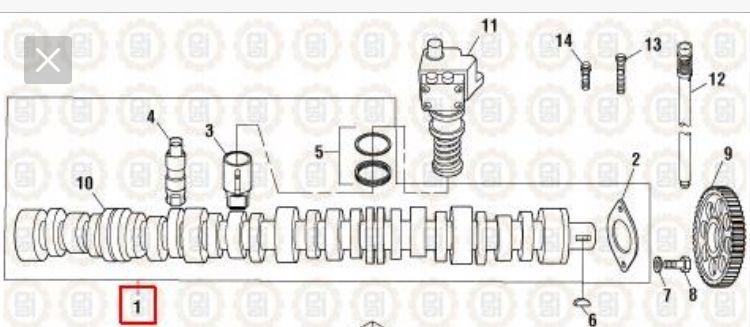

Below is the Mack E7 cam/ lifter/ Unit pump setup. 4 is a valve lifter, 3 is a rollerized “bucket” that the unit pump, 11 drops into. The unit pump has its own eccentric timed to make the nozzle inject at the proper moment.

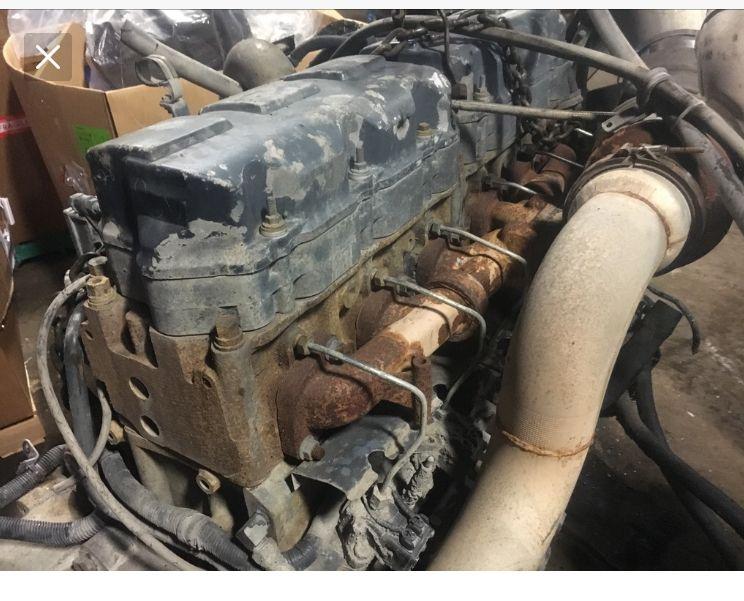

Below you can see the #6 unit pump by the turbo down tube, it has 2 wires on it, and basically acts as the rack. There is a line from the pump to crossover tube in the head, that seats into the nozzle much the way our Cummins engines do.
It’s probably normal. It’s probably how the governor controls the rack.
Wayne, back when Mack was having lots of cam issues, which I have been told were really caused by the lifters, was it valve lifter related, or unit injector related???
Yes Tom, out of the thousands of E7’s we had, Ive seen and heard of these cams wiping out, and the ones I’ve personally seen were the pump bucket rollers failing. When the pump seizes, the 2 hold down bolts act as a fuse and they snap. I’ve changed a few pumps in my time.
