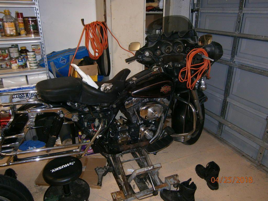

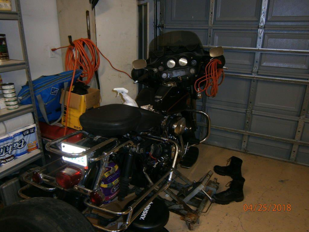

the teeth came off the belt on my 01 recently... amazing how simple a belt is, and how much work it is to replace. ie the primary , the swingarm and the wheel goota come off. when I took it apart the swingarm bushings were gone,and so were the isolators,, I might as well replace the tire as it was pretty well bald so now I just have laid out about 800 bucks into a 2000 dollar bike, and that is my cost for the parts, labor is free.

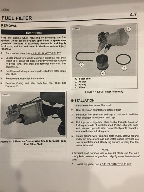

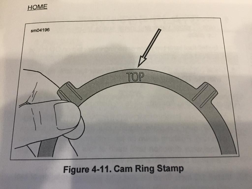

Here is the fuel filter info form the service manual. Watched a vid about changing the "FILTER" the guy completely removed the entire system by disconnecting wiring and two fuel lines. I thought HMMMMM I think I can just pull filter portion out and R&R the filter, it worked!!! I want to join a Harley Forum any advise at to what one would be best???

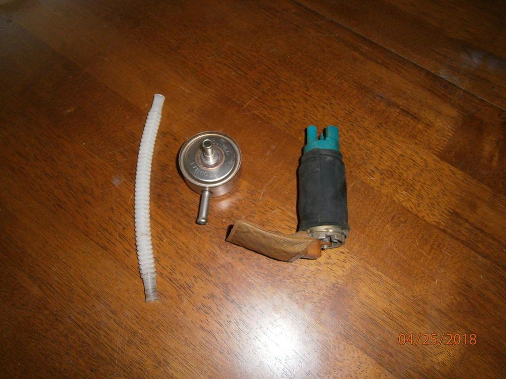

12V, I learned something today... that setup you have is way freaking better than the setup in my 01.. Harley musta had a bunch of complaints about the old setup... it was expensive..
so do they still use those expensive screws to hold the top on the tank?
let me get you a picture,so I have an old marelli fuel pump and filter out in my shed, you should have tried getting it onto the new plastic hoses.

"so do they still use those expensive screws to hold the top on the tank?"
No they have a locking ring. There is a rubber gasket you replace at the same time similar to the one behind the Derby cover. Special tool for about $35, looks like a hand held magnifying lens without the glass cheaper than the HD tool.
