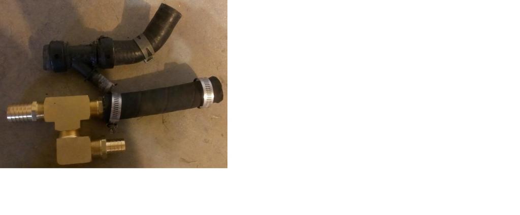

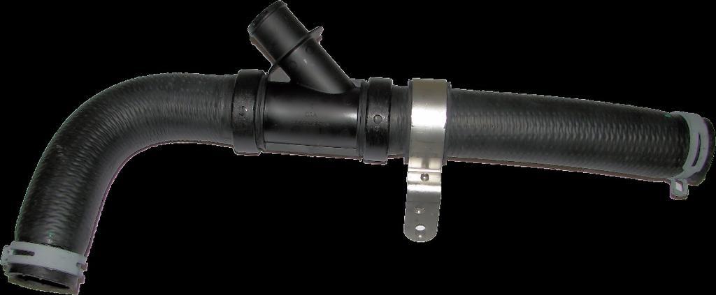

ANYWAY...go to my destination and dropped off the trailer. Airing my tires down a couple PSI, I smelled the coolant smell again so thought I ought to check it. Opened the hood and I had coolant all over the driver side of the engine bay! I looked and found that the PLASTIC y-pipe on the upper radiator hose had cracked and was dripping coolant. The overall level was still in range and I know the truck didn't get too hot so I feel lucky.
Has this happened to any of you guys? It seems like a somewhat common problem on a 13-14 MY truck. I have MaxCare on the truck but he says hoses aren't covered under extended warranty but since I only have 35,900 mi., it's covered. Is that right?? Especially if this is a known defect/issue with the part?

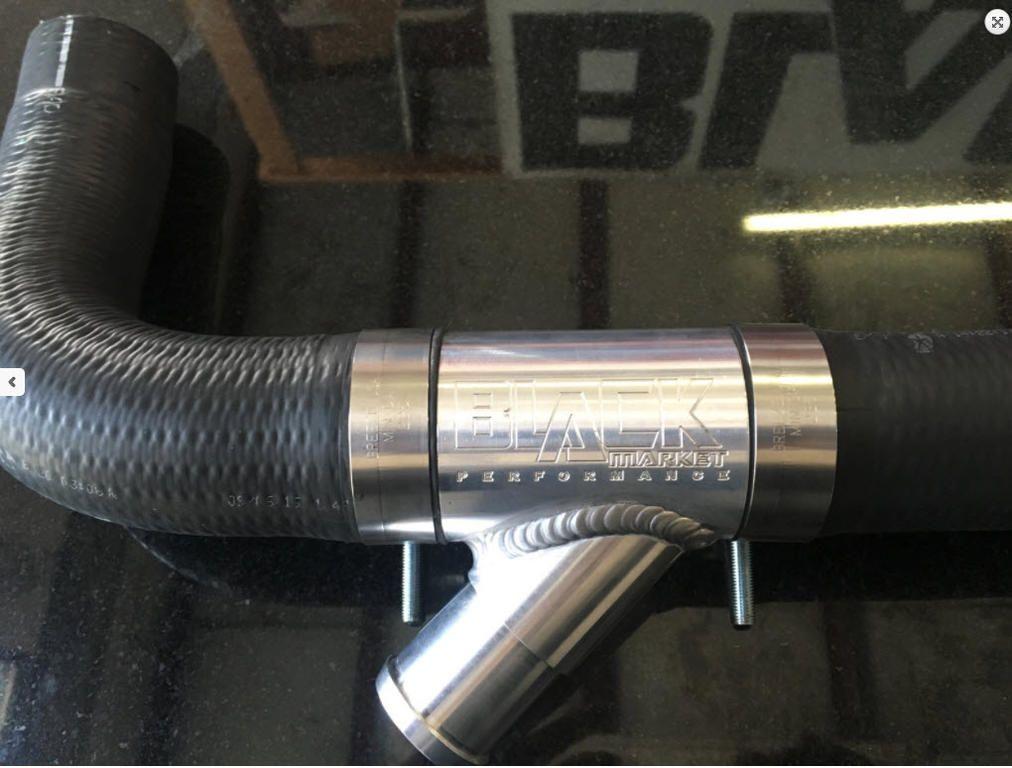

I have since ordered an aluminum replacement part that I will swap out as soon a I get my truck back. I can't play around with a weak spot in my cooling system in a truck that I to with! Anyone else bought an aftermarket replacement?
