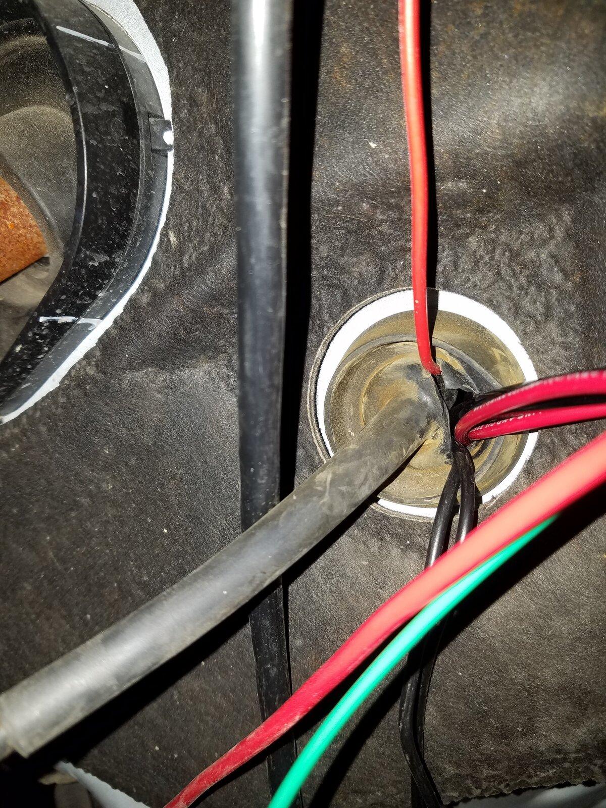

My access in and out of the cab is penetrating the parking brake grommet on the firewall. Used a utility knife to slit it.

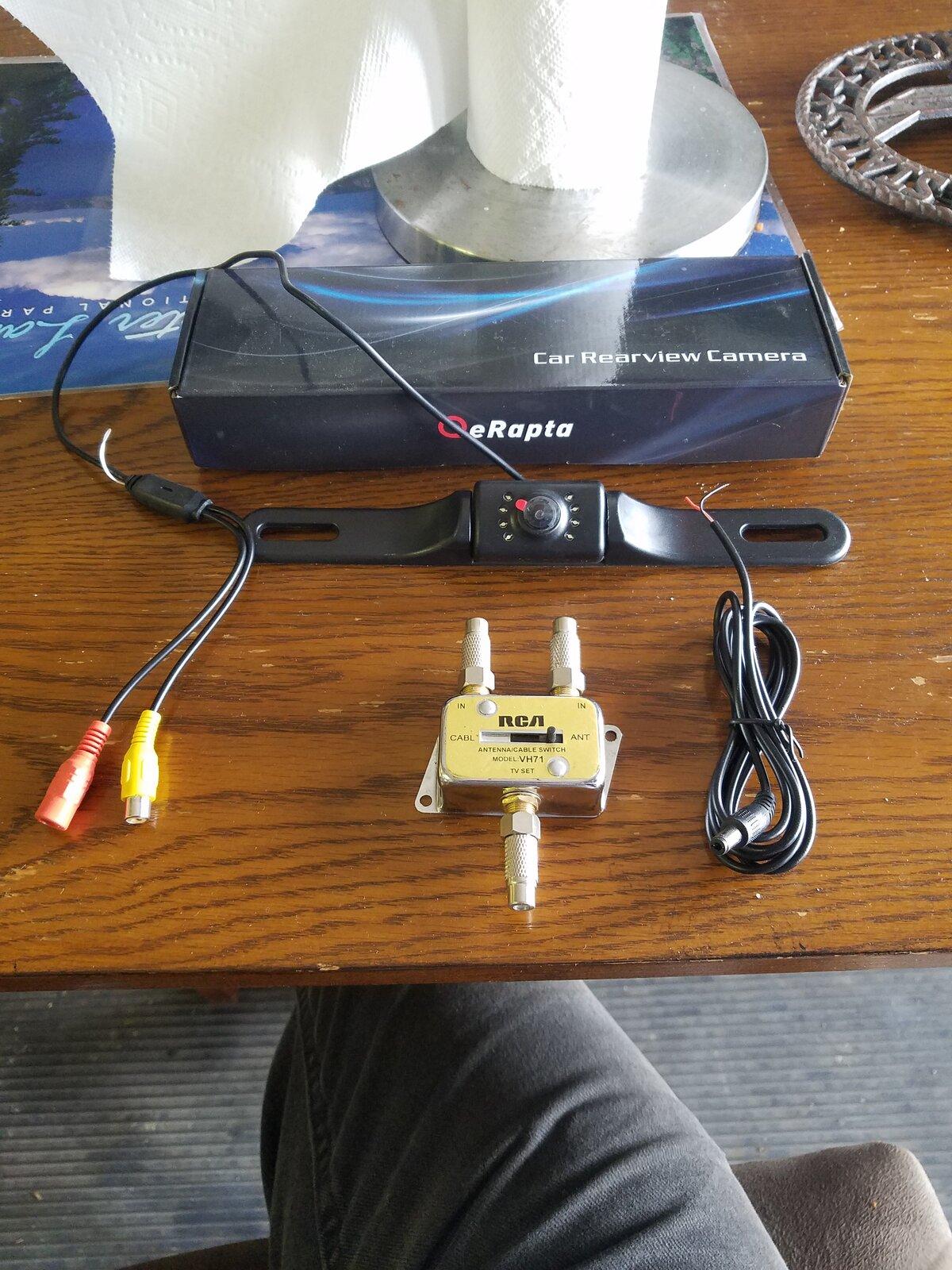

Here's what I'm using.

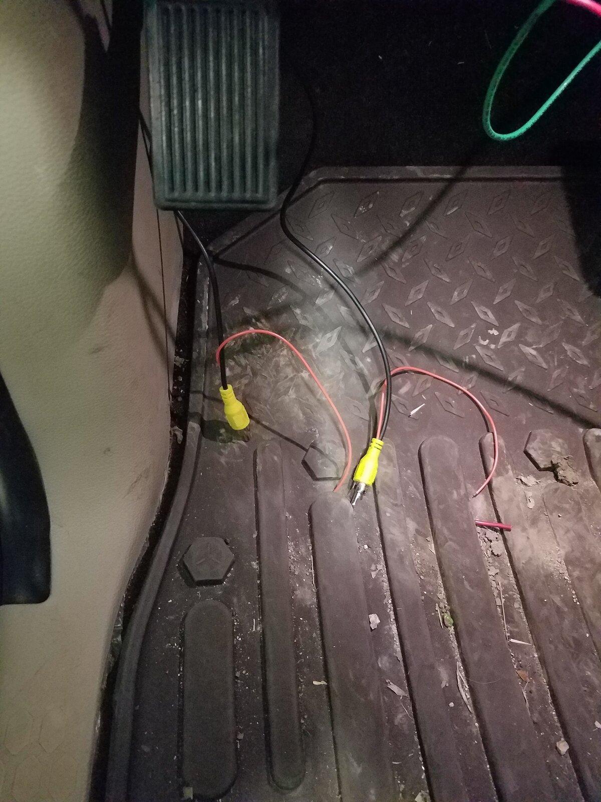

Here are video plugs from the cameras. I will feed one video lead up the A post to the CST2 RCA plug and mount video switch right under dash to the right of brake release.

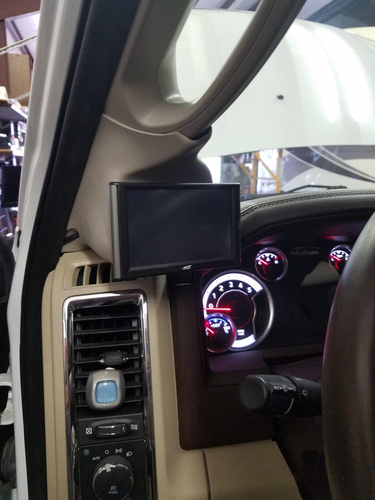

And here is the target, the CST2

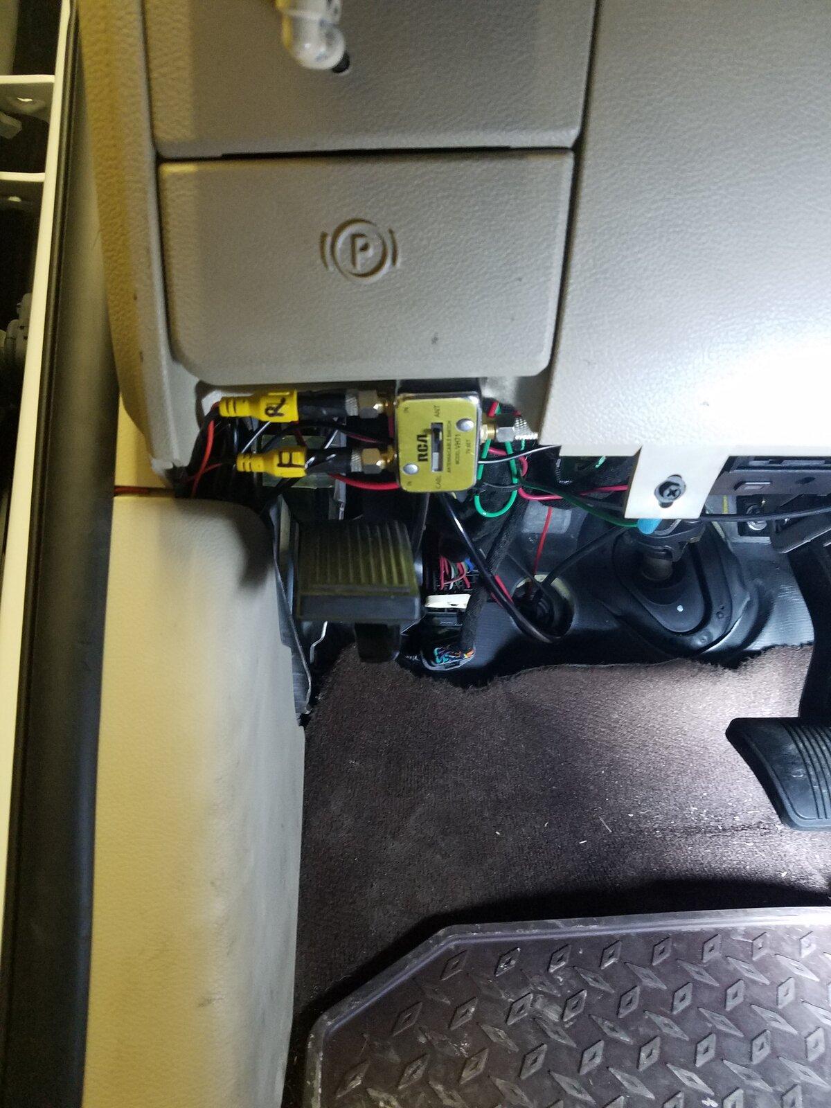

Video switch in the cab to switch from front to rear. This is view from floor... you cain't see it sitting in the seat.

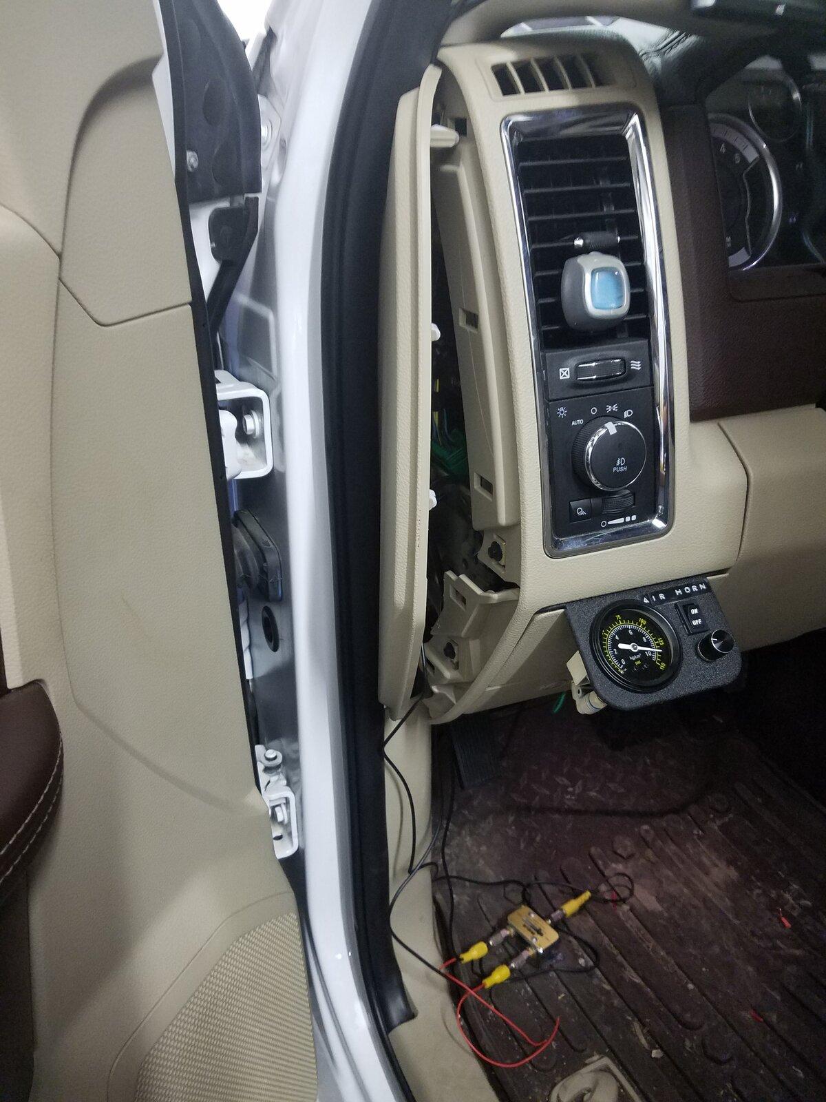

Here's where I popped the side of the dash to run the double ended RCA cable from the CST2 to the video switch.

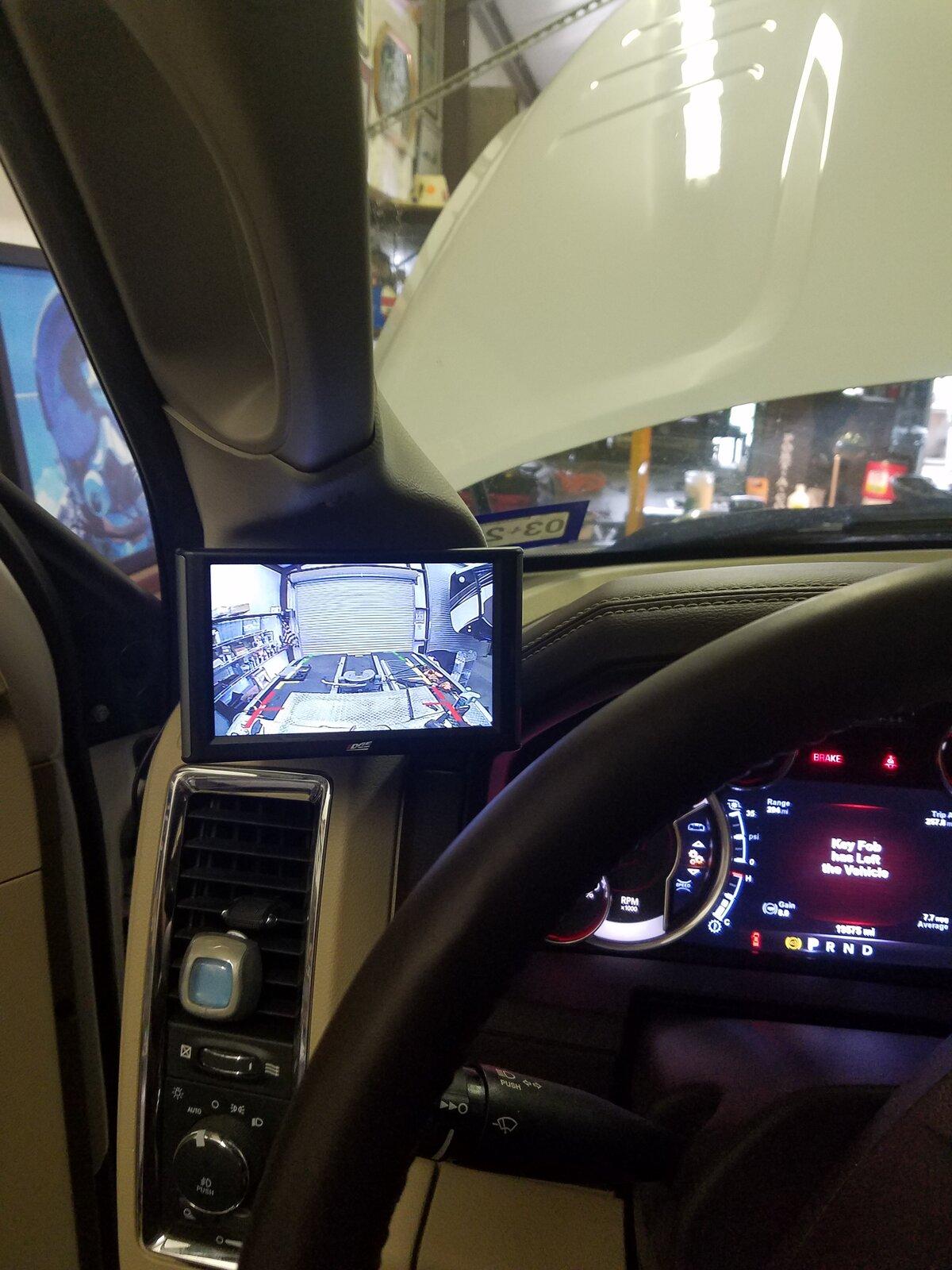

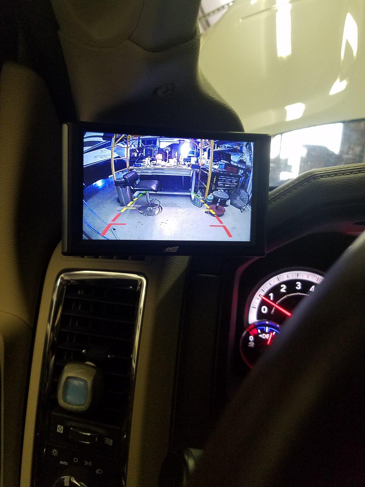

Here's the camera working. BTW, decided to connect both cameras to Aux Sw 5 versus running lights or Aux Sw 4 CB/ACC.
Not bad for $30 each for the cameras at Amazon versus $179 from Edge. I can't reverse the view. but the view like looking in rear view mirror works for me.

My 2019 has plenty of cameras, so no need of installing more. But where did you get the pillar mount for your CTS2? I want to install one there as well, but do not want to get rid of the handle, when replacing the pillar for the CTS2 pillar mount.
Amazon. google edge pillar mount to find best deal... got mine for $60 but saw them for up to $80.
