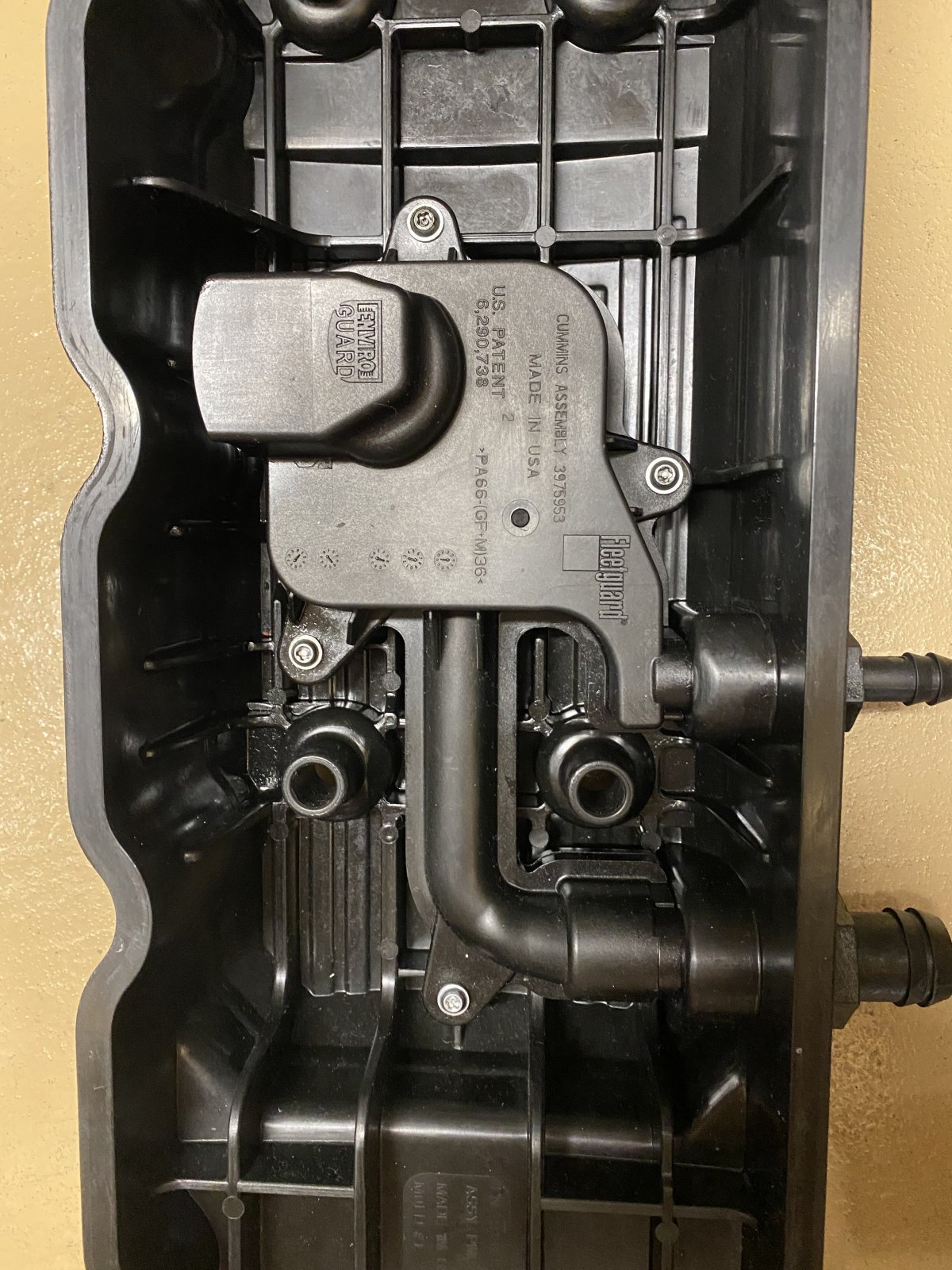

Just to be clear, the air/oil separator on you 2006 is different than the 2005 and prior 3rd gens. It is attached to the underside of the raised portion of the valve cover. You have to remove the valve cover to get to it and it is attached with security torx screws. You can get the security torx bits off Amazon cheap. I have never seen where you can purchase this air/oil separator independent of the valve cover making replacement very expensive. I checked with the dealer (Mopar) and Cummins. I cleaned mine during my rebuild and it flowed freely. If you have no blowby or excessive oil coming out of the larger of the two fittings through the atmospheric tube you likely don't have any restriction as Ozy stated.

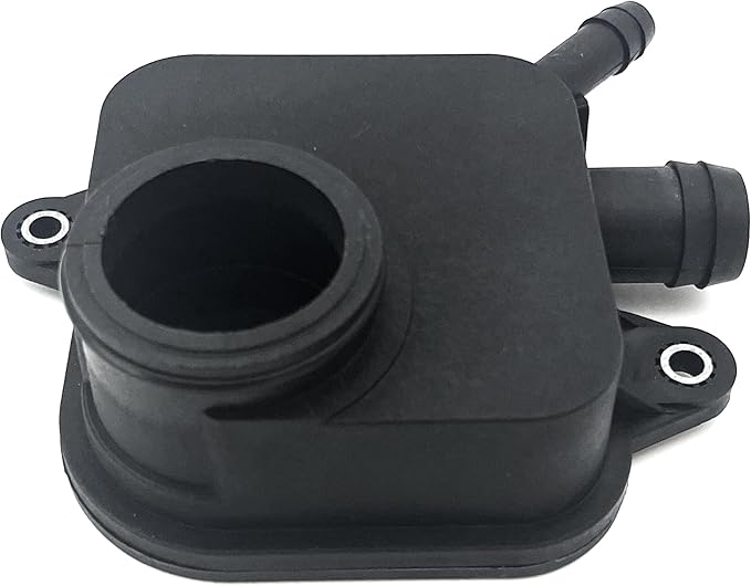

This is what the one for the 2006 looks like. If need be, I do own the "Security " Torqx Bits. I had to by them many years ago, for another vehicle, maybe my 1998 Wrangler. Silliest thing I've seen made. At the time, they were a PITA to find.
That looks like the 03-05 version.

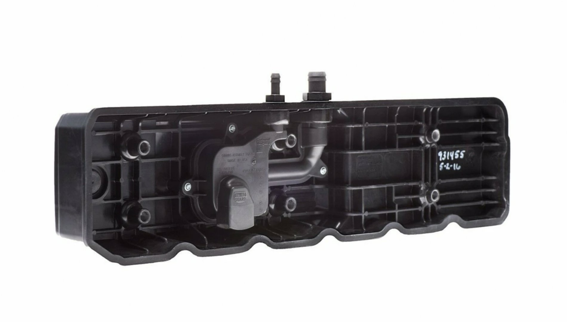

The 06-07 5.9’s had them integrated into the valve cover, which is listed as a non-repairable item and a new valve cover must be purchased.
Maybe someone has figured it out since I last researched it.

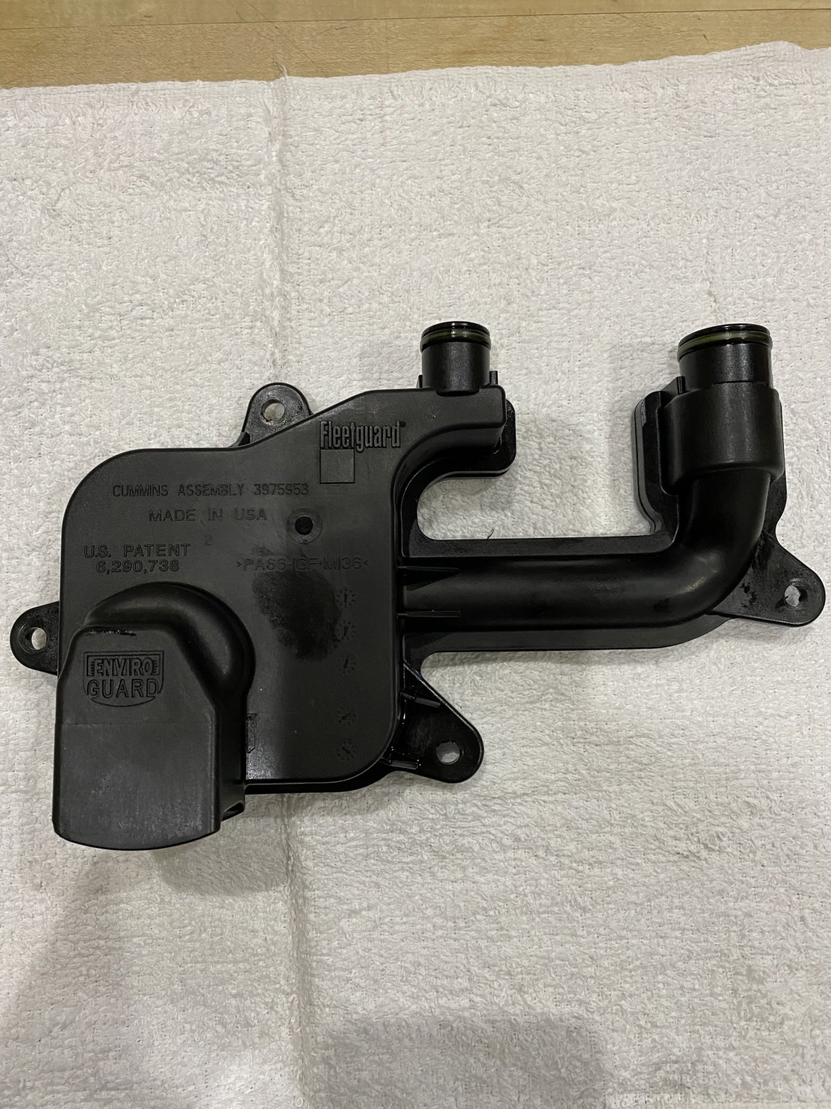

This is what I recall the 06-07 5.9 being. It’s similar to the photo above, but not the same.
That's what my 2006 looks like. Four security bit screws attach it to the underside of the valve cover. Note the O rings on the protruding ends.View attachment 142443
Thanks guys. The one that comes in our 06 looks completely different than the ones that they are out there selling as 06's.
Now I know.
I still can't see why that would cost $150.
