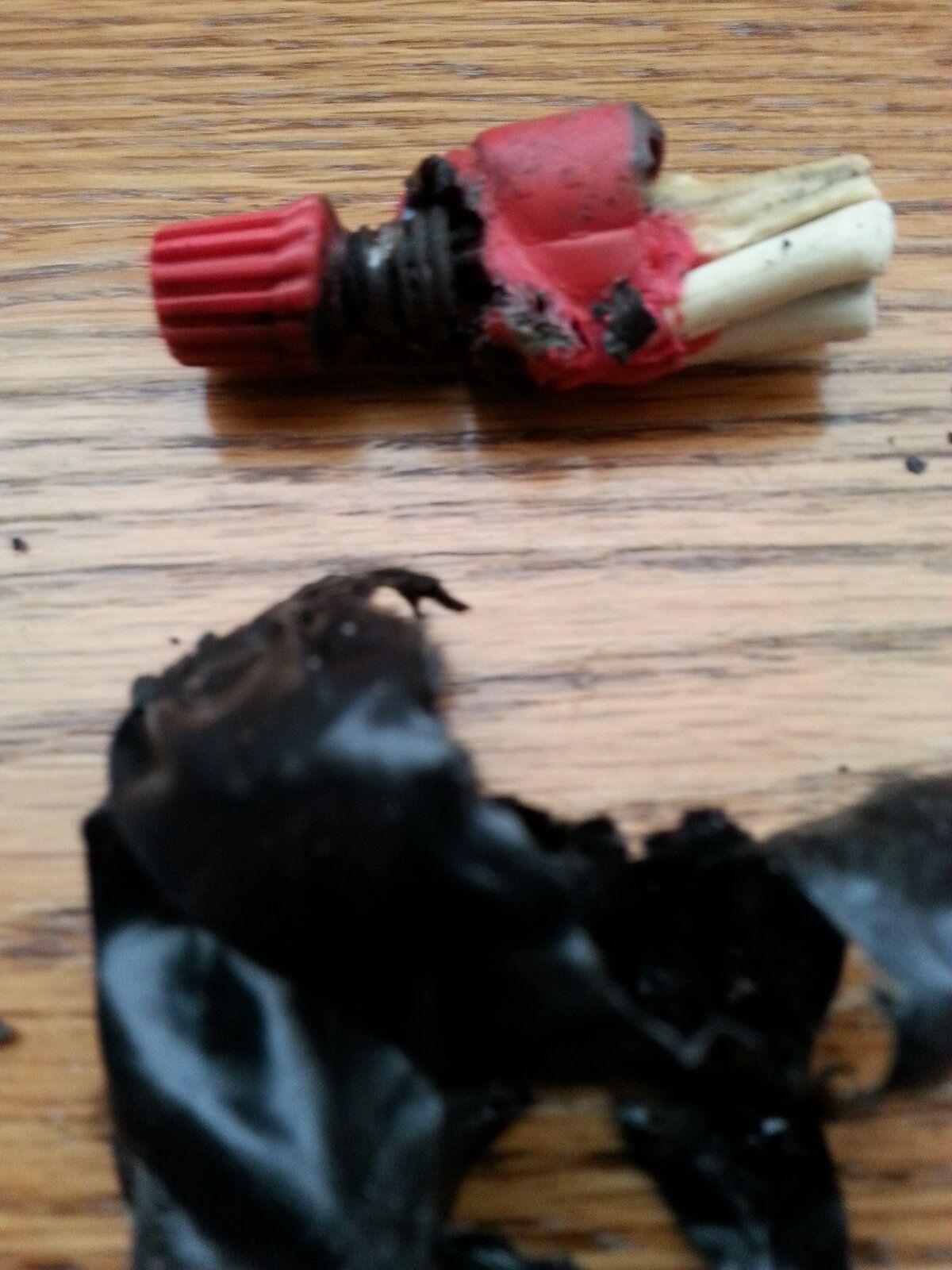

Not part of the brake discussion, but marginal wiring and connector caused burnt wiring on the generator that could have burned the RV up. Cummins fixed it and Heartland paid fo it.
Cheers. Ron
