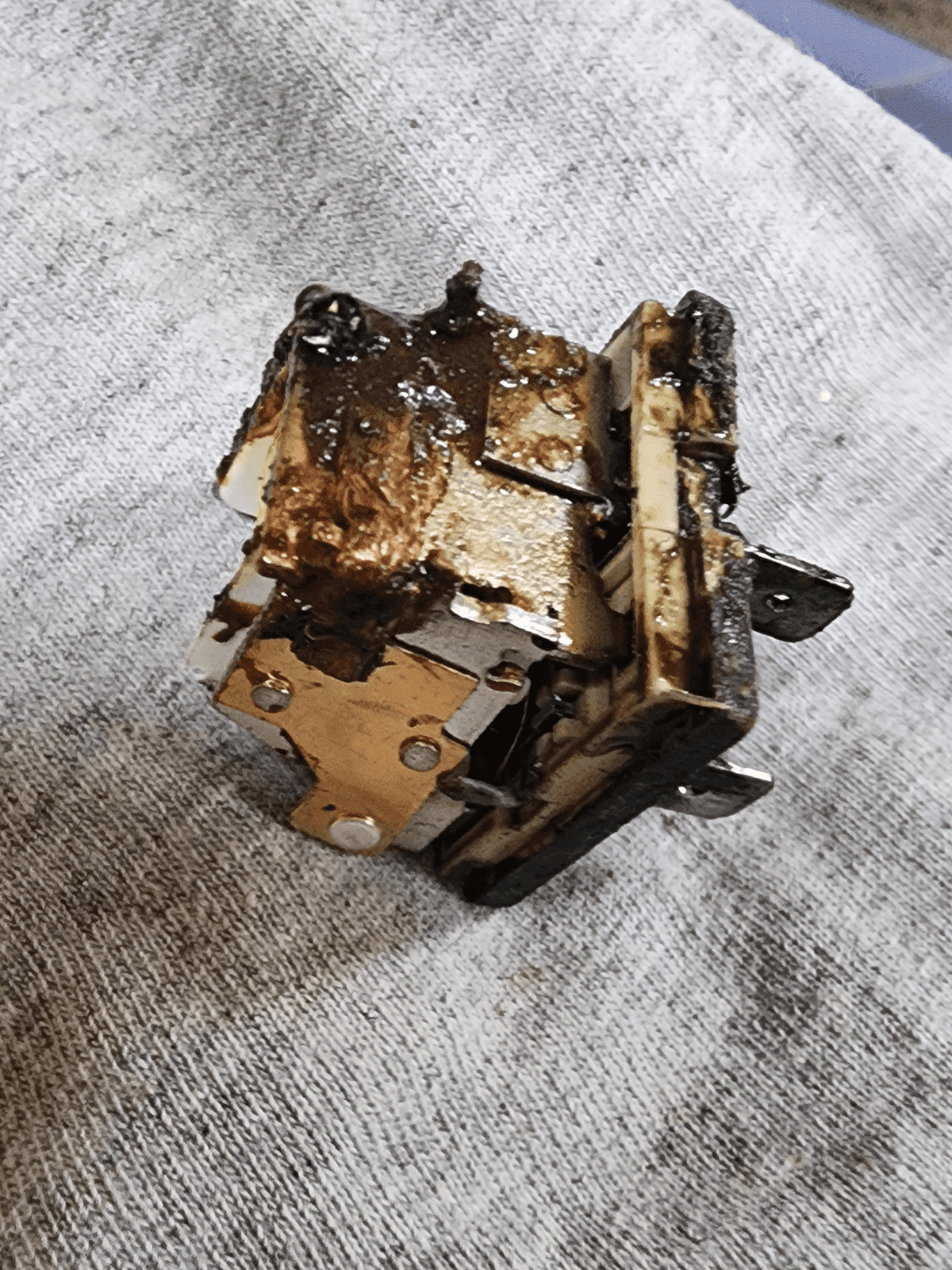

Originally installed my FASS150 in 2007.
16 years of service.
Probably 8 years ago it quit.
Long story short I put a new motor in it but it still didn't work.
It was the relay.
Fast forward to today.
Pump won't shut off when I shut down.
I think the relay is stuck.
That's today's task.
Well that was it...
