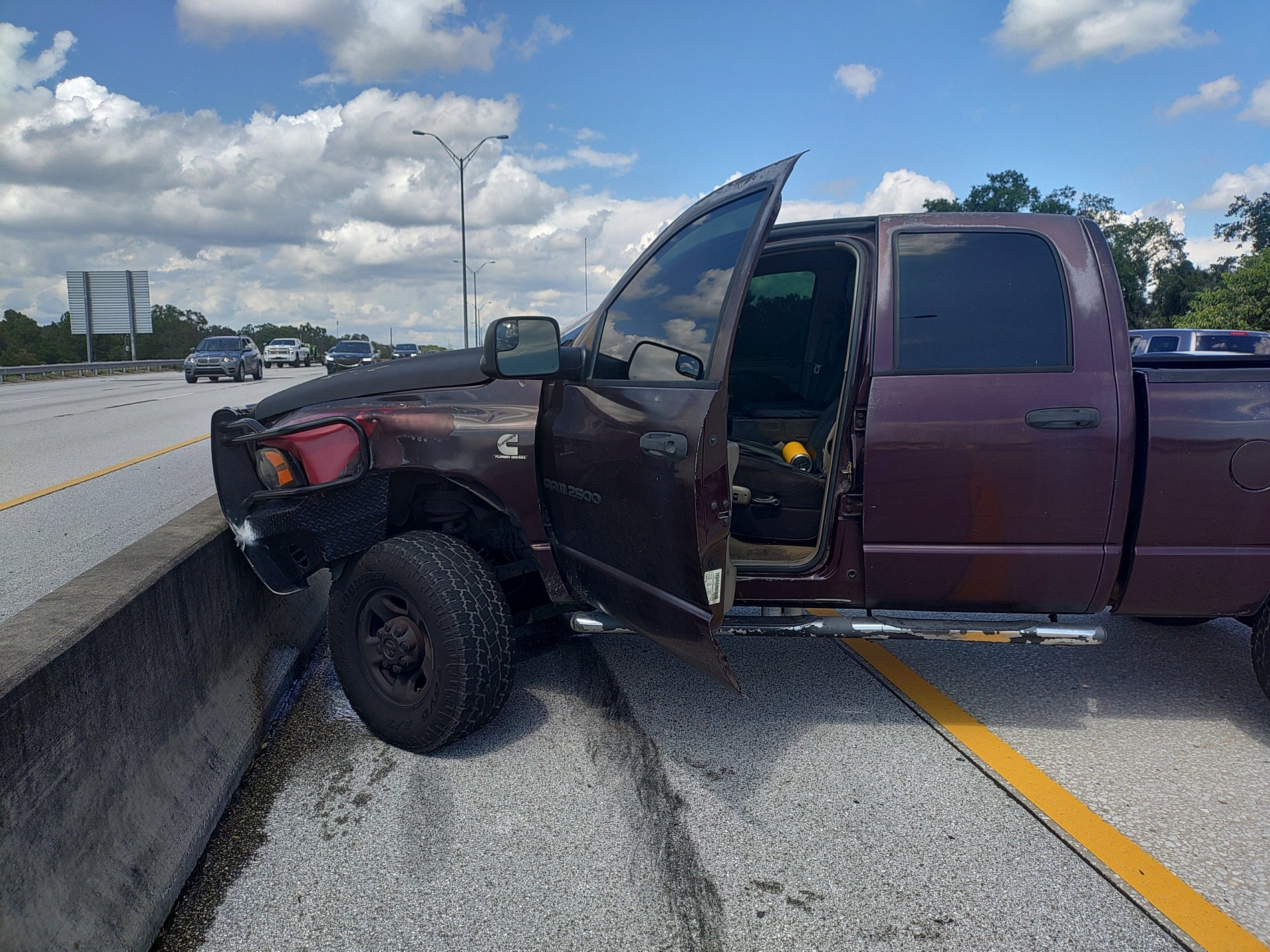

1) Rumor has it there is an upgraded 2004.5 2500 likely going to auction soon with accident damage that's cheaper to fix than engine + injectors + transmission.

4) As you just found out insurance isn't going to cover a new engine cost in an old pickup let alone the rest of the cash you have to dump into it.
