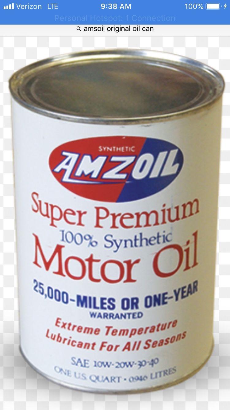

AMZ/OIL right from the beginning touted one year oil changes.

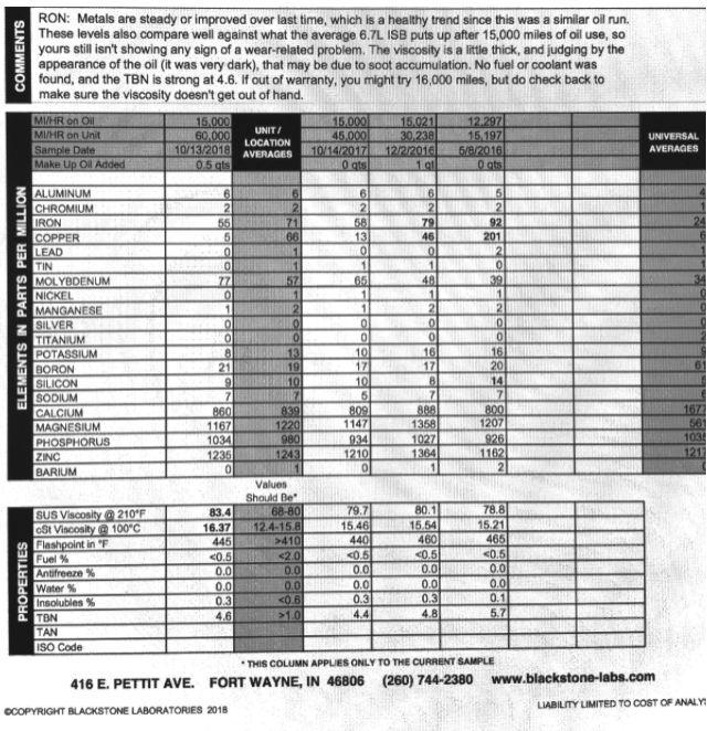

Here is MY proof that 15k changes are just DANDY!!!
We are both named "RON" and we both tow a "DRV" should mean something.

I know, I have been told many times, but what is the benefit of this Amsoil for "YOU", is it the once a year, its not a cost benefit, probably costing you more , plus adding the analysis . I'm guessing that Ram will never see 100K during your ownership. Pretty sure I know whats coming, but just curious anyway :D
Unless the new HD's look different than what I have seen so far I will be keeping my 15 for some time to come.
I do the analysis mostly for fun to see how things are doing. Now I do know by doing so my engine is doing VERY well compared to the average 6,500 mile change. So I have confidence by keeping my truck for the long haul it will last a long time based on the test results.
Also when the time comes to sell I have a record to prove the condition of the engine and will fetch more than the cost of the tests.
