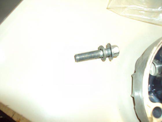

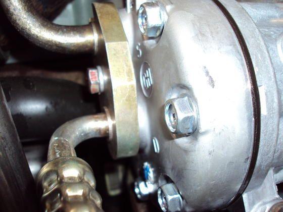

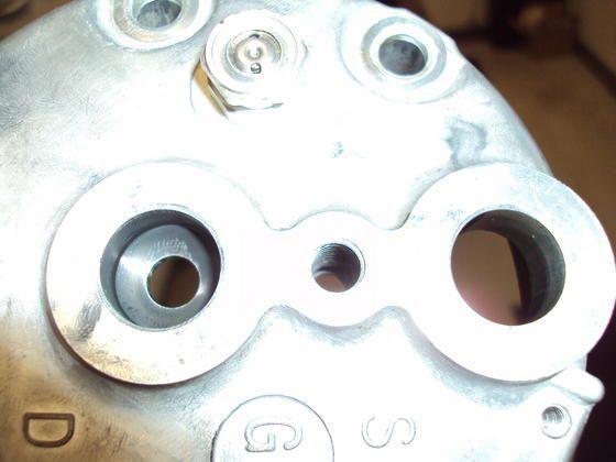

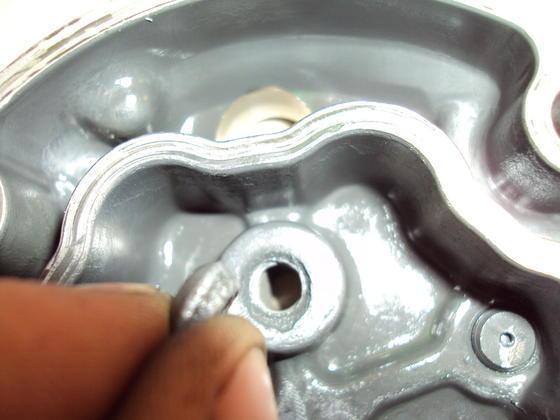

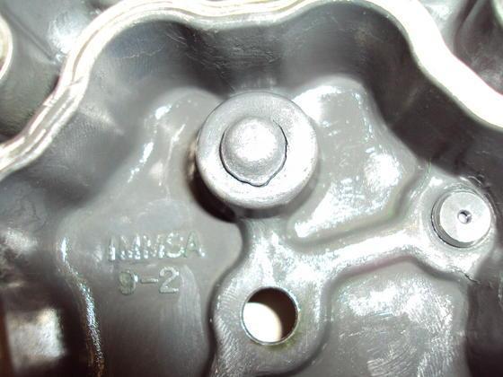

truck originally had the A/C quit about 2 weeks ago, I drove it over here and did a visual inspection and found the compressor clutch burned up. The other guy here just went through our company a/c training so I had him look at it(he's actually supposed to be our truck fueler but we are a 2 man operation right now so he is in the shop 80% of the time). Anyhow I wanted to see him diagnose it, and try to get some use out of his training while it was still fresh. So he replaced compressor and drier and problem with blowing out freon started, it had most of a full charge with the original compressor. Anyhow after happening a few times he replaced the compressor again as we thought maybe the relief valve was defective. I noticed at one point that instead of reusing the torx head bolt to hold the lines to the compressor he had used the bolt that came with the compressor holding the plastic caps on it to seal it. At the time I just figured he dropped the original bolt and couldn't find it back. When the 2nd compressor locked up I figured it wasn't a compressor problem and put the first replacement back on. I checked to make sure the bolt would go all the way in by hand and it did, I was thinking it might not be getting the lines tight enough before it bottomed. I also added a lockwasher to it just in case at one point. I was still suspicious about that bolt today and even more when I noticed a vacuum hiss as I took the bolt loose. Here is what I found:
The correct bolt should only be about the length of the threads on this one that comes on the compressor.
Notice how you can see through the bolt hole between the line ports.
I can't believe after all the time that was spent watching this thing here in the shop not even a hint of a leak showed up. Every time the truck went out the a/c wouldn't last 5 hours and it would have freon sprayed all over that side of the engine. I am going to have a bruise on my forehead from slapping it!
