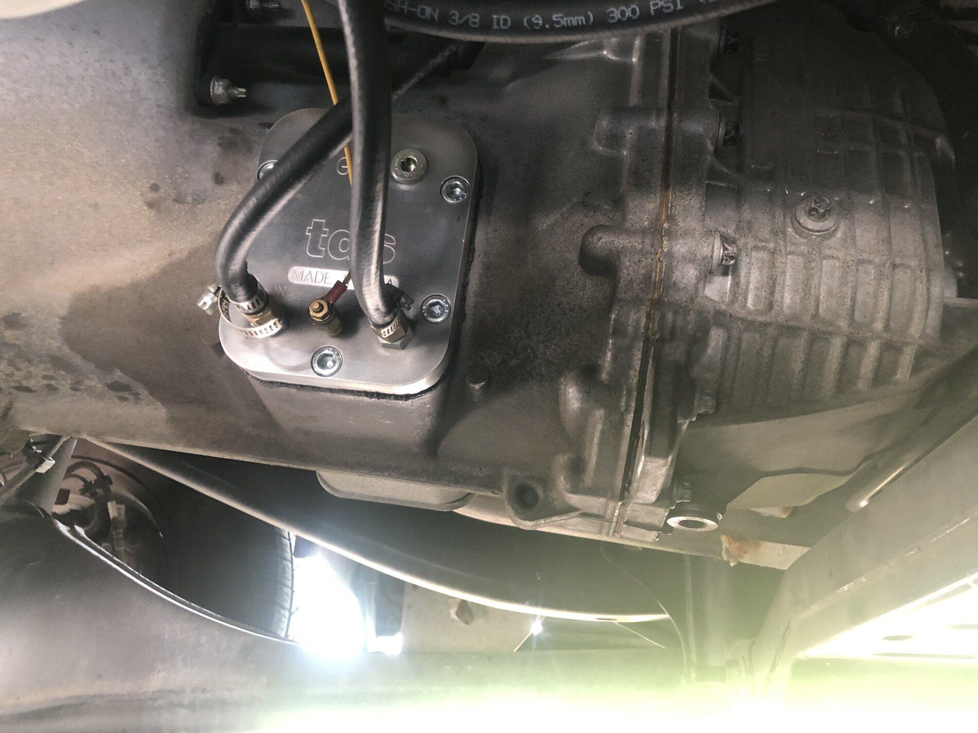

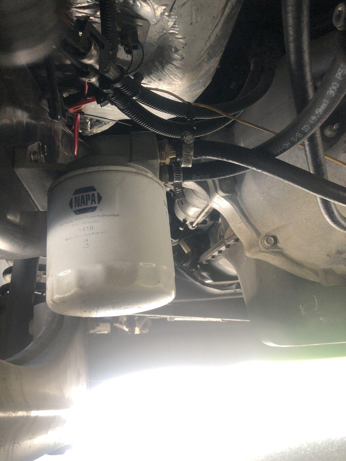

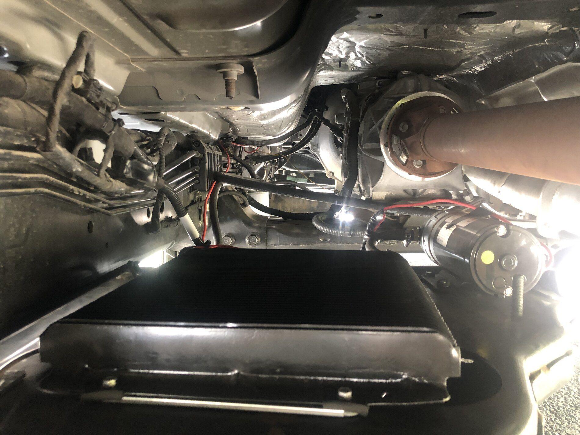

No slippage, can’t recall if noise is still there with clutch pedal press to the floor. Transmission already has Castrol syntrans 75w-85 I switched it over before I started hauling heavy. Also added a cooler with fan, filter, pump to circulate and cool the oil. Made a big difference, before oil would get over 200 degrees now it sits around 150 highest it’s gotten was just under 180.

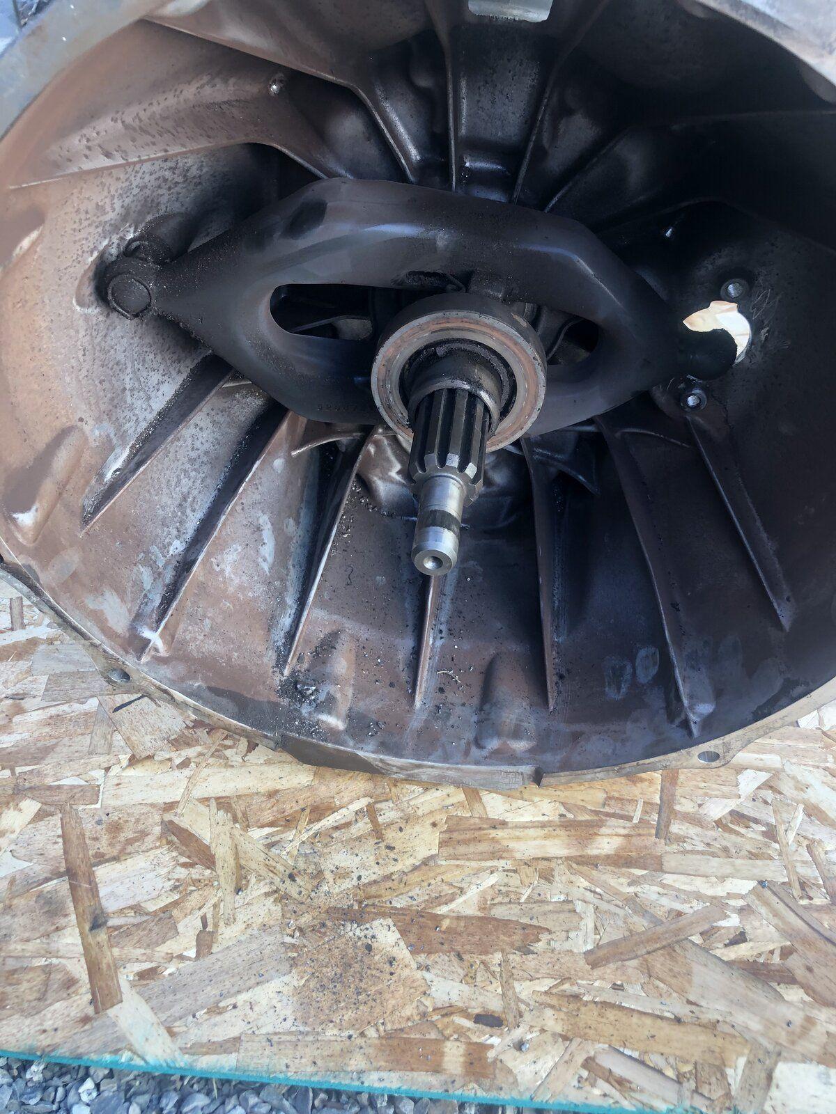

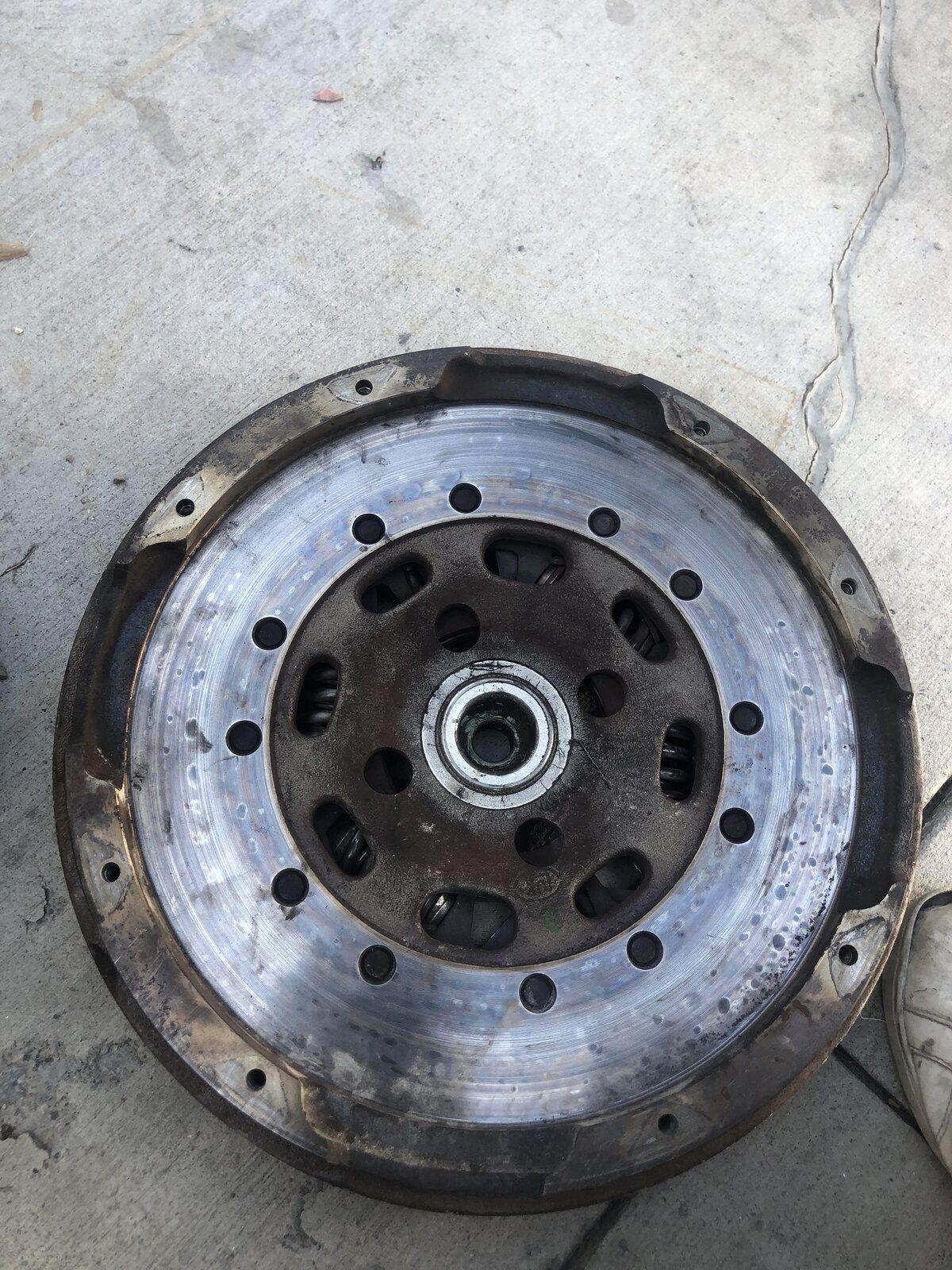

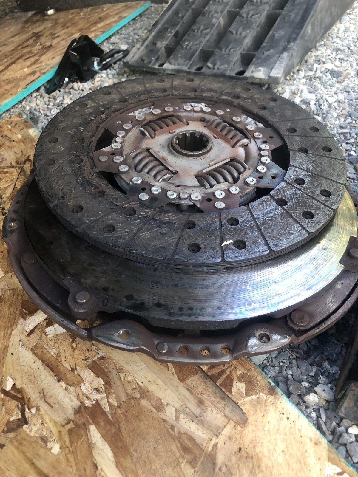

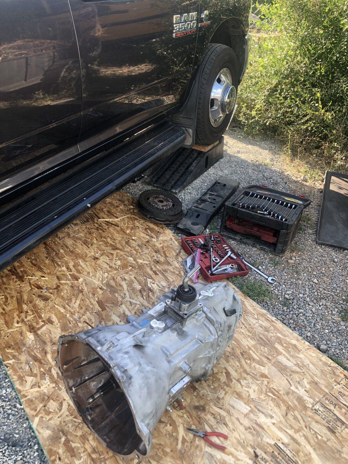

So got the transmission pulled. Definitely a problem with the dual mass flywheel. When I shake it or spin it, it makes noise like pieces of metal are moving around in it. Also found bites of metal in the bell housing of the transmission (clutch area). Oh well once I get a proper clutch and flywheel in, truck will be ready to tow heavy. I was impressed with how the truck pulled grades even loaded around 28k lbs and loved the fact that I hardly needed to use the breaks going down (exhaust brake). Still need to figure out which clutch material I want to go with.

Nice work....that said, I just gots to ask...
Are those PLASTIC ramps the frony of your truck is sitting on ??
And if so, what are they rated for and who makes em??

They are actually rated for more then the metal ones. They are reinforced and actually built pretty sturdy. I didn’t have any doubt laying under the truck and even jacked up the rear end to get the transmission out from under the truck. I like how light the g56 transmission is compared to the nv5600 we recently swapped into my buddies 12 valve. That was a heavy b!tch.

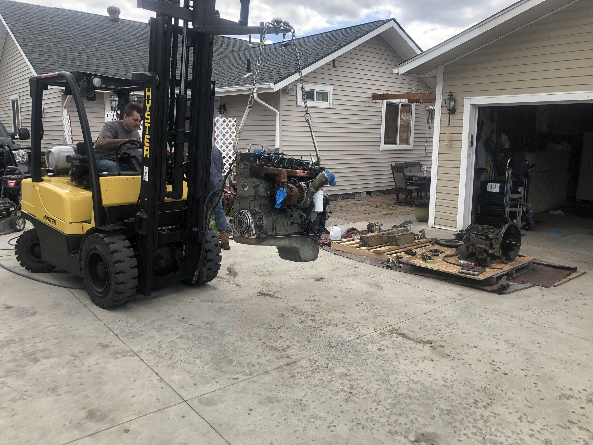

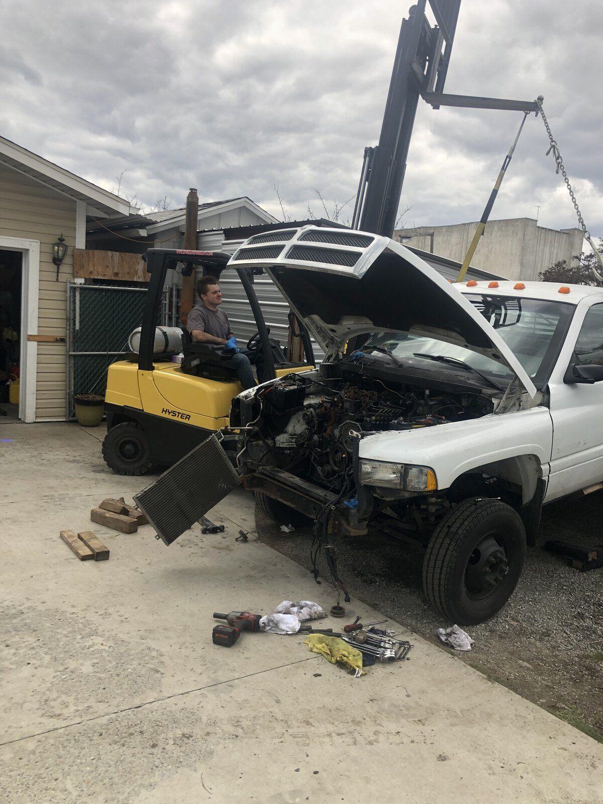

A little off topic but here’s some pics of doing a swap from a ford school bus after the kdp took out my buddies original 12 valve. Was told by the previous owner it was tabbed. Should have spent the hour to check. Lesson learned. On the plus side the school bus motor came with a Enton fuller and sae2 bell housing

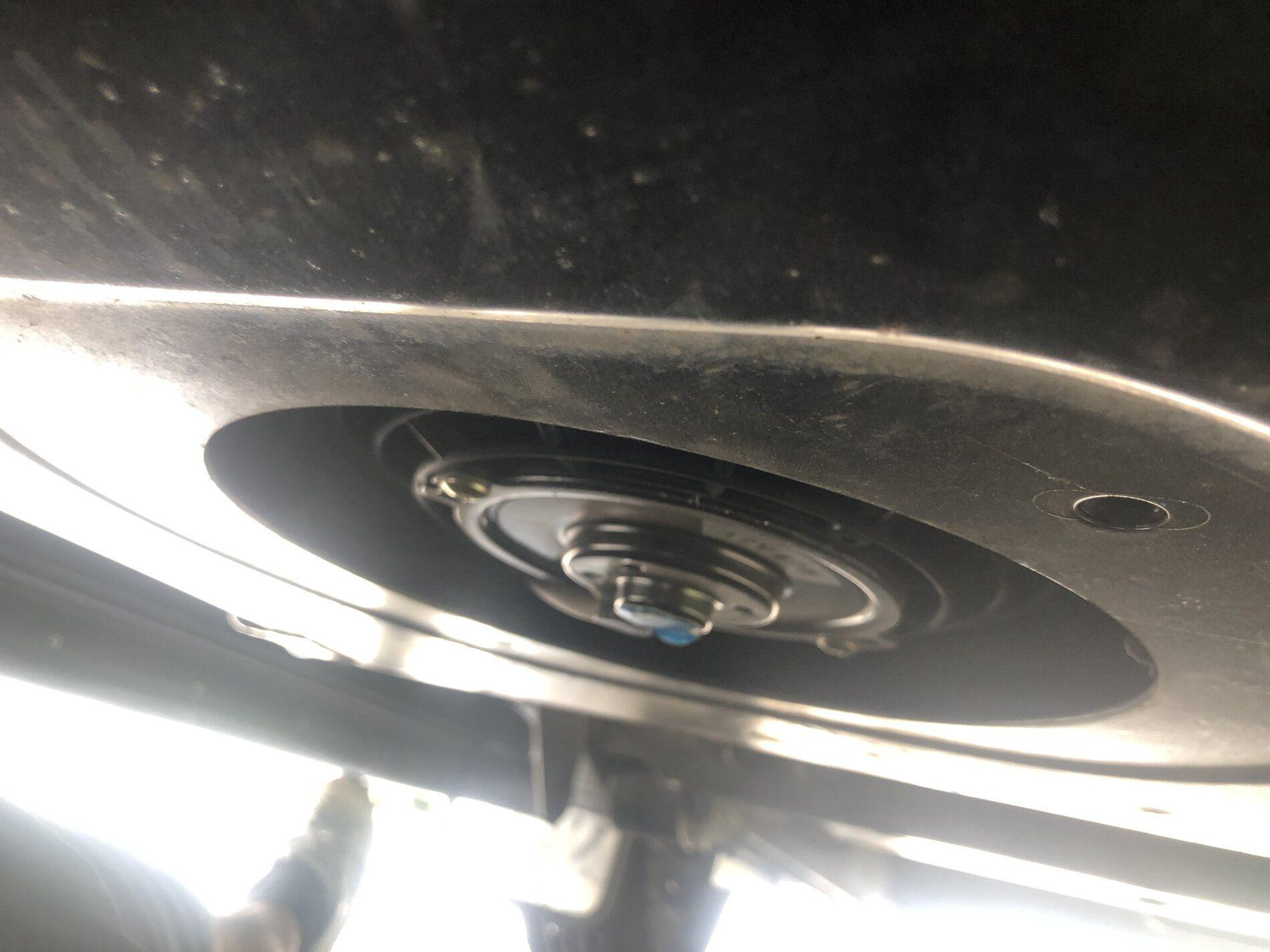

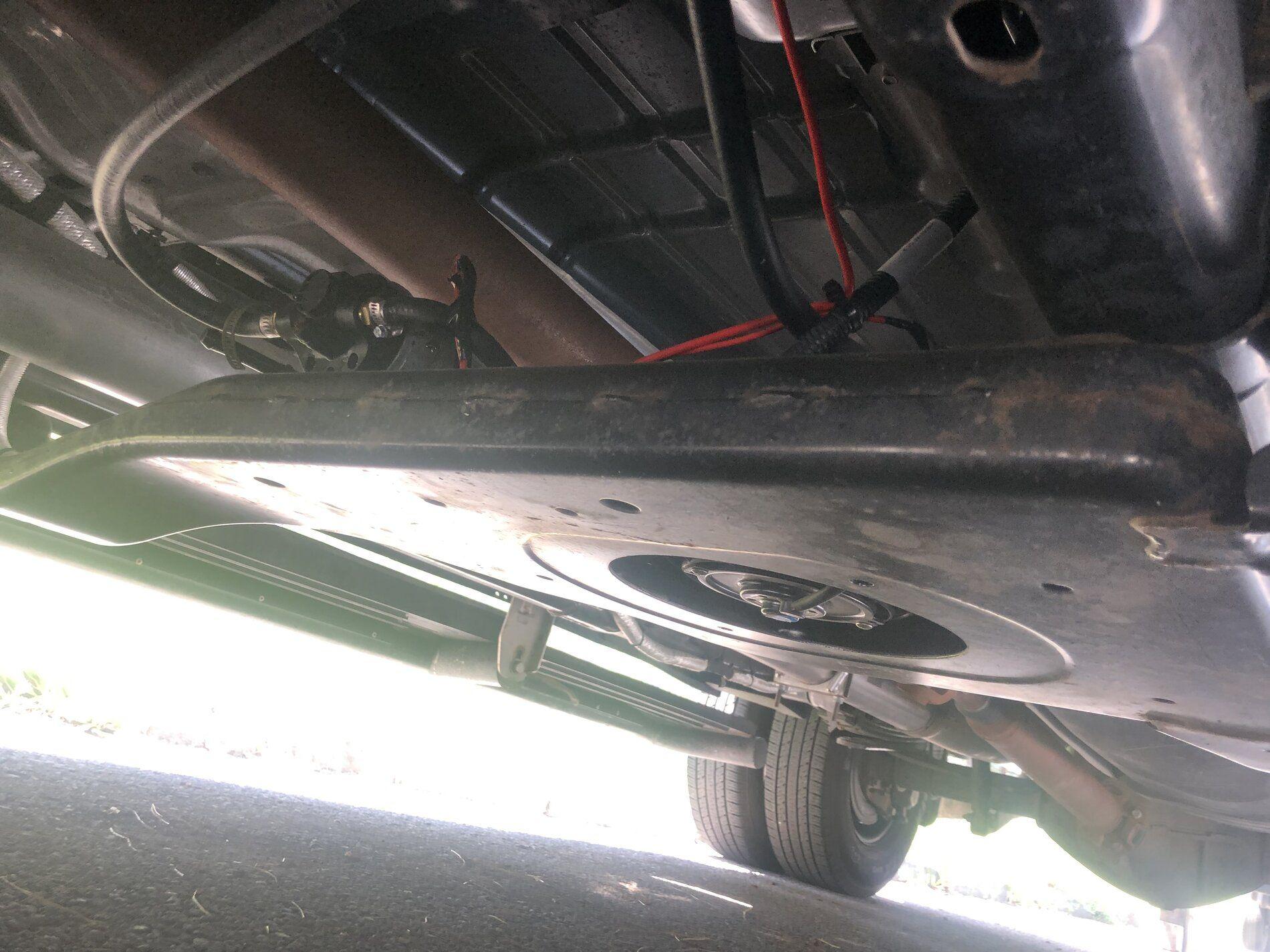

I know where your coming from, but many members here claim their G56 doesn’t get hot, with my 50wt and only 15K GCW it got up to 250*. I also developed a trans cooler, can you post some pictures?
Pics haven't shown shown possible cause for failure to release that I can see.
Something is definitely wrong with the dual mass flywheel. Like a said it makes noise moving it. Also you can see some damage on to the springs in the dmf. Transmission seems fine, no main bearing play trying to move the input shaft front to back. Also fluid drained from transmission seemed clean. Inside transmission looks good to.
I’ll posts pics of mine when I get to my Cruise Ship, I’m just north of Anchorage at the moment, in route to Seward Alaska, I have a pump, filter and use the OEM auto transmission heat exchanger.
Got the dual disk in. Truck is shifting, really not that loud with the dual disk and single mass flywheel. Went with the organic, should have gone with the ceramic I think. Pedal feels as soft as stock. Anyways really happy all it was is the dual mass flywheel. Thanks for all the input.
