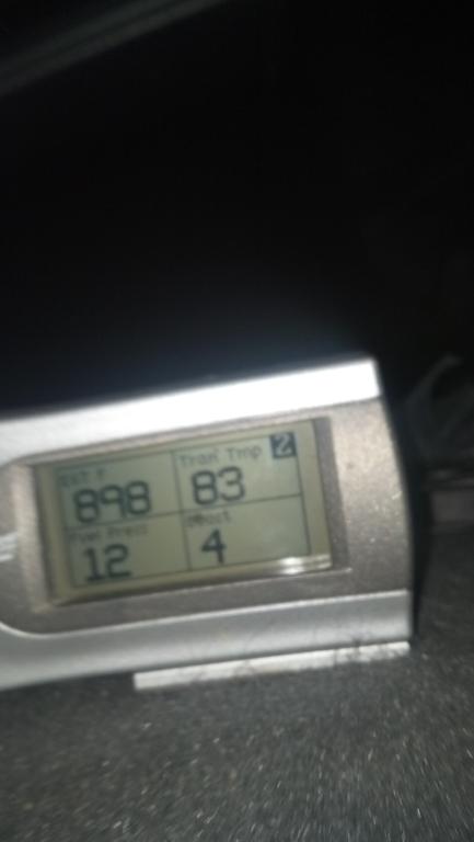

I've had auto meter really like them my new truck has edge juice with attitude . It has fuel psi egt boost and fuel psi all visible at one time . I would get a fuel psi as the main thing if your goina get them one at a time

If I was looking at a new tuner/gauge combo I'd be looking hard at the new Smarty. They keep promising some form of UDC in the near future which would make the deal all that much sweeter.

I planned on getting a smarty, but I like the analog meter setup too. Im going to get the transmission done first, while its out I will do the fuel mods, then turbo/exhaust/brake/ injectors and whatever else
