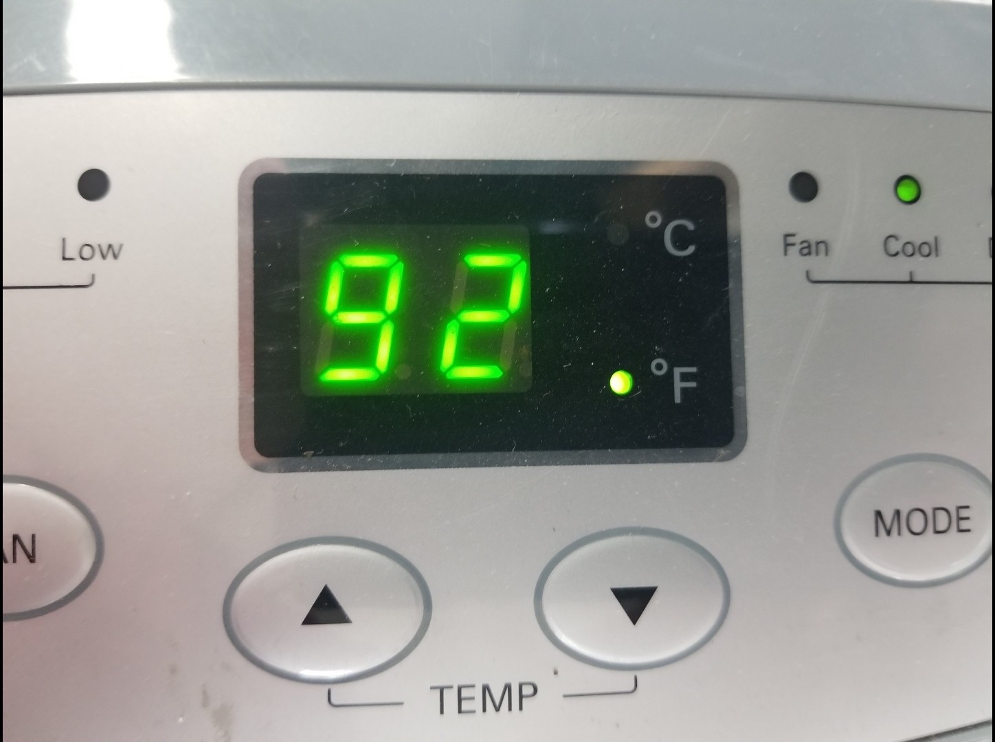

Come down out of those mountains over to Nashville. It was 92* at my desk today…..
