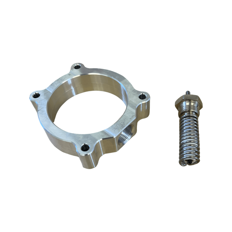

Black Market now also offers an air horn with egr ports and provision for the DIH4 grid heater.
Thank you, Mr. Donnelly,
I went and looked at that. I’m wondering now, after adding the intake plate, air horn, and heater, if the Banks kit comes at a good price point. I have it priced at $968 for my rig, with raw coloring.
I am wondering as well, is there benefit in the air horn upgrade if I am not putting any further upgrades on the truck? The added flow should only help and no matter how low/high the risk is in losing the bolt into the cylinder.
Any thoughts on this? I do have a warranty but this should not affect that. It is ASE warranty and not a Chrysler.

BMP horn, heater, and plate at $750 is well under Banks price, Banks seems overly proud of that offering. If you aren't adding power doubt the extra air will be a huge benefit. Just removing the stock heater is probably worth price.

And, if you look at my review in the magazine, you will see that there may be no need to change out the intake plate which involves a lot of extra work. The Banks also requires removing the engine cover and other hassles as Stan reported. The heater is about $50 on amazon.

It is a pretty good assumption once the air horn is off and the condition of the grid is heater is exposed the decision to replace the intake plate becomes much easier. If at all possible, getting the intake heater upstream of the EGR has some very visible benefits. At the very least, making the heater easy to clean is a huge benefit if one keeps the emission equipment intact.

The element in the BMP manifold ends downstream of the EGR, only to negate that is the one that goes in the before in front of the valve. Not too big a deal because the rod style doesn't block the airflow like the grid and is a lot easier to remove. I agree there is something unnatural and demonic about reusing exhaust gas in an engine. Sort of like being forced to wear a mask and rebreathe exhaled air. The end results of both leave more than a little to be desired.

So then - If I only put the pre-throttle body heater in from BM, do I abandon all the other “junk” in place….
You have to move all the stock emissions equipment to the air horn if you still have it. All that moves is the heater to pre-intake position instead of in the exhaust flow.
Yep, I get that. This is what I’m thinking I’ll install and retain the stock intake horn and its emissions equipment. I presently live in Colorado and am subject to emissions inspection/testing.
https://blackmarketperformance.com/...-6-7-cummins-intake-air-heater-relocation-kit
The “junk” I’m referencing is abandoning the factory grid heater plate, and therefore the bolt, in place. My factory grid heater connection is still tight and the truck has roughly 62,000 miles on it. I’ll settle this debate in my head over the next few days.

Take your time and you should be able to remove the plate and delete the heater. Not hard, just a lot of little things. You could probably just connect the power source to the stock heater and add the inline one with no noticeable difference in performance. As long as you do not get error codes coming up it should pass inspection unless they Natzify the visual inspection too much. Never know with those guys what they will come up with day to day.
Cannot see the stock grid heater so it could be removed, no one would ever know as long as there are no codes they question. Adding the inline heater *might* trigger a response if they look close enough. If it is buried then likely it would never come up BUT the stupid emissions testing is so non-standardized it is annoying.

I think I may have created some confusion. I am not deleting the heater, only upgrading/relocating from the potentially problematic grid heater (and bolt) to a probe heater, therefore retaining a heating condition within the overall system.
I am assuming, maybe wrongfully, that if I migrate the power cable from the existing grid heater terminal to the new probe heater terminal that the new heating element will take the 200A + current and not throw a code. All other component remain in place and operable.
