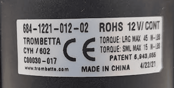

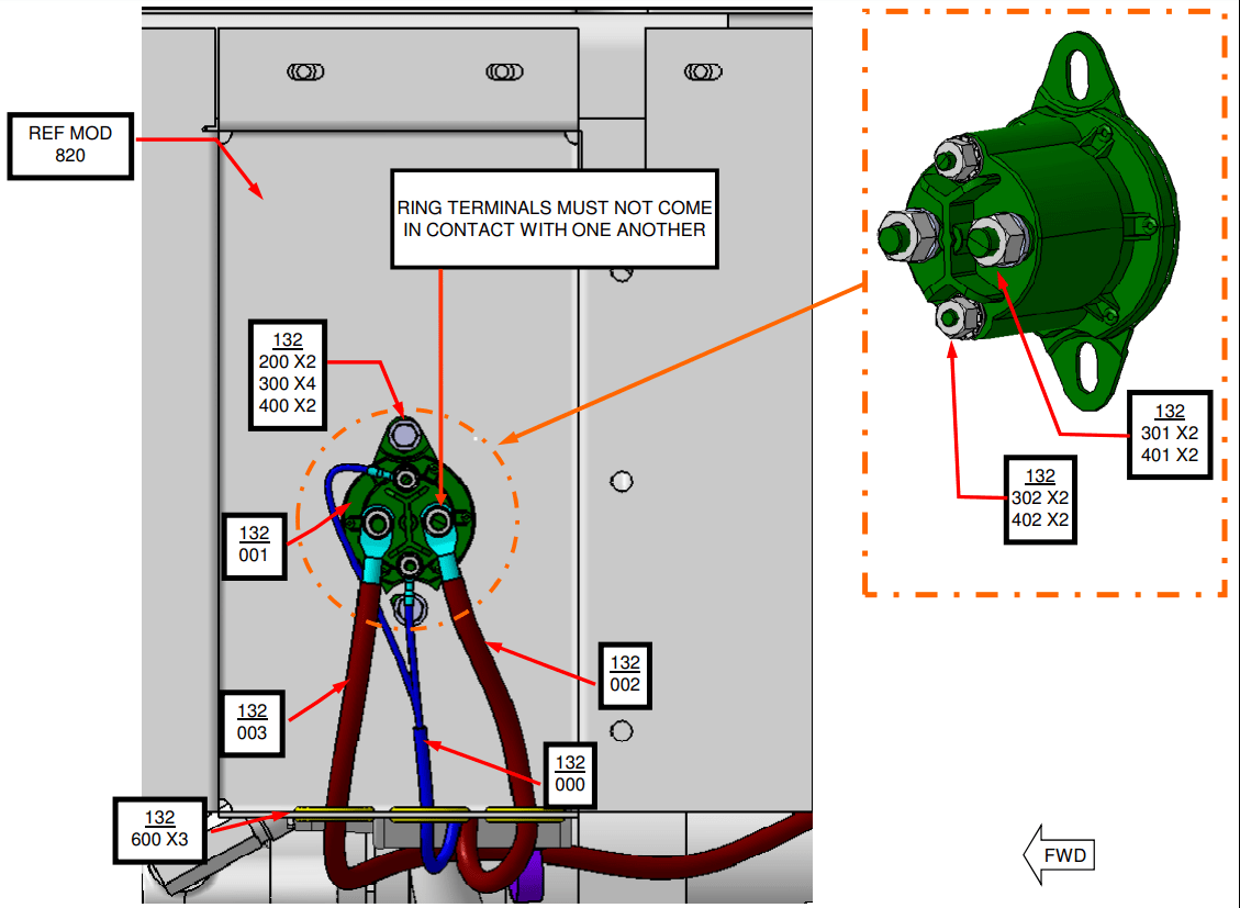

I'll say it again, with many hundreds of thousands of miles on over 600 6.7 powered school buses with the same grid heater, we've not had one do what the Rams have done. The buses have a different relay.

Big Papa, any chance the bus relay (that looks suspiciously like a solenoid) works on the RAM???
Whether or not it would work on a Ram, I don't know.
