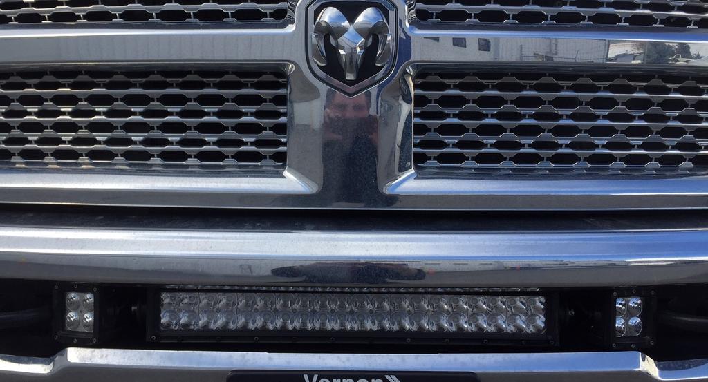

I've taken my lighting to a new level with the addition of a light bar and flood cubes.
I've added a 20" 120w BrightSource all spot LED Light Bar as well as a set of Aurora 3" 40w LED Flood Cubes.
I've added a trigger wire from my brights and I'm just in the process of adding an "on-off-on" switch so I can have the LED's come on with my brights and go off with the auto-dimming feature my Laramie has. With this switch, I can also turn the LED's off completely, or have the advantage of turning them on separate of the truck lights.
I've angled the flood cubes towards the sides to fully light up the ditches so I can see brainless 4 legged animals coming from my peripheral.
The Light Bar is 10,800 Lumins and the Flood Cubes are rated at 3200 Lumins each.
That's a total of 17,200 Lumins of light coming from my bumper alone.
*I can honestly say I can count the hairs on a deer's arse at 5280 ft.
Dog, good to see you back on here. *I would like to have my fog lights stay on with my brights. *That would be plenty of me. *I have mentioned this before, the location of your lights are blocking air flow. *Will it hurt anything? *Who knows.
Nice integrated system, much better IMHO than some of the ones stuck to the top of the cab.
