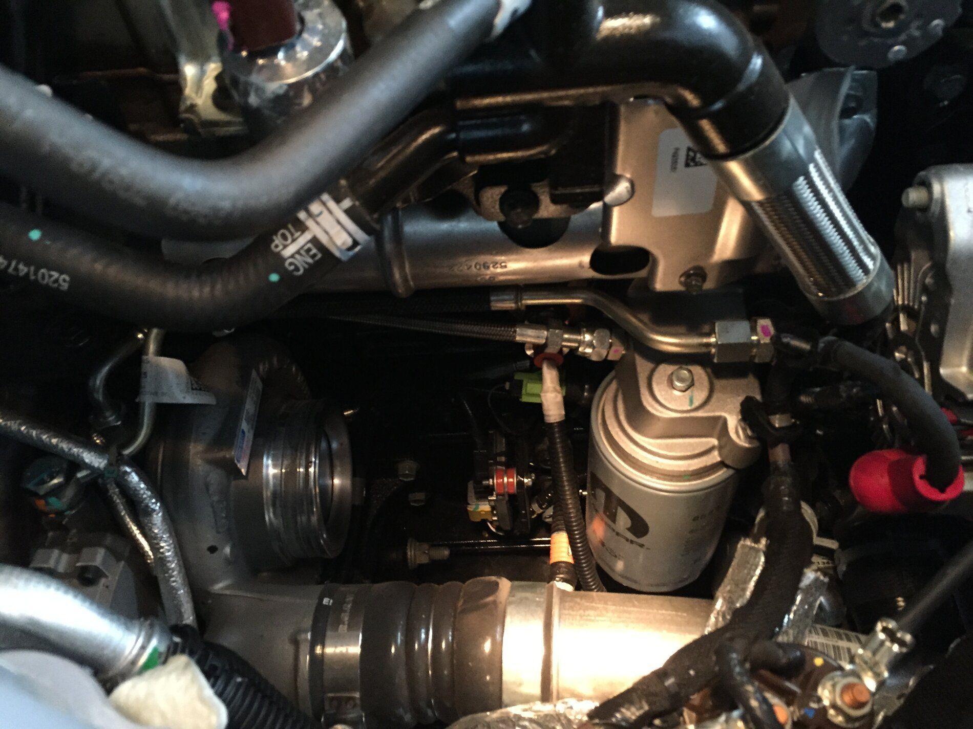

Yes you can do that. You could even put a small valve there permanently.

Change the oil yourself, with oil you bought, and keep the same oil for a few changes.
See what happens, but likely nothing is wrong.
