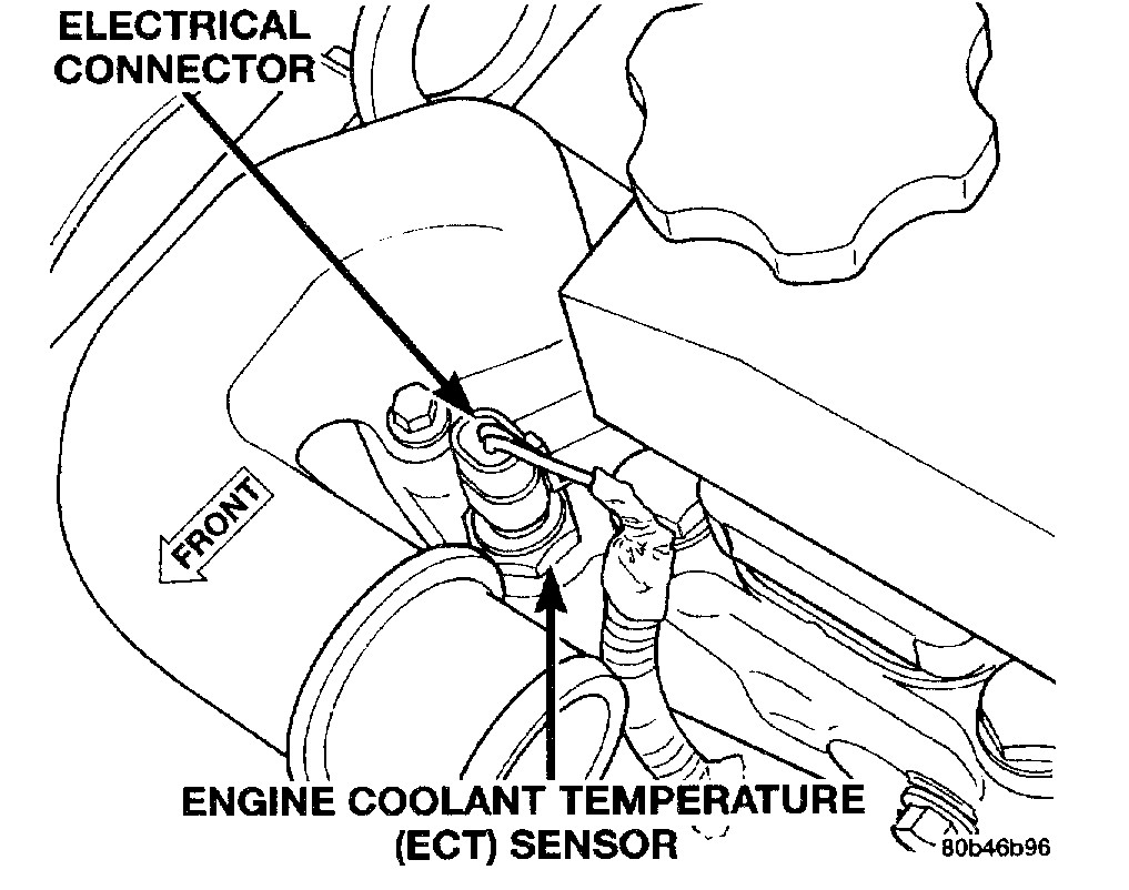

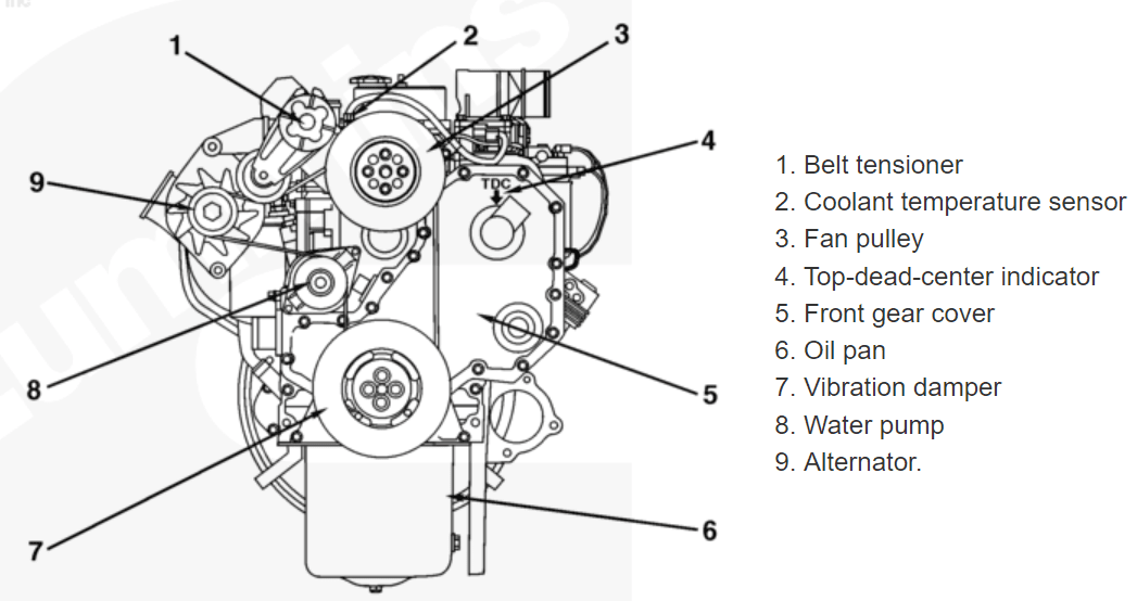

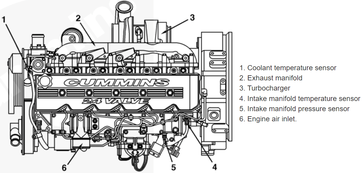

Just a thought, there isn't anything vacuum related on the engine were it could be leaking to cause it to high idle? Only other thing could be broken wire or corrosion causing signals to not get to where they need to go. If it was parked for a bit, might vermin caused some damage somewhere? From the diagram that I posted, could be coolant sensor as what @BigPapa posted, that's a cause for high idle. Just on the fence and throwing ideas to check. @garylmoore, Good luck with the gremlins and be careful with the built in "cruise control" with the high idle.
Yeah, I have decided to look at that coolant sensor connection, my buddy also suggested mice. I was told the sensor was located on the rear of the head, drivers side I think, that was on a gen 1 truck though. Others were located on the thermostat housing next to the alternator (that may have been gas engines, the article did not specify gas or diesel). Some with 1 sensor some with 2. I will see if I can find the sensor. Thanks.

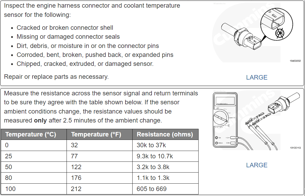

I'm going out now to check on the coolant temperature switch. I will check resistance cold then warm it up and check it hot.

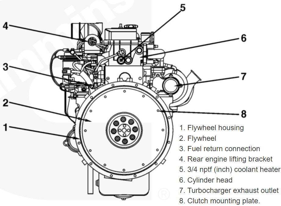

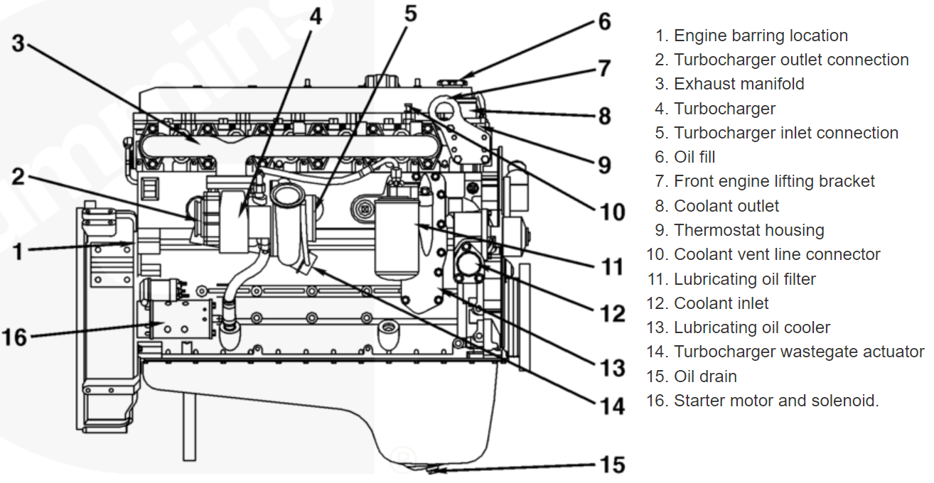

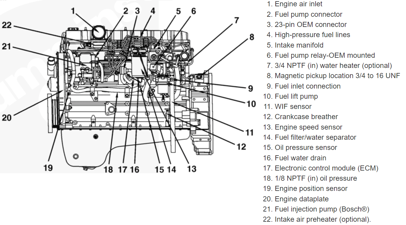

These diagrams are from the Cummins Service Manual for a 2001 School Bus, but should be basically the same as your '01 Ram, at least as far as Sensor locations. Obviously, things like the Tensioner, Fan Pulley, Oil Pan, and Exhaust Manifold are different.
I'm trying to find test specs or a procedure. Striking out so far.....
I checked resistance on the sensor and it would show a reading then blink out, this continued even after removal.

I bought it, replaced it, the new sensor was running 14.6 resistance. This did not change the fast idle.

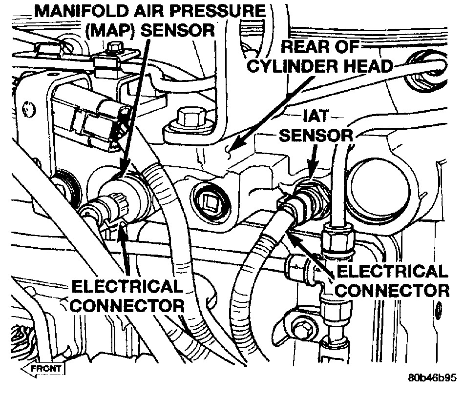

One was for an IAT sensor fault and the other indicated that the wastegate was stuck closed. The third was supposedly a companion code. Sorry I missed the numbers, but the guy was talking quick because he had to get back to work.
When he first hooked up the scanner, he also told me that with the key on, and a fully warmed engine, that scanner showed the grid heater on, and the IAT was reading 146 degrees.

I think if it were me, I’d replace that IAT. I may have one and don’t mind looking, but I wouldn’t be able to get it to you through normal channels till next week.
