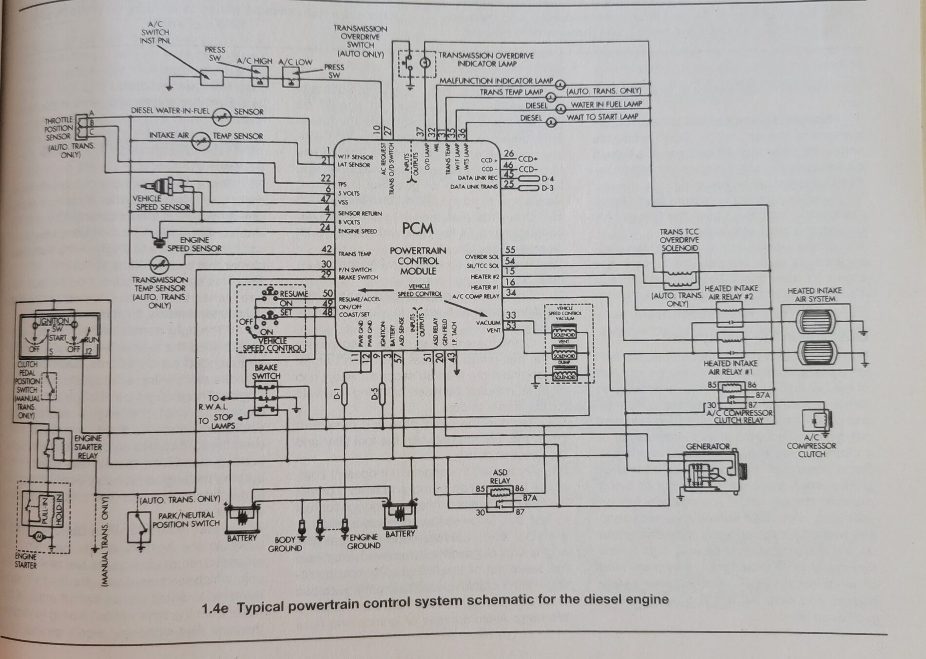

There is a second connector on the alternator.
If this line carries a signal to or from the ECM, it is possible the green and blue wire at that connector is at fault. I have a manual on cd, but it is at the moving destination along with my computer and most of my other belongings.

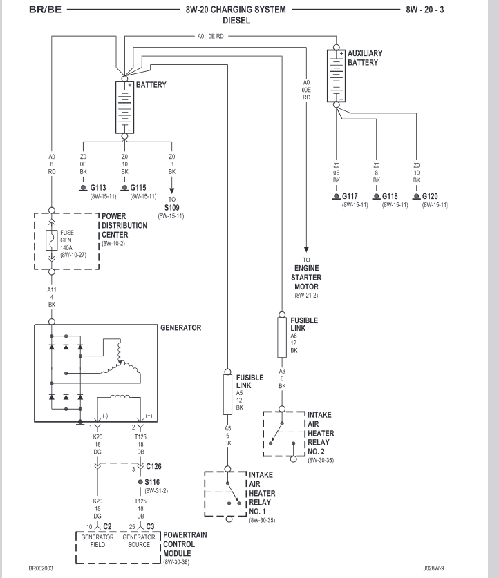

@garylmoore, Here's a diagram that might help, it's from a Haynes manual.

The alternator ALWAYS charges when the engine is running. It is the PCM (not ECM) that controls alternator output by regulating the field current from the alternator. The battery sensor under the driver side battery provides an input to the voltage regulator part of the PCM. The PCM will set an approximate maximum voltage of around 13.5 volts on a 100°F day and an approximate maximum voltage of around 14.2 on a 40°F day.
I believe you live in Illinois. At this time of year you should be seeing an engine running voltage of around 14 volts at each battery.
Note in the photo below that the dark blue field wire is the source voltage (12 volts) from the PCM to the alternator. The dark green field wire is the field ground from the alternator that is controlled by the PCM. You can check the dark blue wire for 12 volts while the engine is running. If it is not present, there will be no output from the alternator.
Make sure the 140 amp fuse in power distribution compartment is not blown.

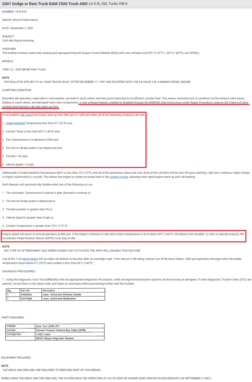

I found this, mentions idle speed. It tells you what conditions cause the idle to increase from 800rpm to 1200rpm.

So. That is a relief. If I have to drive with the high idle I will.
