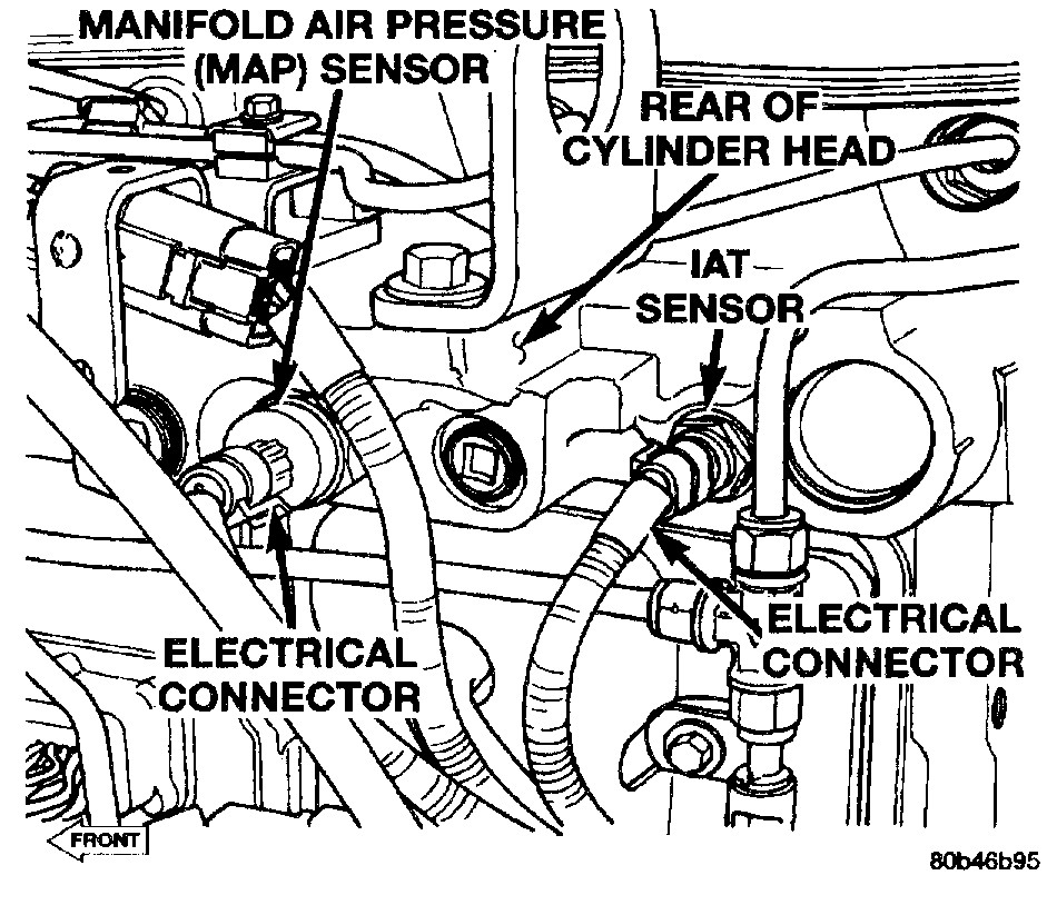

I did, change the IAT sensor and since it was easily accessible, I changed the MAP sensor. It changed nothing. Yes, I realize, being a parts changer, a part cannon mechanic, is not the way to do things, but this was my last Harrah.
