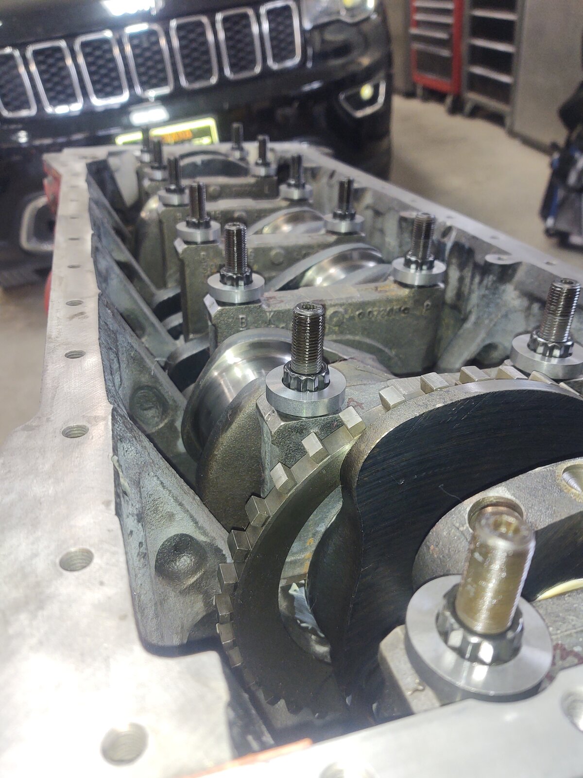

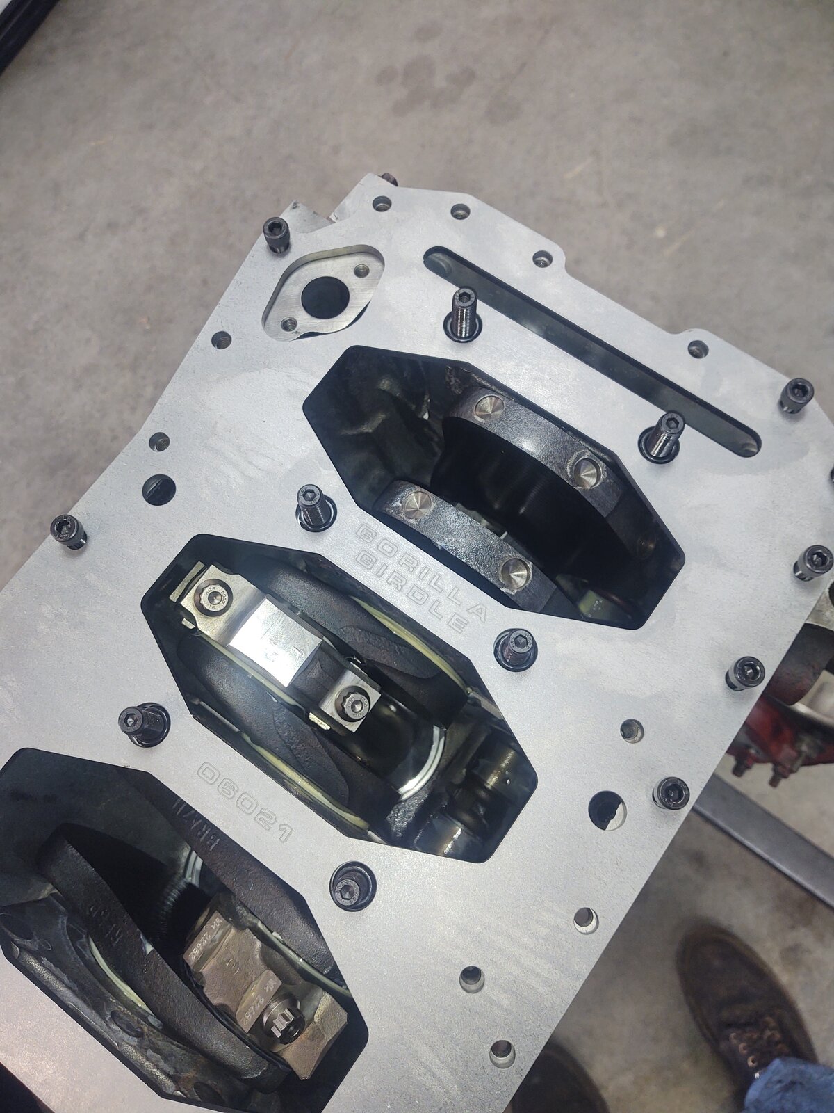

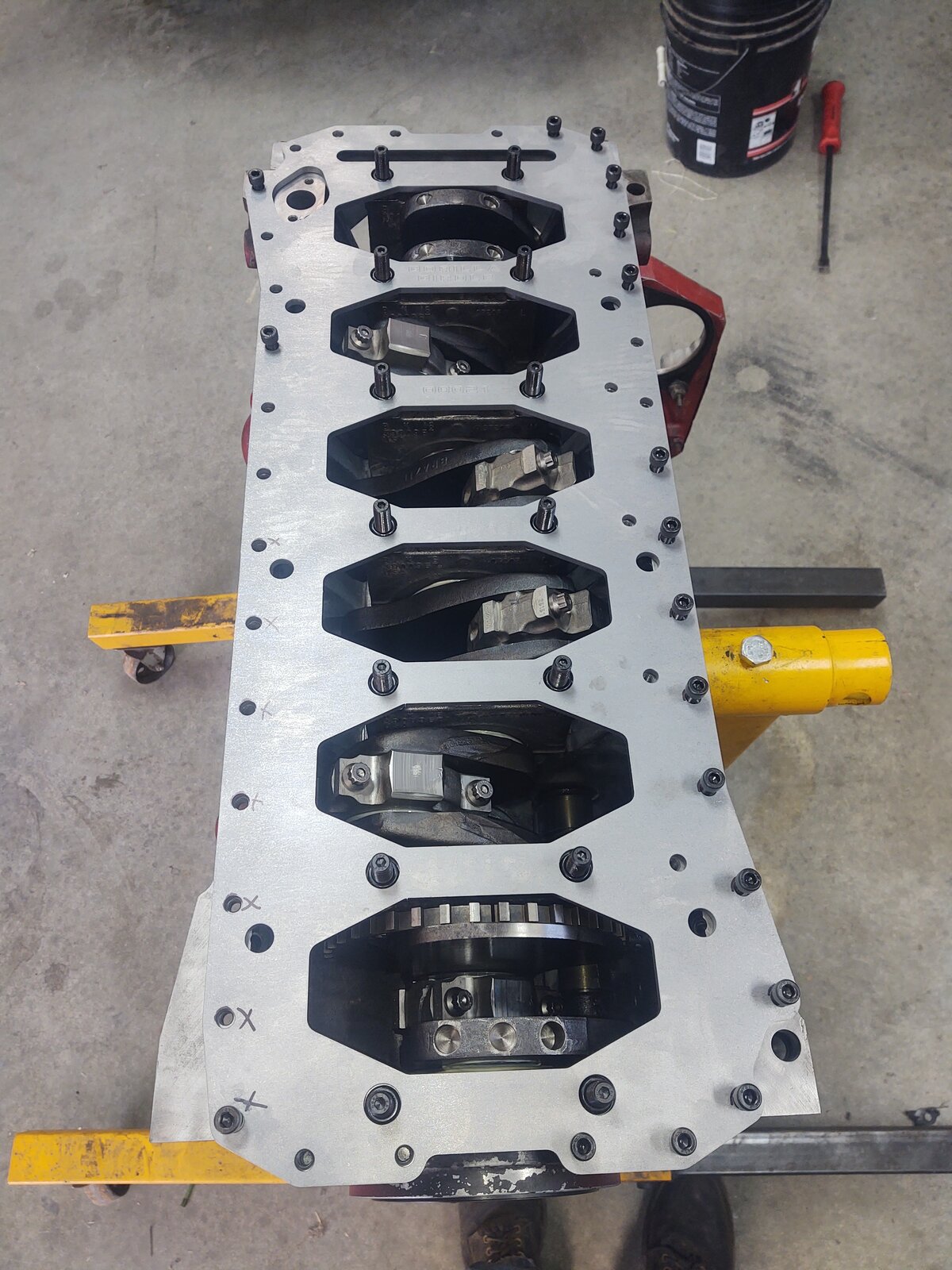

Since the cry babies are rambling on I'll post this. This is a industrial Injection gorilla girdle 12mm. Came with all hardware, studs, nuts, washers, spacers clean Fit. For those who don't know, 03- to present common rails are girdled factory. Fit really good besides rounding some holes for oil pan bolts. Nothing on crank caps needed it just a few oil pan bolts did. Not a big deal to me. Think about it, you torquing your crank bearings cap studs to 150+ lbs or so, not gonna affect oil pan bolts 12" away and it's billet aluminum. Also did big iron stamped oil pan fits perfect.Wasn't supposed to come off that way. Was supposed to be, "let's show what vp can do".
