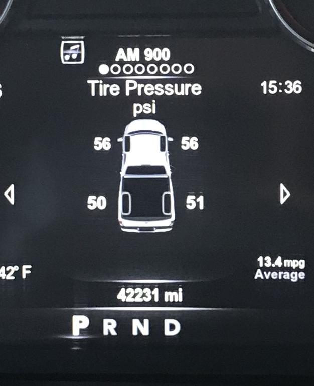

OK, so I dropped the pressure on all 4 to 55 Lbs to see how it rode and to see how annoying the light is... Ride is much better although it still oscillates up and down on the freeway.
A small piece of blue painters tape took care of the light and a quick push on the steering wheel controls turns off the pressure icon.. I think I'll live with that for a while before I give a dealer my cash..
