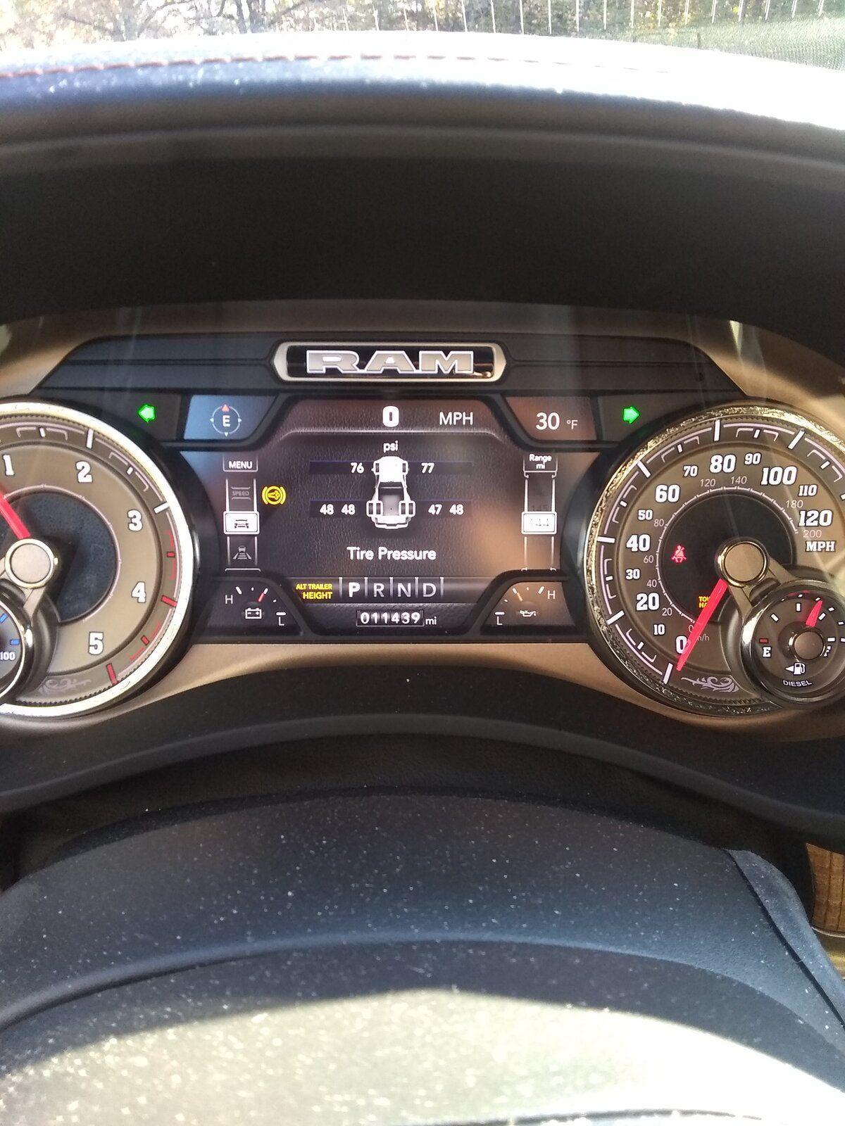

I can't believe it we woke up today and it was 26 degrees and I've had the tires set at 55 PSI the other day and they went down 7 PSI here's a picture guys it's 30 degrees right now.

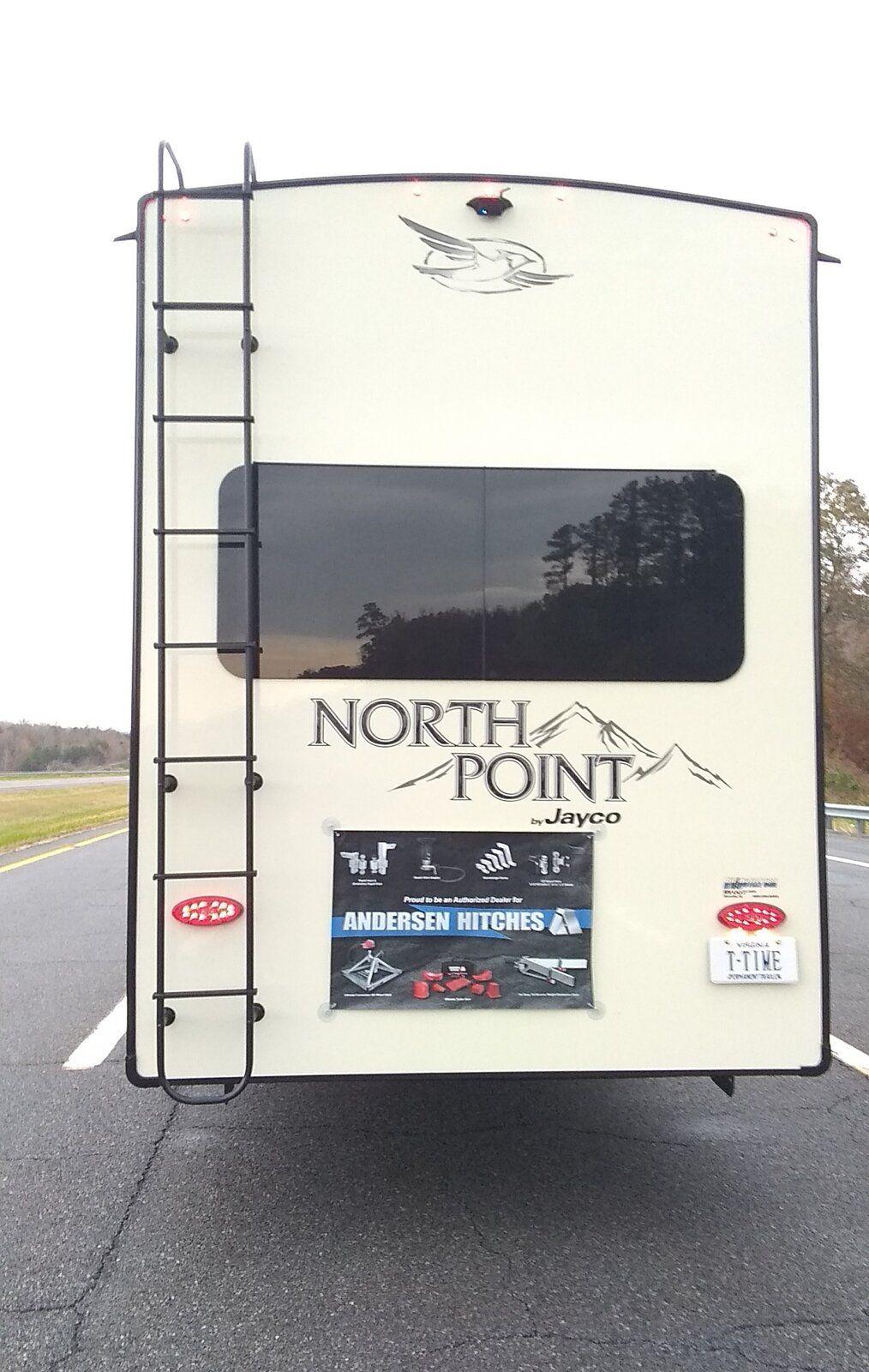

I have a little issue guys a red alert red alert red alert it's going to be 20 degrees tonight here in Danville Virginia and the RV is not winterized however it will be like 45 tomorrow you know tomorrow morning sometime but the it's going to be pretty cold now I believe I may be able to bring the RV to a place 40 miles away and leave it with the heat on and everything you know connected to the power and everything leave the heat on will that prevent it from freezing up all right I don't know about the stuff guys I need your help thanks I was going south within a couple of days but to Florida but still have to get a couple of teeth taken out and don't feel like driving 250 miles after I get two teeth taken out all right.

Jayco lists the RV as having "Climate Shield™ : Enclosed, insulated, heated underbelly; Hight-BTU output furnace (40,000-BTU); Astro-Foil™ in roof and floors"
Leave the heat at 45° or higher and don't lose any sleep over it.
