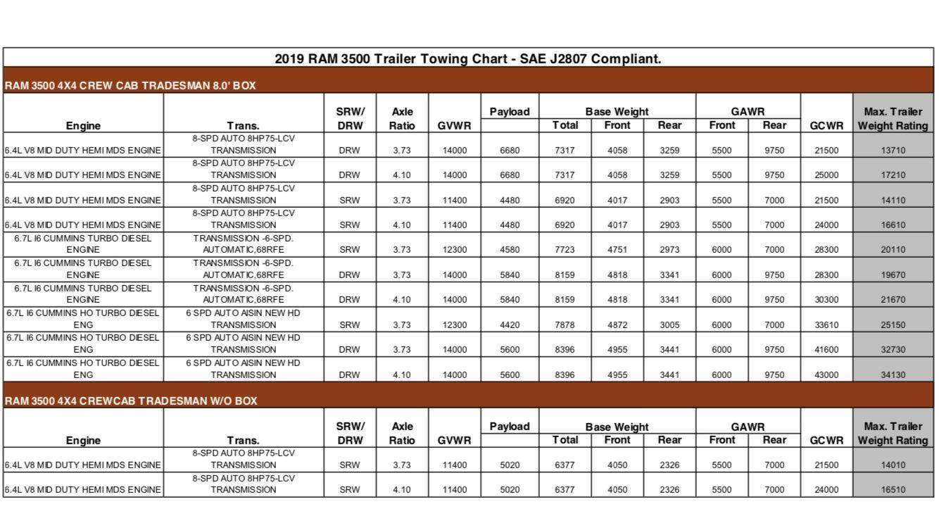

For confirmation look no further than MY19 SRW gear ratios.
I looked but can not find anything in writing regarding 2019 3500 specs that talks about gear ratios. Can you post a link to the info you have?
This is the chart the "I" care about.
Looks like 3500 SRW trucks will have ONE gear choice, 3.73.
Looks like DRW's will have two, 3.73 and 4.10. Looks like I will be getting 4.10's again.

View attachment 111641 This is the chart the "I" care about.
"FULL IMAGE" for your viewing pleasure!
Looks like the confirmation of the above axle ratios for the 2019 MY confirms my suspicion....RAM listened to all of the complaints regarding the crappy “3.42 only” axle ratio of the SRW trucks and did the right thing.....they axed them.
And all this time only a minuscule few continue to believe that 3.42’s rule and 3.73’s were “compromise” gears. :D
RIP, 3.42 ratio. It’s been way overdue. :D
If buying a 2020 I would have put my money where my mouth is and bought 3.42's even tho I tow 35k combined.
