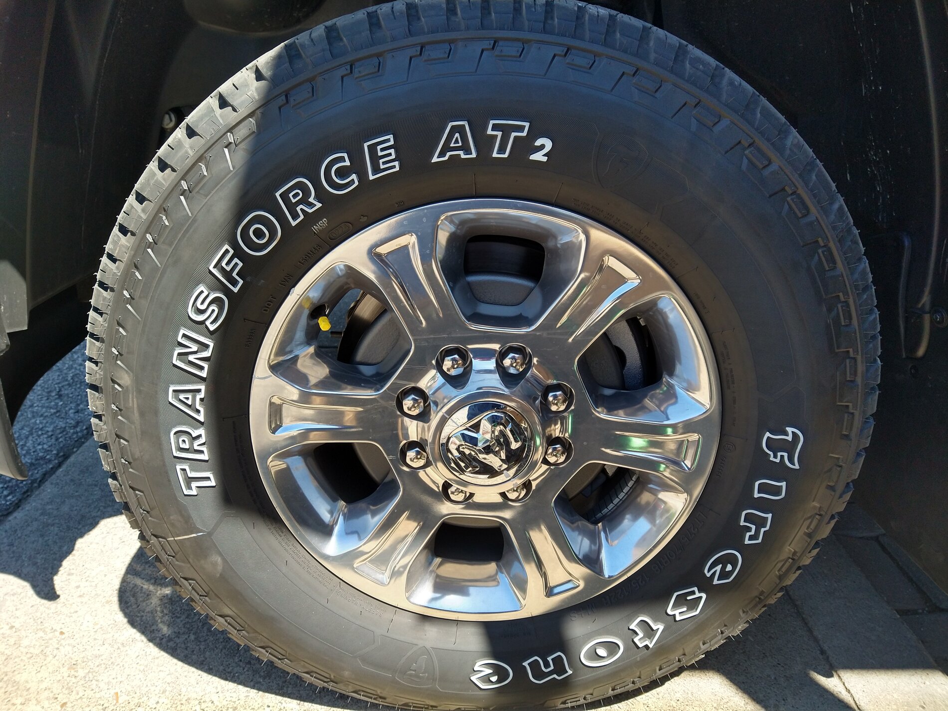

Front mud flaps and Centramatics done... The Centramatics can be seen a little more with this style 0f wheel. I gave them a coat of Rust-Oleum flat hammer black. We will see how the paint holds up with the brake heat.. Coming up next rear Centramatics, Sumo Springs and B&W 5th wheel hitch install.

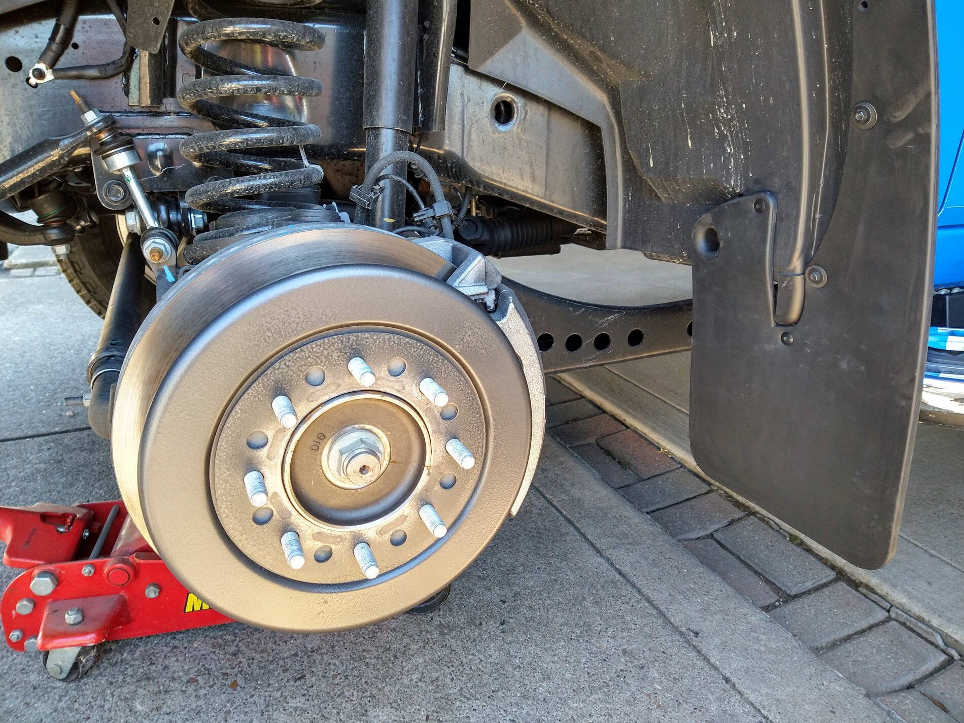

Did you source replacement push nuts for the rotors or simply delete them? I have not found any online yet and have not installed mine yet. I wanted to run my new tires a few miles first to see how / what vibration is there and the difference after.
Funny you asked that. I did the right side first and had the tire back on with a couple lug nuts threaded on. Then remembered there where 4 push nuts on the studs. I took the tire back off along with the Centramatics and took them off. It may be in the instructions to do that. But since they came off my 18 I had no instructions. I'm thinking those are used doing Factory assembly when building the axles so the rotors don't fall off. Thinking the calibers may be put on else where that would hold the rotors on. With that being said I backed them off enough to get a screw driver behind them bending them out and took my side cutters and cut them off.
