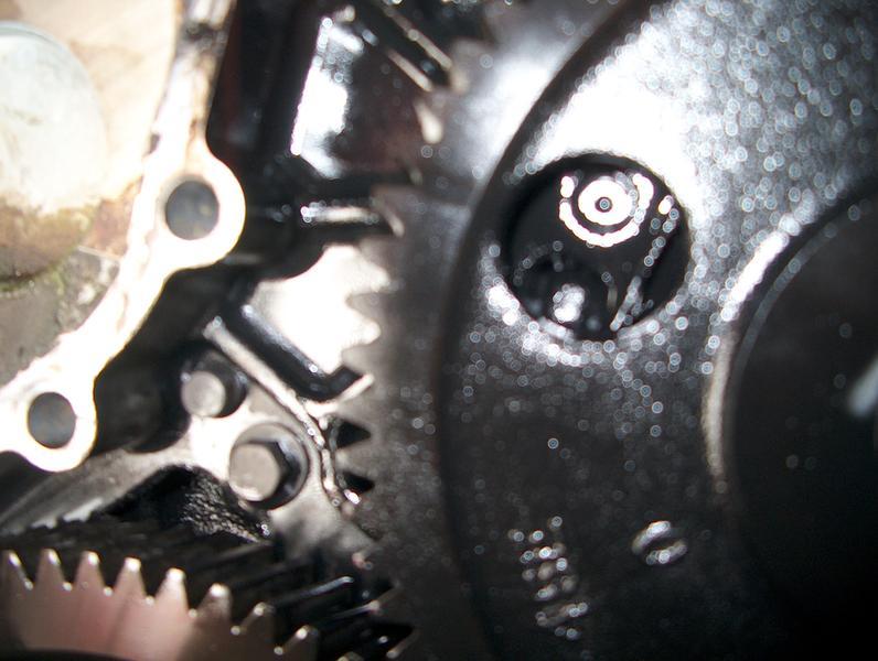

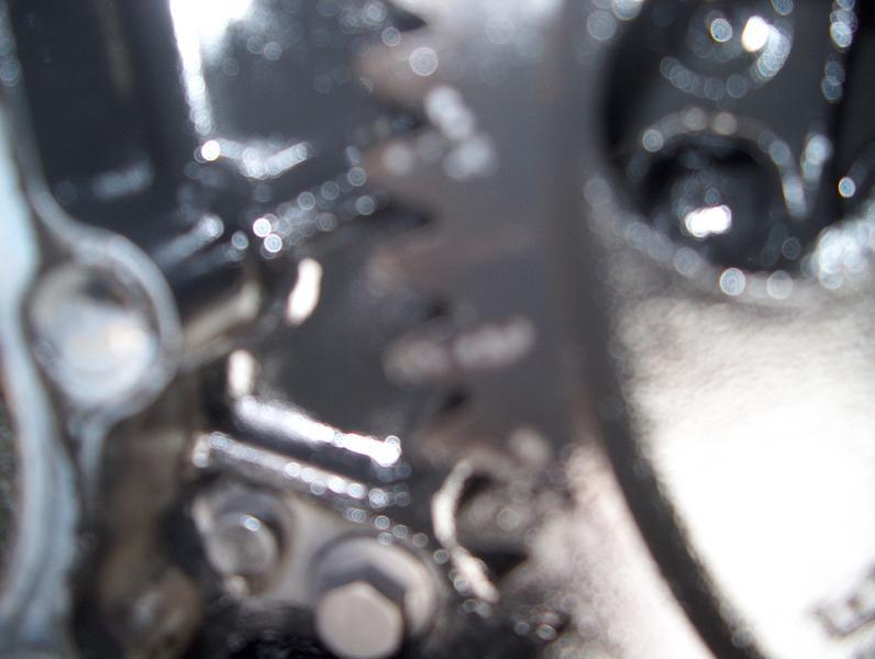

I just finished tabbing the pin on a 96 w/207kmi. some people think if it's gone 200k it aint gonna fall out. here is a pic of what I saw when I removed the gear cover.

the pin was so loose I'm surprized I made in my shop.I pulled it out w/ a magnet. so far I have checked 18 98.5- to 02's and just three of them had old style cases. those three were all 98.5's. three out of the 18 were 02's
Its pretty important that the pin is in place, to help keep alignment of the gear case where it should be. Just ping it in place and tab it. make your own tab from a fender washer like the original tabs were done. not much cost involved, just the labor to do so.

Never thought about this electical ring, but everybody here has used something a little more substantial. A 1/4 fender washer just needs to be drilled out a little for the bolt, and then shaped to fit the space. From the center of the hole you need 1 1/4" length (at least) to cover the pin, and then shape the rear to bourder the bolt head. We also used a bolt a little longer, recommended by Joe Donnelly.
As mentioned above by Joe D, make sure you check the bolts in there, They can cause the same problem. 18' llbs of tourqe, not much but clean and use thread locker on the bolts that can be removed.
