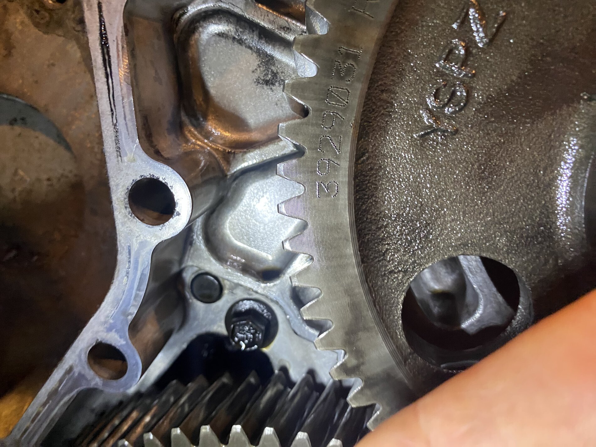

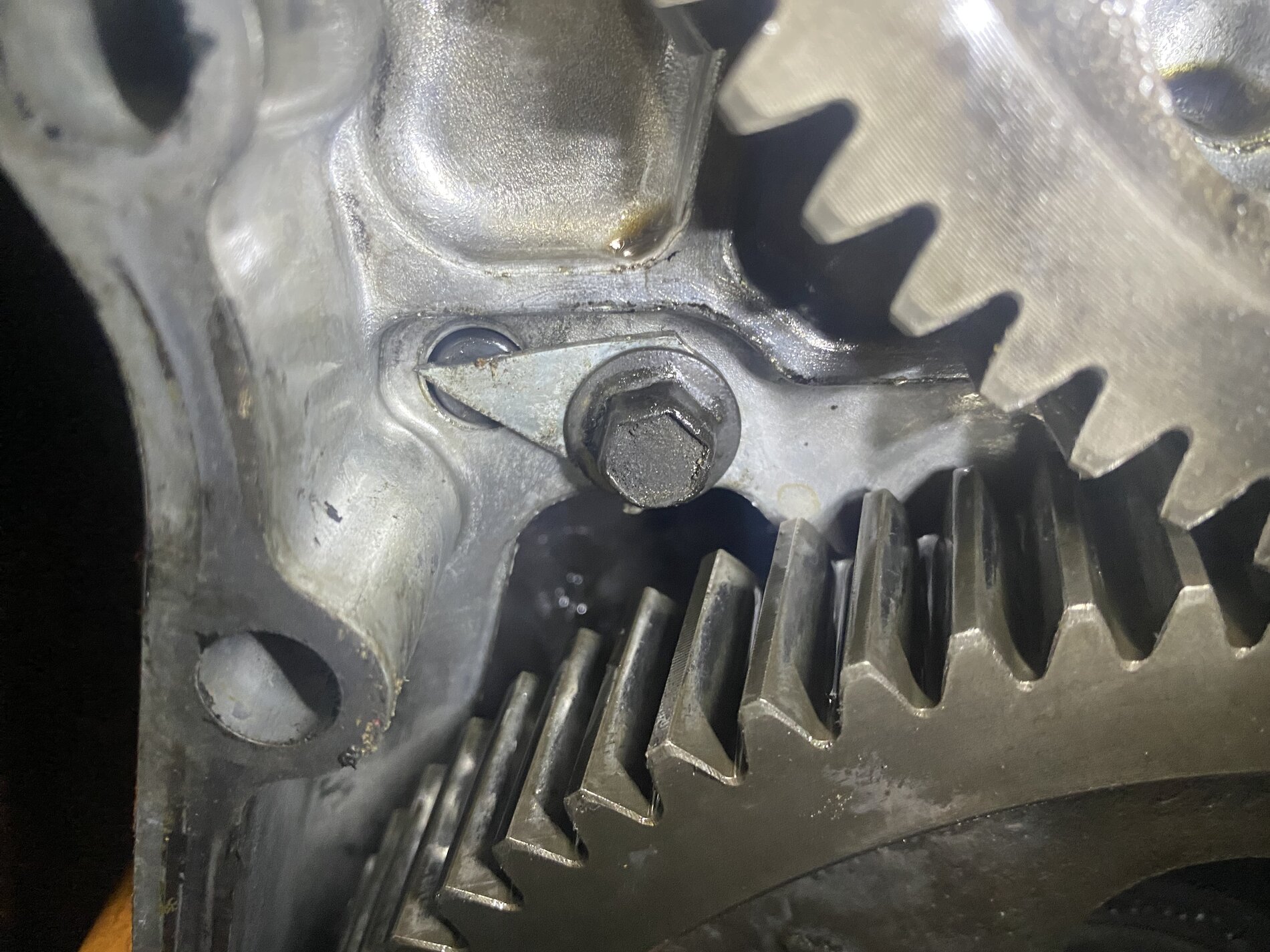

Got it opened up and the pin looks snug… maybe I will use the bottom of the beer can or even crack open a bottle and use the cap.
I would use a tab thicker and stronger than a piece of beer can. Use a longer bolt if needed.
Of the 5 bolts, you can get on 4 directly and remove them. The fifth is hidden behind the cam gear and not in line with one of the windows, so I just tighten it with a bent open end 10 mm wrench.
Thanks for the tip. I was figuring it was going to be a labyrinth.
A fully seated tab isn’t flush with the case like yours, usually they are about 1/16”-1/8” in. I’d tap that back into place and use a recommended material as a tab.
I will say, just looking at the head in the pic, it doesn't look like you cleaned it off very well. As Gary mentioned, the bolts are at least if not more of a danger than the dowel pin. It is absolutely necessary to clean the threads on the bolt and in the hole and put Loctite on them.
I used brake clean and rinsed the holes out a few times. Some of the residue in the photo is from rinsing the holes after I put the bolt back in. I did use blue loctite after cleaning the bolts too. The bolt adjacent to the dowel was quite tight. The ones one the cover were varied in their tightness. Thanks for taking note.
