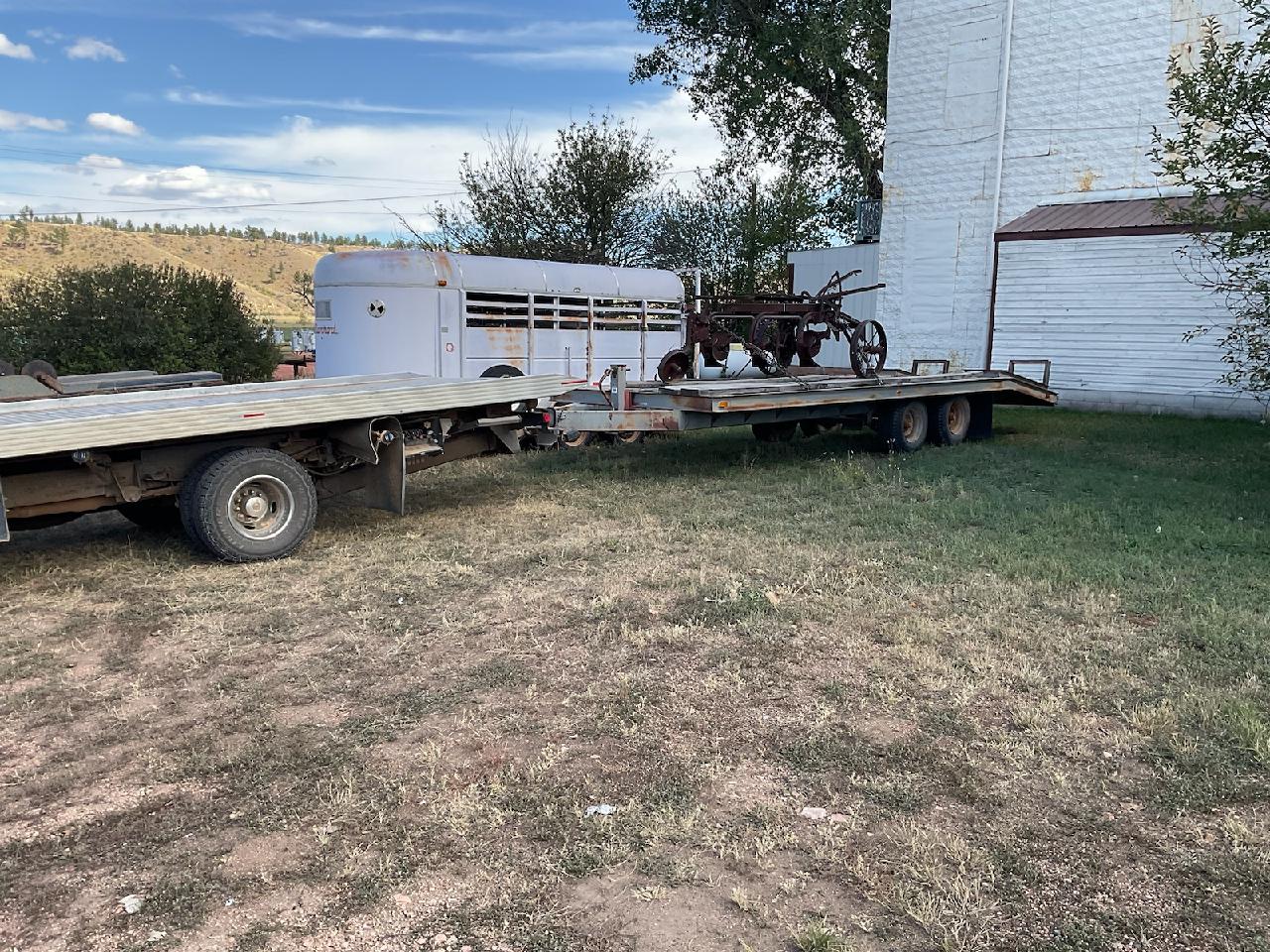

One load removed, one to go. He yarded 2 of the garden tractors into the stock trailer with a small, portable, drill driven winch.

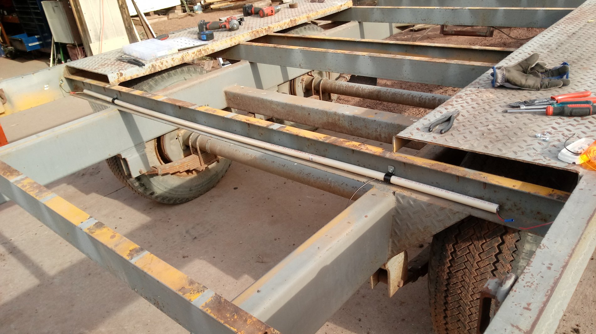

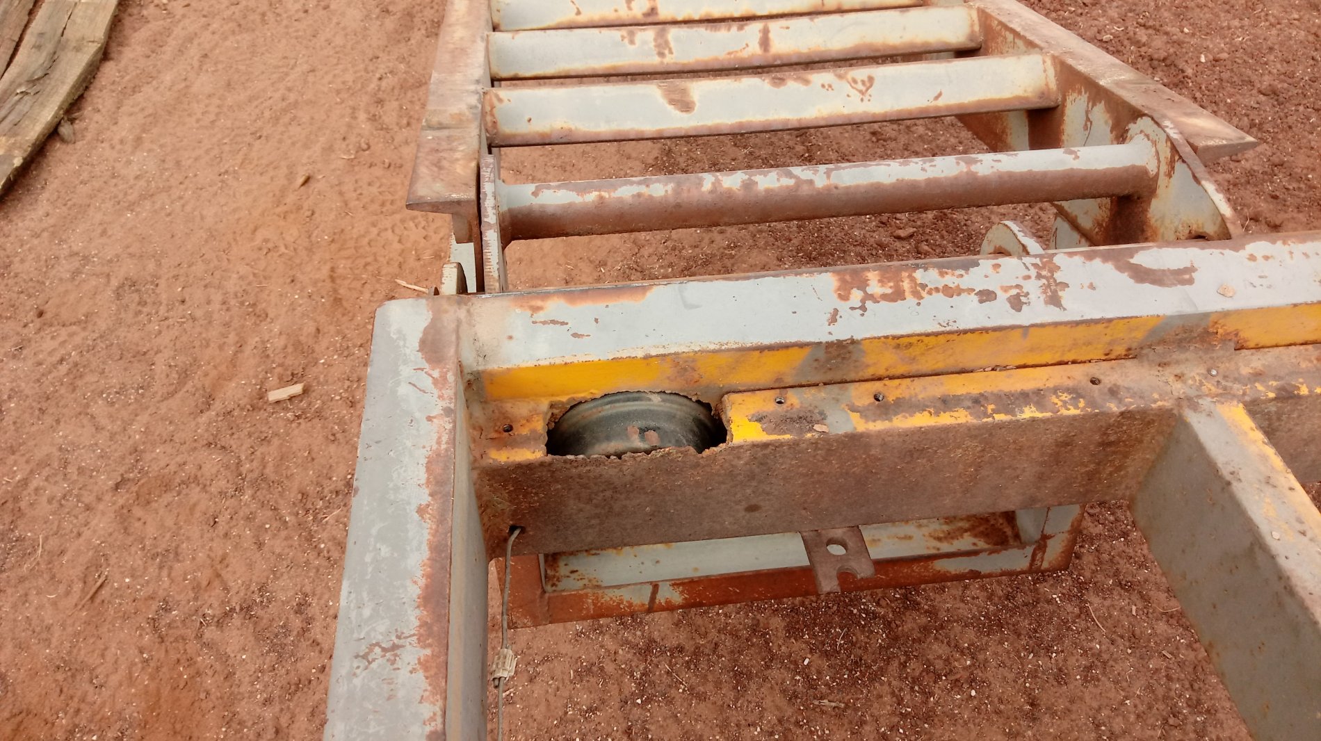

Those little 8.00x16.5, 2k rated, 28" tires gotta go, no ground clearance or load rating. The plan is to swap the RV tires (6 bolt), wheels and hubs with the stock trailer (8 bolt), they both have 6k axles.
